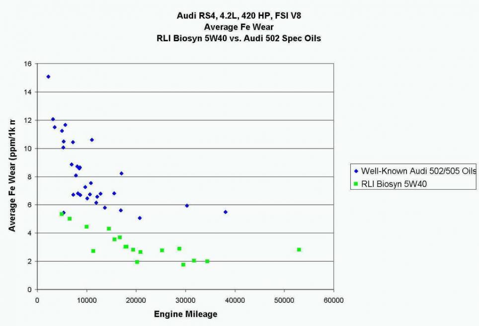

    • It that graph from Bob the oil guy forum? I have near all my oil tests. I'd like to add mine.
