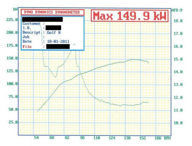

    Well for starters, I see the liberty was dyno'ed in 3rd gear. This gives an inflated number. On a five speed box, a legit dyno run is done in 4th gear.
    On a six speed either 4th or fifth.
    Lower gears (1,2,3) give false/optimistic power figures. So a legit 150kw's will feel faster cause it is.
      Mine was run in 4th but doesn't matter. As long as they use the same one next time the difference will be consistent.

        • Originally posted by dave_r View Post
          Bingo. Im just talking about peak figures.
          If you just want to compare whats going on on your own set up, your right, just use the same gear and for comparisons you'll be fine.
          But they wont be accurate overall figures for other people to quote, and wont help indicate anything about track performance.
          Some shifty performance shops use the lower gear/higher power "technique" to down talk other tuners or make themselves look like "hot" stuff. They have been doing it for years.

            Different dyno, different day, different atmospheric conditions, then they're not "comparable" anyway. So what's the diff
              wow those afr's are all over the place

              • you should always try to dyno a car in the gear that is closest to 1:1 ratio which is 4th gear on an R in both the DSG & Manual.
                • Originally posted by Corey_R View Post
                  Exactly what GUY just wrote, the diff should be 1:1

                    • Originally posted by Guy_H View Post
                      That's what mine was done in, verified it yesterday with the operator. Going back next week for a follow up run. Need to remember to ask them to print up graphs with different stuff as I'm sure the original runs are stored with all the other data.
