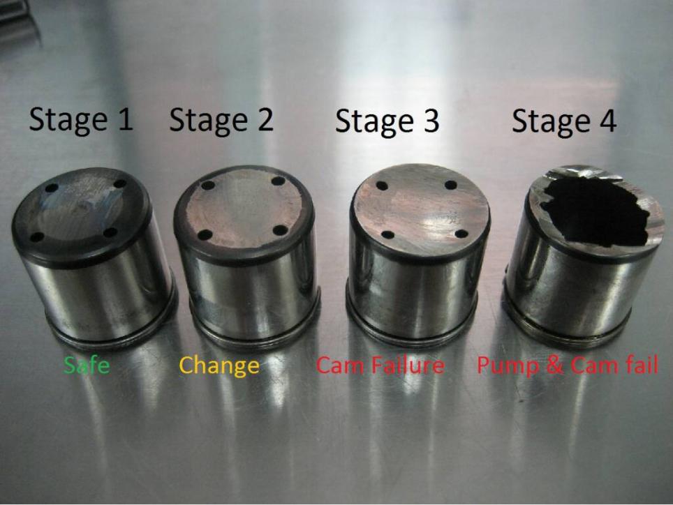

That follower is pretty worn, you replaced it at the prefect time. As soon as the black casing is worn through, the wear is exponential I've been told. Are you tuned? Either way. Great to replace
I just did mine about 2 weeks ago and it was similar to yours after 10,000kms (Stage 2++ k04)
Car is stockOriginally posted by kozij View PostThat follower is pretty worn, you replaced it at the prefect time. As soon as the black casing is worn through, the wear is exponential I've been told. Are you tuned? Either way. Great to replace
I thought it looked fine. Did not change it. Figured it looked like stage 1 in pic below.
I'll pick one up and change it, cheap enough at $30 anyway.

If you have the revised HPFP it should last longer than 50k. Mine was rebuilt and the newer HPFP was put in. Its done 30k already and no wear what so ever and its tuned.Originally posted by JustCruisn View PostCar is stock
I thought it looked fine.Did not change it. Figured it looked like stage 1 in pic below.
