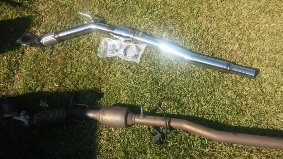

I installed my new downpipe today.
Just a cheap ebay unit with 100cel cat.
Thanks Lucas for the gasket and Brian (car_nut) for the o2 spacer, timing on both of these was great.
Install took way longer than expected at 3hrs. Spent about 40min just on turbo bolts.

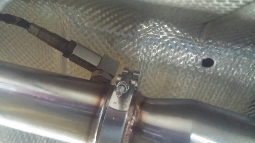

I wonder if the spacer on S2 has caused it to not detect any gas so the diff from S1 to S2 is out of range.
I cleared and will see how it goes. Will remove spacer if it keeps coming back.
