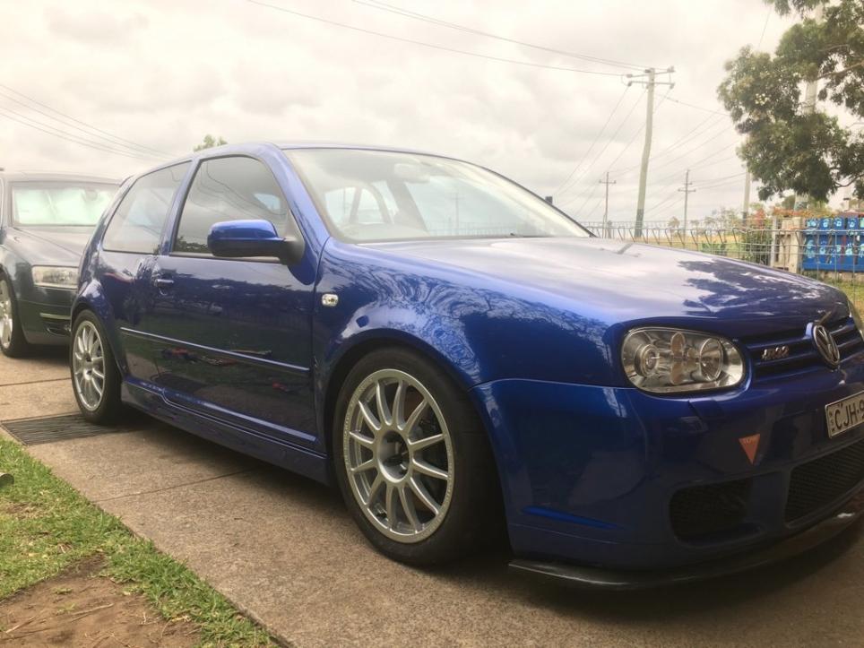

                  • So I pulled out the height adjustment plates or whatever you want to call them, lowered the rear by the expected ~30mm, annoyingly lost all preload. That’s why I put them all in now from memory.
                    Anywho, lowered the front to match and tightened up the strut tops with no weight on them.
                    Would be nice a touch lower, but I’ll be happy with this.

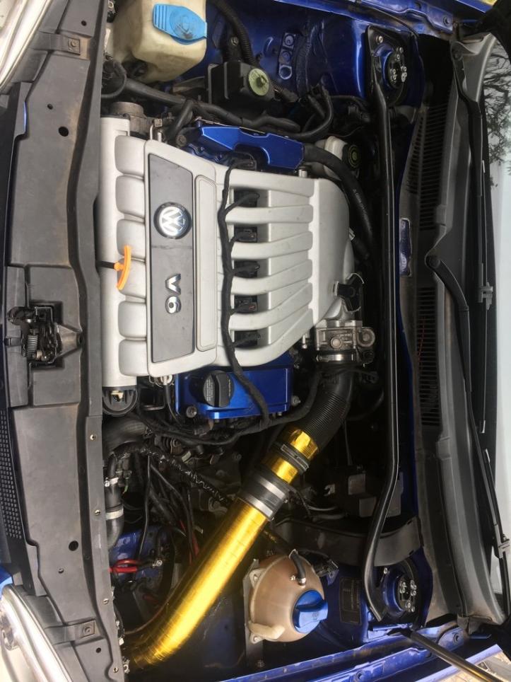

                    Also, picture of the engine bay now. Wrapped the loom in cloth tape, and a few touches of heat management for ultimate race car points.
