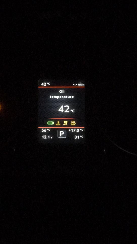

    Been told to check for knock detection.
    But I have no ideas personally, tried to make it happen 4 times on the drive home and it did it once going into 5th..

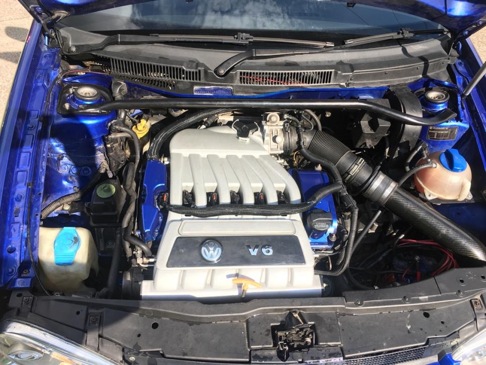

            With the VW Nationals Supersprint next weekend I finally got around to fitting some hopefully preventative explosion pieces.
            First off was fitting a MK5 baffled sump and oil pump. Oil pump due to shallower MK5 sump. With the baffled sump I also gained the level and temp sensor, which with some wiring I can view on the colourMFA display
            Next was changing out the oem 120a alternator for a 90a unit from a 4 cylinder MK4 and lightweight pulley I had from my old 12v VR6.
            I swapped alternators in an effort to get some weight off the nose of this thing, switching alternators saved 1.9KG

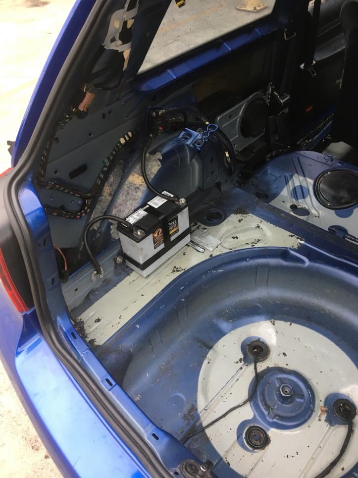

            I also got a smaller battery and moved it into the back of the car. The battery and new bracket was only slightly lighter, around 6KG, but I mostly did this for the same reason as above, to get some weight off the nose. The battery and mount that was on the car weighed in at 16kg, new setup is roughly 9-10kg including the additional wiring required. Totalling 18KG off the front, should have a noticeable improvement!

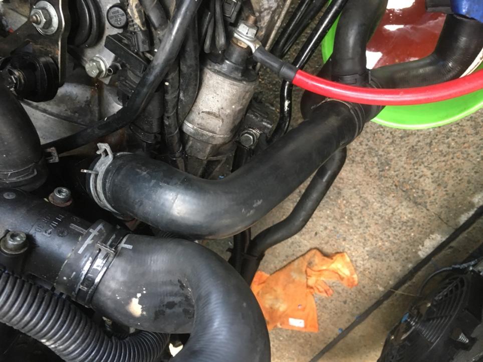

            With the front end off to change alternators, I took the opportunity to change intake manifolds, finally getting rid of the badly black painted one. This snowballed a bit and with the manifold off I finally got rid of the mess of hoses hidden on top of the hot exhaust manifolds.
            The above was all able to be removed by simply moving the coolant ball to the passenger side of the bay. 2 new hoses, extend the 2 coolant level sensor wires and a bracket was all that was needed.
            I also used a MK3 1.8L hose to remove the ‘T’ piece that had been blocked off for the aux radiator. Aim of all of this was just to eliminate all of the potential leak joints.

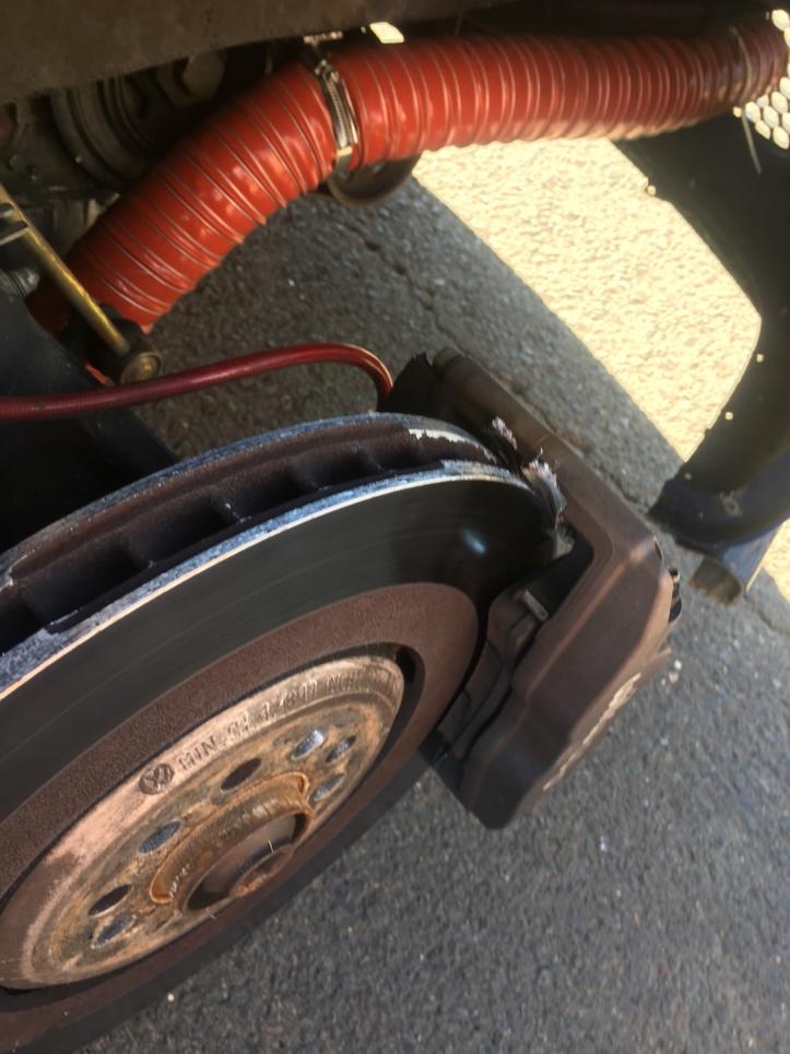

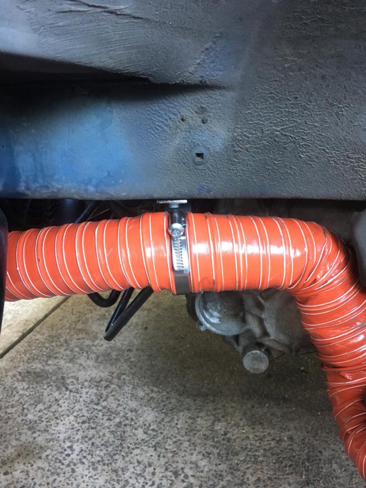

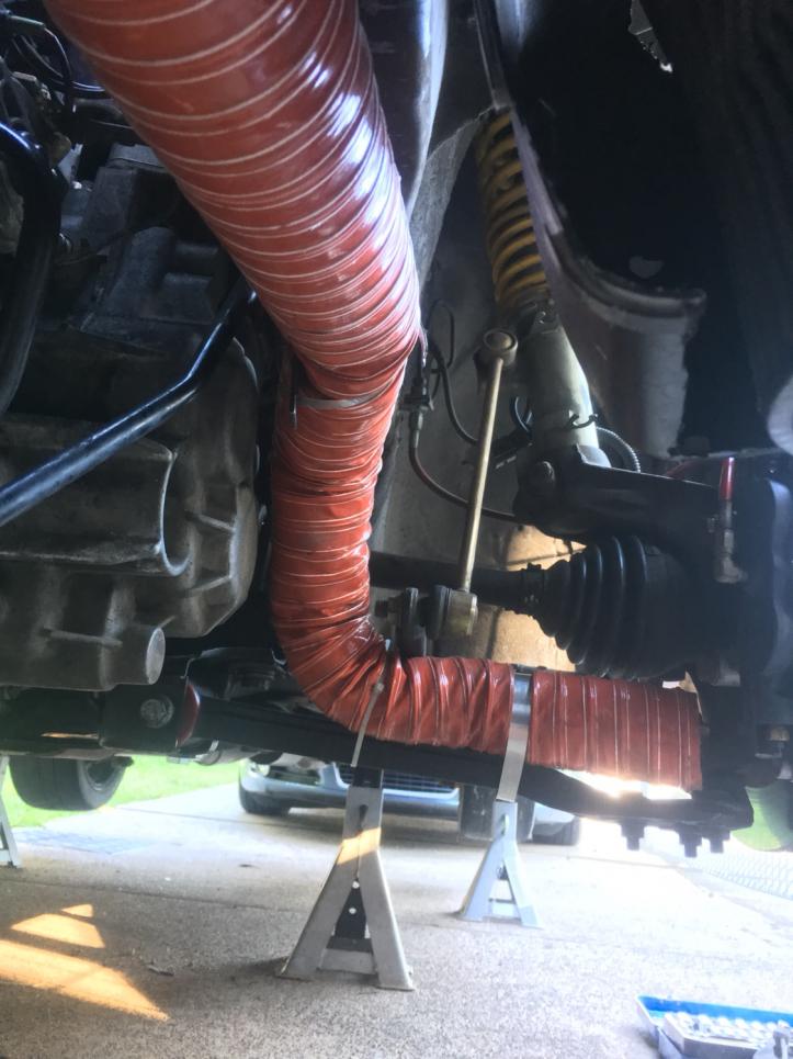

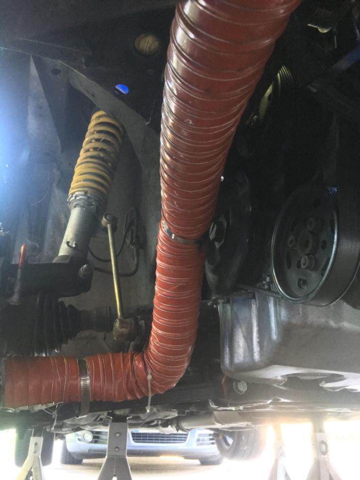

            After the last track day, I knew that the cooling of the brakes was a serious issue that needed to be addressed. I started with some plans to modify the dust shields to fit a duct, but I eventually opted for their complete removal. In addition I fitted some brake ducts drawing air from the big R32 bumper vents.
            I made some ‘L’ brackets and nutserted the chassis legs to be able to bolt them securely in place, especially with how close everything in is, to crank pulley, driveshafts, end links and tyres.
            Now I’m still not 100% happy with how they are attached to the control arms, but it was the most sensible option I could think of. After a road test there are no issues with them moving or rubbing so for now they’ll stay as is.
            Sitting 50mm back from either brake disc a quick test with the leaf blower showed good flow into the centre of the disc.

                  Keen to see if the brake ducts work. 18kg is a lot considering you haven't really taken any items or features away.
                  Road test shows not as effective as I thought, but slow speed and heavy braking isn’t the best test scenario.
                  Yeah exactly right. I’ve maintained the factory fuse box that sits on top of the battery as well, just used a stud terminal to join the battery in the back to it and the starter.
                  With all the accessories on, wipers, lights, radio and fans voltage drop was minimal.

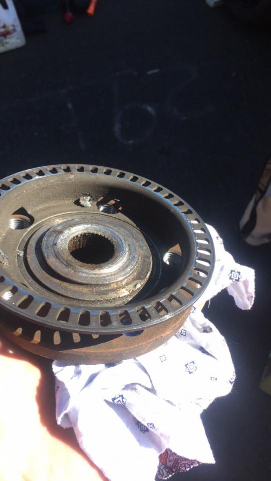

                        Car got real lose and all over the track. Pulled off and seen smoke coming from the back wheel, tyre looked flat at the time (must have parked on a rock in the grass or something) so not ideal, but not the worst outcome.
                        Start driving off to the pits and there’s some loud grinding noises and no brakes. Well that’s not a tyre issue, get back to the pits, notice the caliper has taken a fair hit from the rotor.

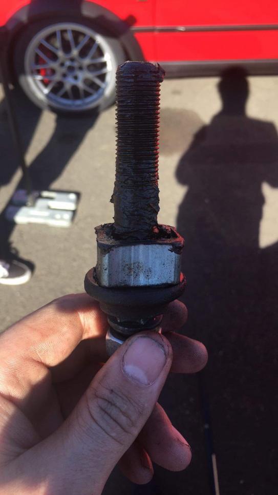

                        Started pulling bits off to investigate and all things started pointing to loosened driveshaft bolt or collapsed bearing.
                        Pulled out the driveshaft bolt and found this dodgy spacer
                        Spot the issue
                        Something even more unbelievable, sheared/snapped the snout off the hub.
                        Turns out, dodgy as previous owner. Cheaped out and replaced the hub with a non R32 item. Which relies on the the driveshaft spline supporting the inside of the snout. Because he didn’t swap the outer cv to the nut style the hub was unsupported and eventually sheared under load.

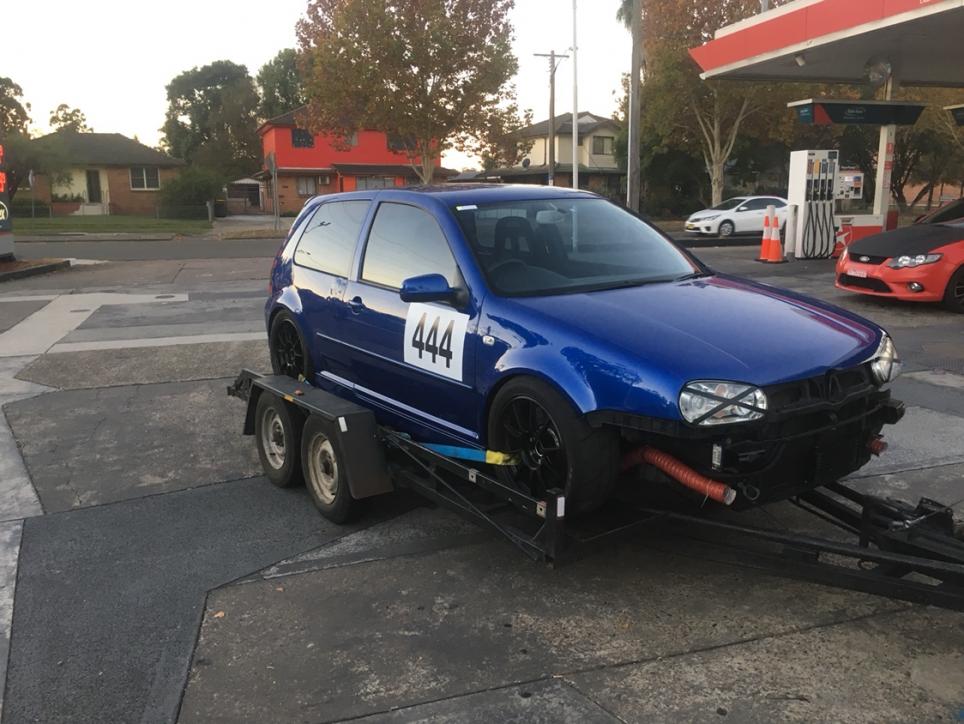

                        Thanks to Trickysimon being a good bloke for once in his life, swapped his and Zalemate’s car’s around on the trailers and towed the R32 back up to Newcastle that night. Back down for a quick sleep and off to the show on Sunday!

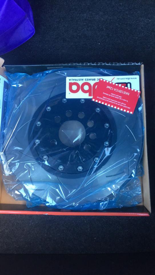

                          So grabbed some 17z calipers, braided lines, EBC blue stuff pads and because they were on sale DBA two piece rotors

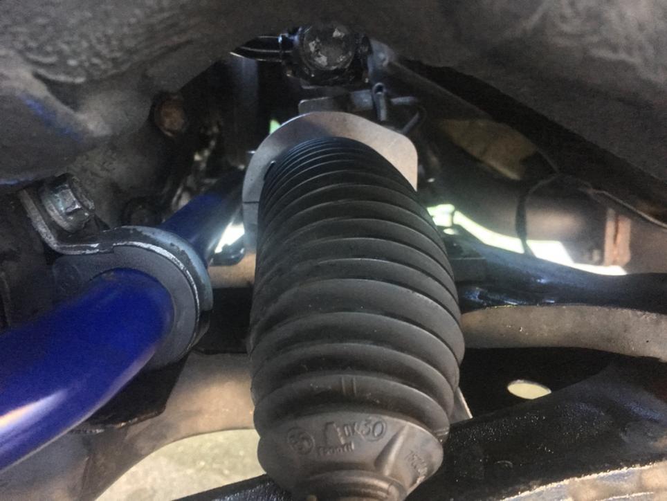

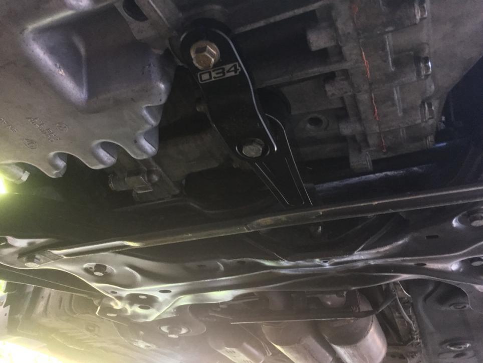

                            Front subframe bushings, pressed in with the Milwaukee. Tyrolsport items should be good with how tight they are.
                            Tyrolsport solid steering rack bushing, these I assume are meant for RHD so the bracket for the power steering lines doesn’t work and needs to be cut off.

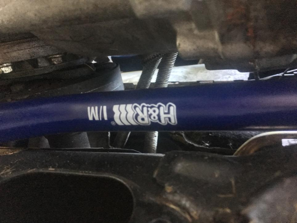

                            H&R front sway bar in
                            Not sure if I need to spend the cash on adjustable end links or not at this stage as one half of the joints are maxed out. But I intend to buy new coilovers so will probably just wait it out.

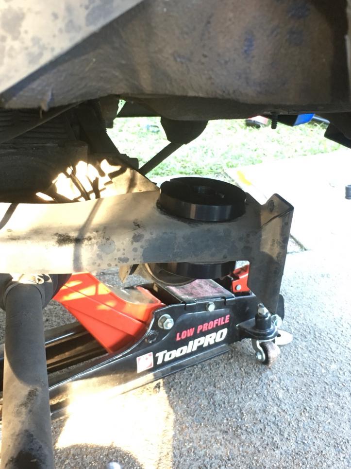

                            Onto the rear bushings, had to make up a tool to get the stock bushings out
                            Powered by the Milwaukee, made short work of them. Except for deforming the alloy pipe I used
                            And new solid ones Milwaukee’d in
                            Put the H&R sway bar in at this time as well but didn’t get a snap of it.
