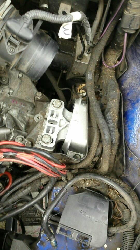

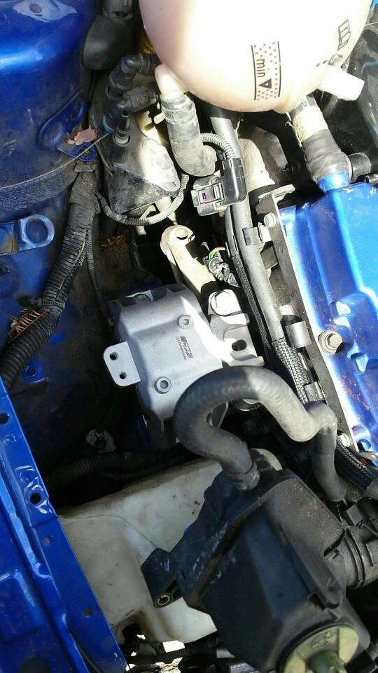

        So after many many many moons.
        Finally got CTS engine mounts.
        Quick hit down the street and no more driveshaft on subframe action!
        Hopefully the coupling didn't cop to much abuse. It's been sitting since Nationals waiting for the Engine Mounts, now we can have some fun.
        Although thermo fans are still broken and thermostat housing leaks..

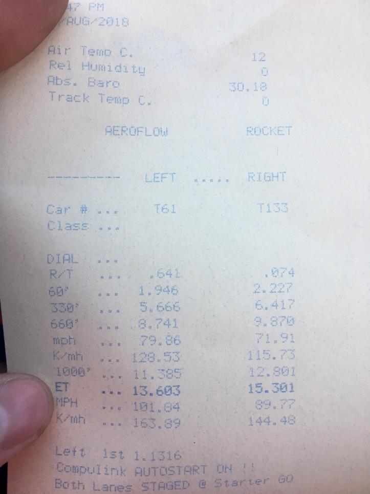

                    Been having clutch slip since before the track day, finally started happening in lower gears, (2nd/3rd) so got a new clutch kit and wavetrac LSD Installed while the box was out.
                    Went to the drags on Wednesday night. Only got 3 passes in, the drive down from Newcastle was the break in.
                    Managed a 13.655 @ 100 on the first pass, 2nd pass something happened with traction control and it caused the car to bog even though it was off.
                    Third pass bettered my first pass with a 13.603 @101.84
                    Still shifting slow to at least get to the other end knowing there would be so few attempts possible.

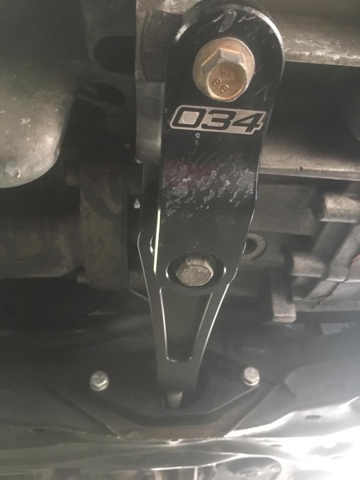

                      I also fitted a 034 billet dogbone Mount. Used dirty photo as I didn’t take any at the time!

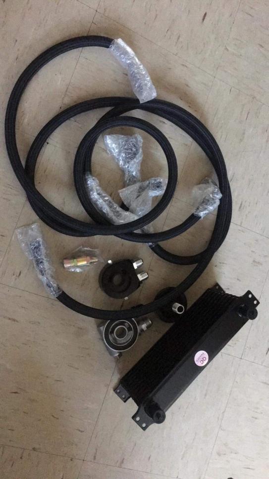

                      Starting with an external oil cooler. In the spirit of this thread, tried to do as cheaply as possible.
                      So I got myself a Mocal thermostatic sandwich plate (in hindsight pointless as it lets more oil pass through the cooler than it stops), and a random eBay cooler and hose kit.
                      I wanted to remove the factory exchanger, to do this without spending the extra money on the mocal cap, I cut down a standard oil cooler cap and carried the thread further up the rod.
                      I cut up an adapter fitting that come with the eBay kit to use as a sleeve inside the Mocal sandwich plate so that it wouldn’t be able to move around on the mating surfaces under pressure
                      I cut up the factory reo, this served two purposes, to make room for the hoses to go underneath it and the front bumper and to shed some more weight!
                      Kept it as I’ve ditched them before and the bonnet is a pain to close, so the factory mount is still used for the bonnet latch.
                      Instead of making a useless bracket (nowhere to mount to without having a large bulky bracket) I bolted the core straight to the factory radiator shroud, this wouldn’t be possible if the a/c condenser was still in place.

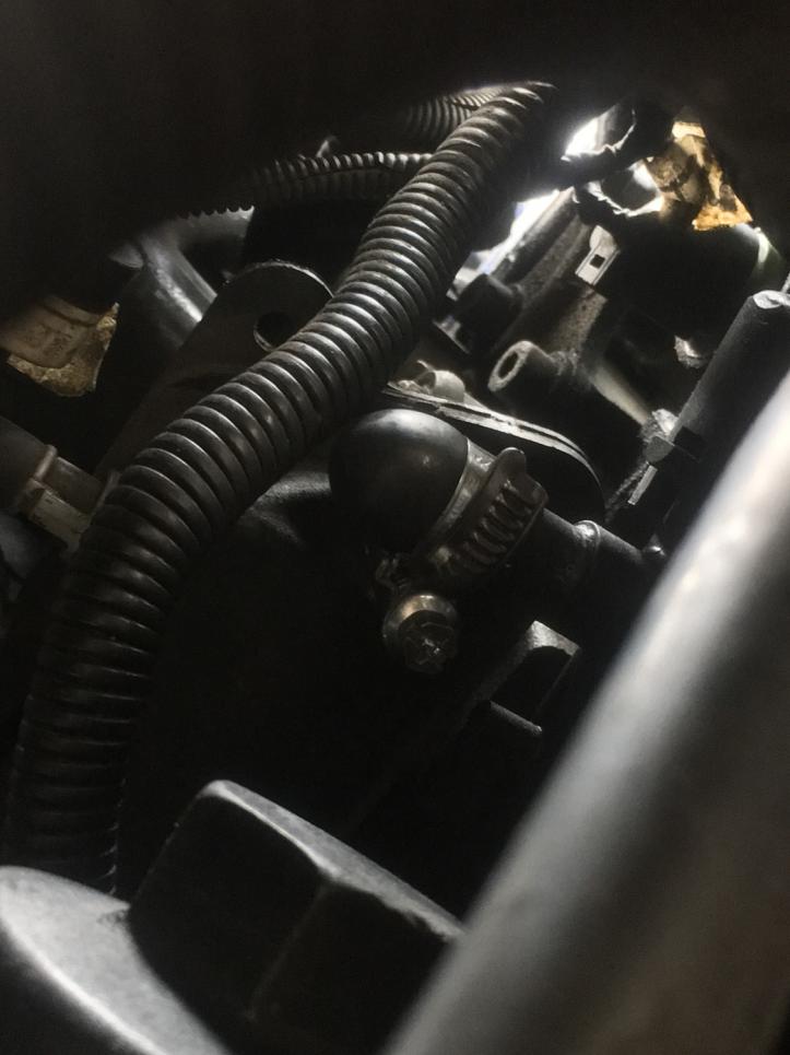

                      I just used water caps to block off the coolant ports left on the crack pipe and block

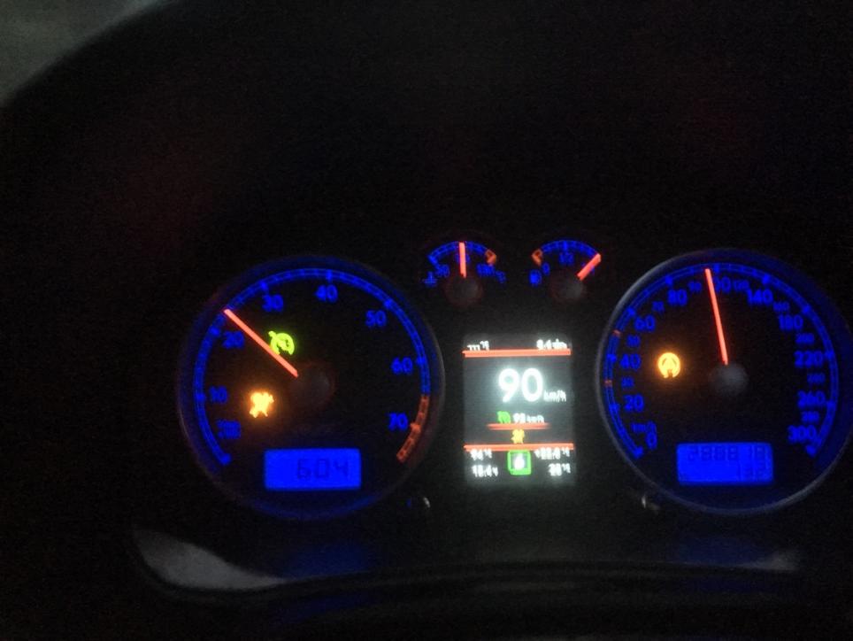

                      I also had Ian at FIS Cluster Care install a ColourMFA to replace the old hardly working display. (Sorry for the blurry pic!)
