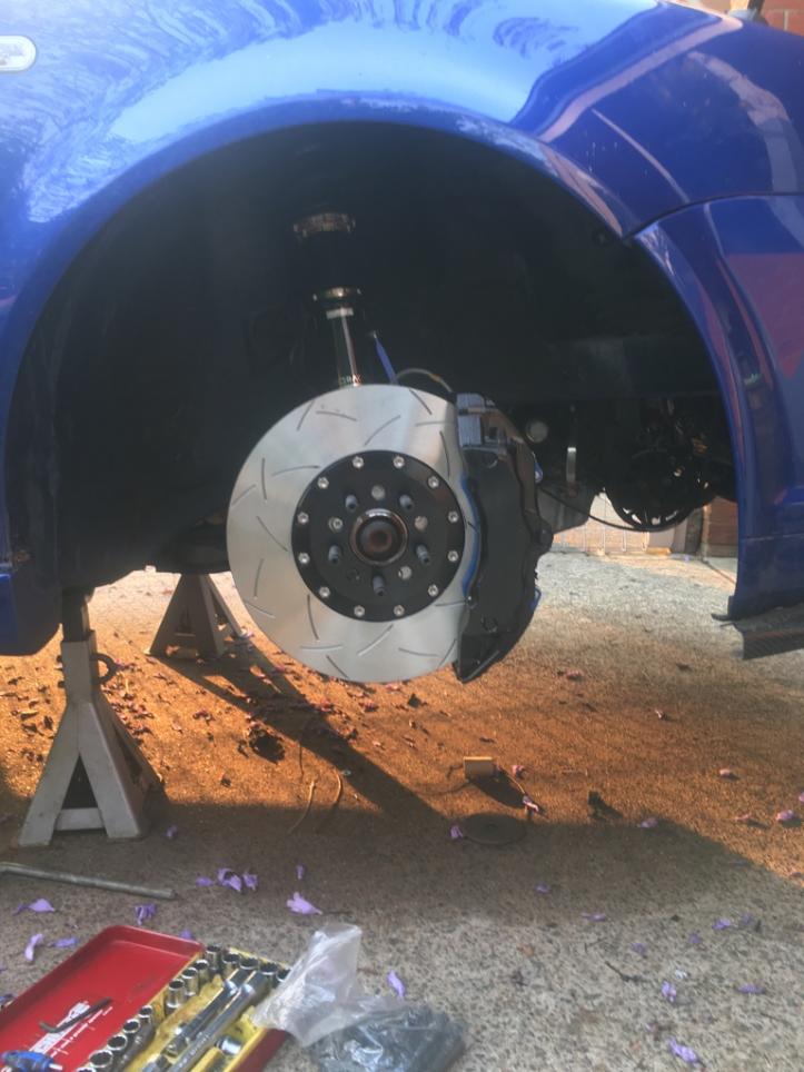

    • Getting closer to finishing the car so put the new discs on the front and cleaned up seam sealer.
      Reassembled the front end and bled the brakes. Having a few issues with one of the rear calipers. Hopefully get that sorted out sometime soon.

        • Are they 6 pot Brembos
              Correct. They are the 17z calipers, EBC bluestuff pads and DBA rotors

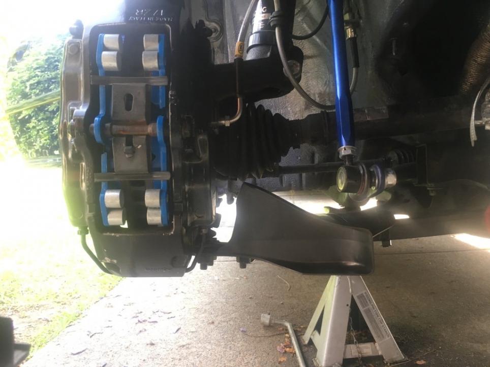

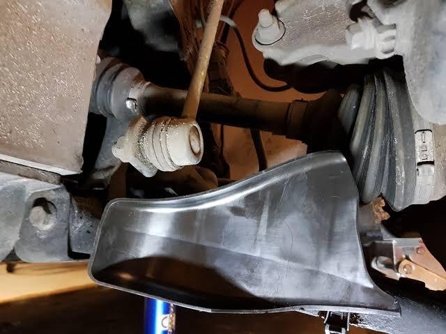

                  A combination of big calipers and new sway bar location meant that I couldn’t get my old brake tubing to fit anymore.
                  While trying to find scoop idea’s to make one up. I came across these RS3 brake ducts. Seem to be a popular mod for MK7 people.
                  Found an Aussie seller and got a pair for not a lot of money.
                  Fit onto the control arm ok. Takes a bit of force to move them so should be rated to the top speed of this thing..

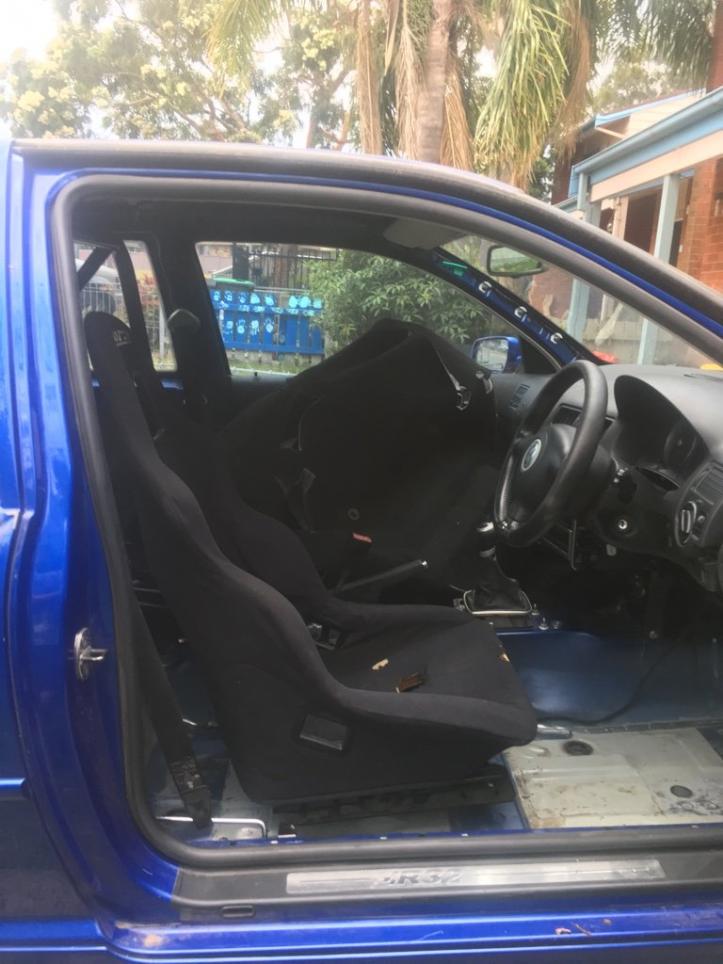

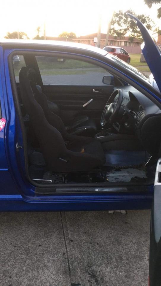

                  Also chucked a seat back in on the new seat base. Heaps lower than the other bases which is always nice. The seatbelt mount is way to high up though. So will need to look at another buckle for street duties
                  New seat base
                  Old seat base

                  • Honda civic seat belt buckle are short and easy to obtain (Ill snag you one at the wreckers)
                      New seat base
                      Old seat base
                      What do the air ducts connect too?

                        Yeah sweet thanks woody. Would need the buckle to be around 50mm long to be ideal. Also with a seatbelt light harness.

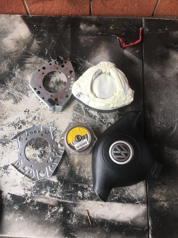

                        Re: steering wheel, I was able to remove all of the airbag stuff so it now weighs as much an aftermarket wheel, but looks oem!

                          Line up with the big side bumper vents so will scoop air in from them.
                          I mocked up feeding air directly to them with my old tubes and could sort of make it work. But will see how these go to start with.
