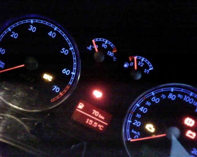

    I enabled the Distance to Empty feature today and the Option of Having the Gauges and Needles Lit up upon Key Turn
    What i did leave unilluminated was the Clock and the Odometer LCD screens below each Gauge.. these two only light up upon turning on of the lights..
    You can do al sorts of combinations of this (this only applies to when headlights are off) such as Needles only, Gauges Only, Needles and Gauges, Lower Displays only, etc etc etc any combination you like really .. including having the cluster fully lit all the time..
    Check out a quick photo of my cluster i took earlier.
    jokes here she is notice that the MFA is displaying KM's till empty and the clocks and odo lower LCD displays arent illuminated .. my key was in the ignition and turned to the "ACC" position..
