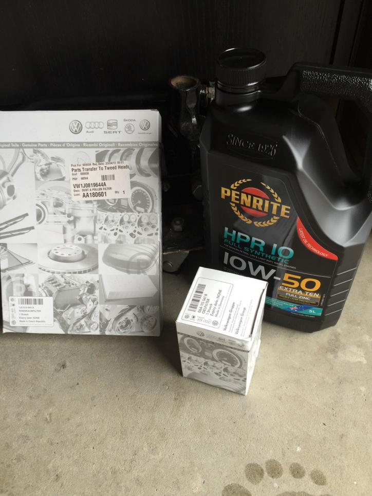

I like to think more like it stays thick. Says it can be used instead of a 10w40 on the bottle. The Squib as been on it for over a year now.
Gavin
It says on their website it meets VW 500.00/502.00/505.00 spec, so as long as one of these is the required spec for the engine, it would be okay.
e.g. on my R32 5w30 Mobil 1 in silver container does NOT meet the required 502.00 engine spec, but 0W40 in gold container does.
So I could run this 10W50 Penrite oil or the Mobil1 0W40 and both would be okay in my particular case.
The critical thing for VW engines is meeting the VW spec, not the viscosity.
I must admit that 0W40 is like water though.

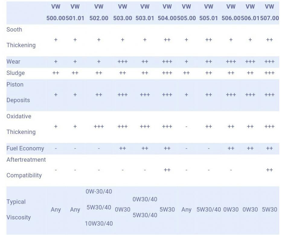

Some more info here on the different VW specs if anyone interested:
Volkswagen Oil Specifications - oilspecifications.org

Penrite do make a version of oil that's VW approved. It has the approval sticker on it and they have on their site a letter of approval from VW as well.
Same applies for their G12 coolant.
My Bora 4mo requires 500/502 standard and has 205,000km so I use:
Not cheap though (like anything to do with these cars) at around $70/5L + $15/1L bottle.
If I had a newer engine I'd probably go for the 5w-30 version.
