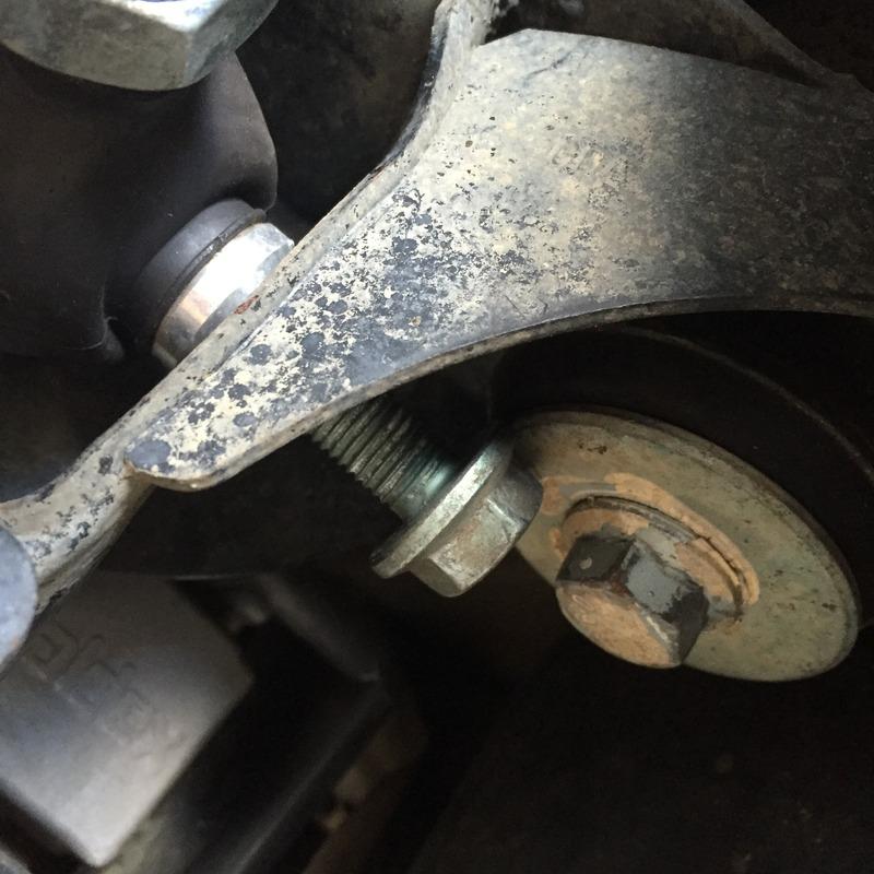

Finally found out why my driveshaft bolts kept coming loose (causing awesome grinding and banging noises).
Never. Ever. Buy. Aftermarket driveshafts.
Guess which one is the aftermarket one? And notice the end of that snapped off after being tightened up to torque?

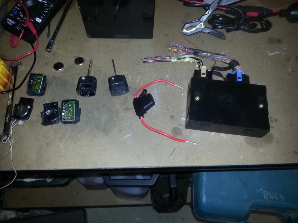

Hey guy so Im getting around to doing remote central locking on my and found this old post kendog did about the problems he had.
So from what Ive searched through ukmkivs forum Aus delivered GTIs with is a 2 plug and mine which is a lower spec golf has a 1J0 ccm 1 plug so all I had to find was a 1J0 2 plug ccm from a bora with matching keys and the extra t15 plug.
I did have a GTI 1C0 ccm but since my existing ccm was 1J0 I would have had to repin the t23 plug to suit the ccm along with replacing door and window modules whih I didnt want to do!

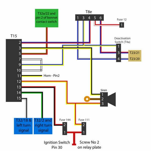

Heres a diagram on how to wire it in, quite simple when you remove unwanted accessories
And heres what I grabbed from the wrecker
The only problem atm is the led does not flash on the bora FOB which leads me to think the keys **** itself but will order new FOB and program them in!

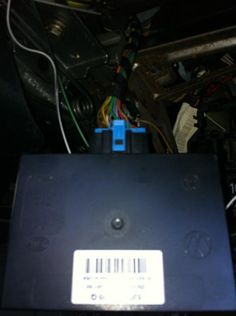

This afternoon after work, I took apart the lower dash to get to the 'comfort control module'. From what I've read & seen (guides on extending remote range), there are 2 plugs going into the comfort module, 1 main blue one, and a second beige/black one, containing a wire with clear coating - the antenna for OEM remotes. I wanted to see if I could see the 'antenna wire' coming out of the beige/black plug in my exact car. This would at least tell me (a very good indication) if the comfort module was equipped to receive signals from a remote.
Here is what they look like:
And... this is what mine looked like:
Only the blue plug, no beige or black plug at ALL!!!! So much for the antenna wire!! There wasn't even the whole plug it resides on!
This led me to conclude that there ARE comfort modules out there that that are not at all equipped to work with remotes and keyless entry! ...OEM of course that is.
So... now my search was over, what the hell to do with the deflating outcome!?!?!
I decided to install the black wire alarm/immobiliser (I had from a previous car & had already ordered the new wiring loom) as my add-on keyless entry (no pictures, obviously). A few hours later, all done, same night. Works like a charm!
