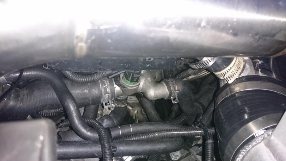

  • Originally posted by robdogg View Post
    Bypassed that pesky heater core...
    no heaters in a racecar

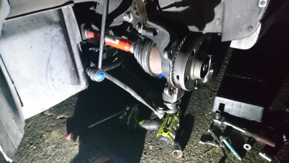

      Getting ready for some more lowering
      • Complete r32 front end suspension swap and solid mounted my subframe over the last couple of days
        Also installed some aluminium coolant bits
        And lowered it more, needs guards rolled sooo bad now! And a wash haha

              It was all actually from a tt so i wasnt sure if the rack was a quick rack or not but i tested it today and it's 2.5 turns lock to lock
              Hopefully ill be borrowing a guard roller tomorrow and ill be able to take it for a proper test drive
              • Here is a complete list of everything I installed...
                R32 Steering rack
                Poly Steering rack bush
                R32 Lower control arms
                Poly lca front bush
                R32 Spindles
                R32 ball joints
                New FAG �� wheel bearings
                R32 Sway bar
                Mele HD sway bar endlinks
                034 aluminium subframe bushings
                Poly dogbone centre bush
                90 durometer main dogbone bushes
                Lowered approx 15mm all round

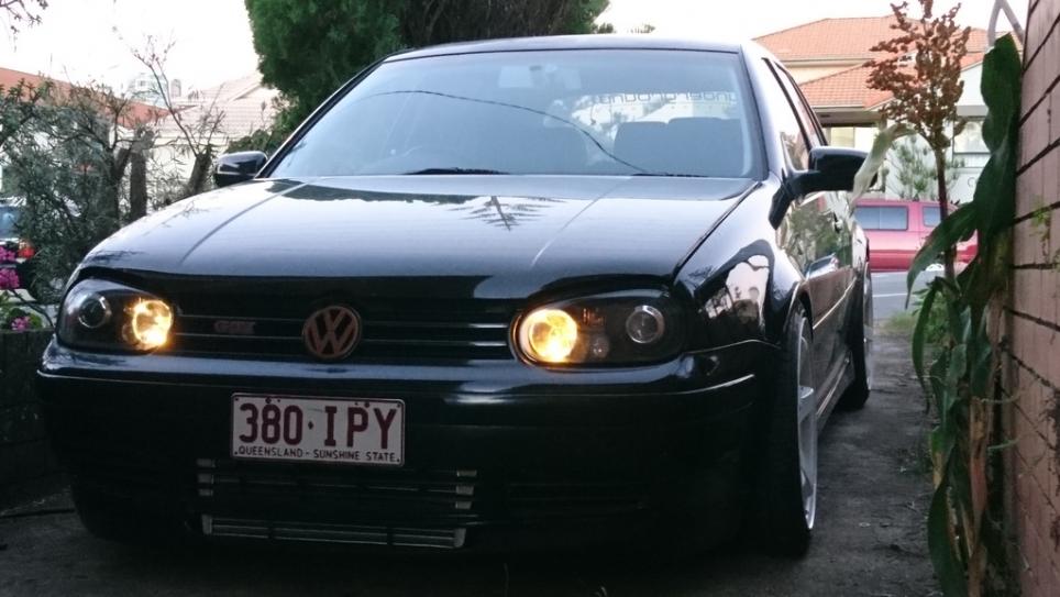

                  been messing with some asian low budget and quality hdlights..
                  needs some moreblack and the indicators not at impressed ..needs more red..
                  -like to refer this look as the angry bee

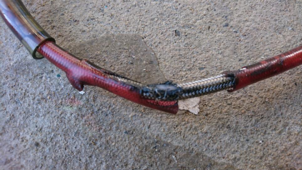

                      • Rolledthe guards and had a brake line brake lol. My fault it was rubbing because of the new lowez.
                        • Could have ended nasty
