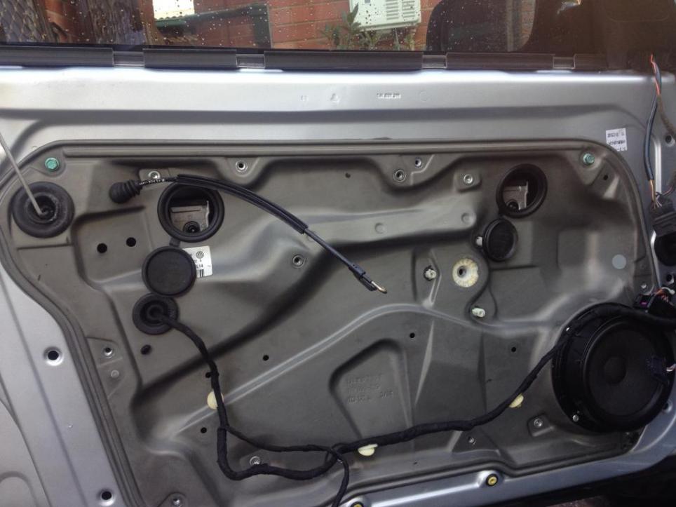

    • Had some fun replacing window clips between the showers today - also, fit new side mirrors only to find one has a dodgy motor ... (will cannibalise my old mirrors tomorrow)
