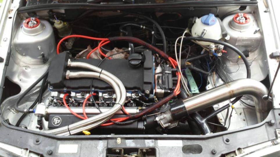

Mounted catch can.
Ran the 3/4" lines for it.
Used left over braided sleeve as ignition lead holder.
Had my mate weld up a 3" intake pipe.
Getting towards completion.

Drilled and tapped the intake pipe for the Nitrous Fogger.
I wasn't happy with how some of the coolant hoses sat, one of them actually interfered with the shifter mechanism so I got one of the Relocation Reservoirs.
This one by passes the heater core, which will likely leak after not experiencing hot water for so long.
I was shocked at the amount of hoses that can be removed when installing these things!
I was able to use some of the hose kit to plumb it up, need a U shaped bend off the thermostat housing to go under the two main hoses, as well as a 90 for the fitting off the top of the head.
Chopped off a excess bit of hose.
And plugged with a shiny blue fitting, left over from the old fuel rail.
I also moved a bunch of the grounds and loom from the front side of the coilpack, to underneath the new reservoir.

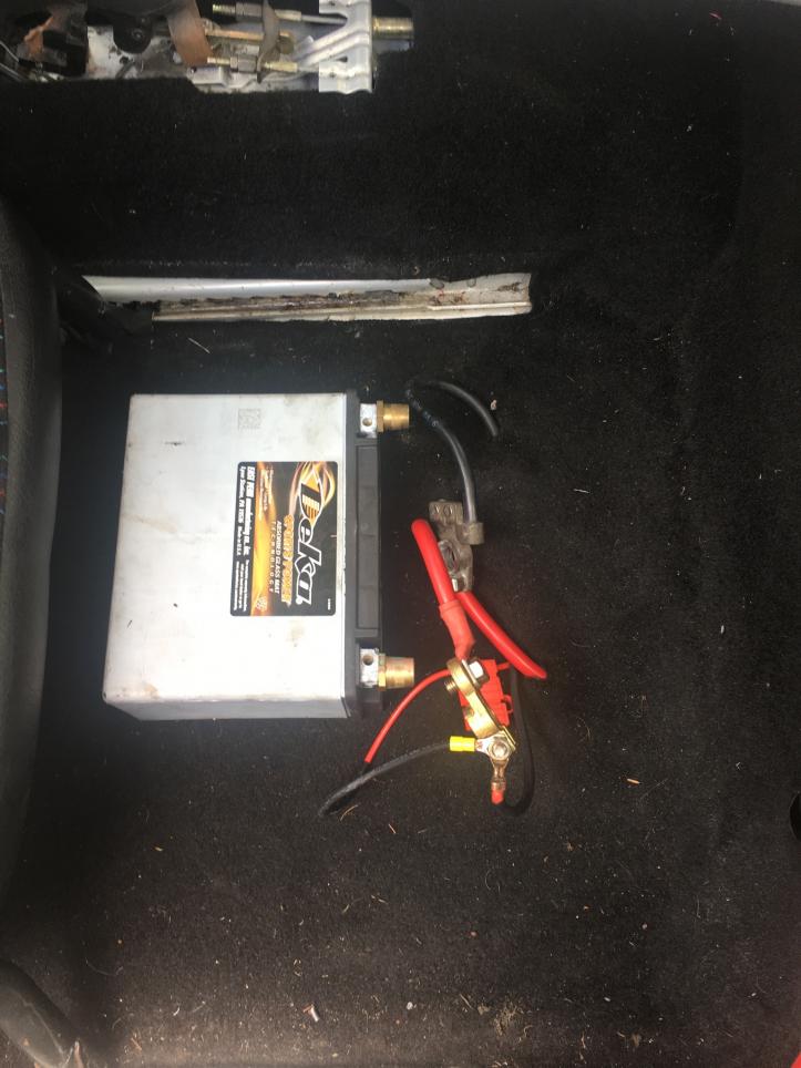

I 'think' I've decided to mount the battery under neath the passenger seat. So will buy some fat cable to relocate that this weekend.
Ideally I wanted to keep it over the front wheels to help with traction. But between the catch can and the giant air filter I am running. There is just not enough space left behind the bumper and I feel slightly uncomfortable having it sit under the fuel lines on the driver's side of the engine bay.Last edited by HaydEn; 04-12-2017, 11:11 AM.

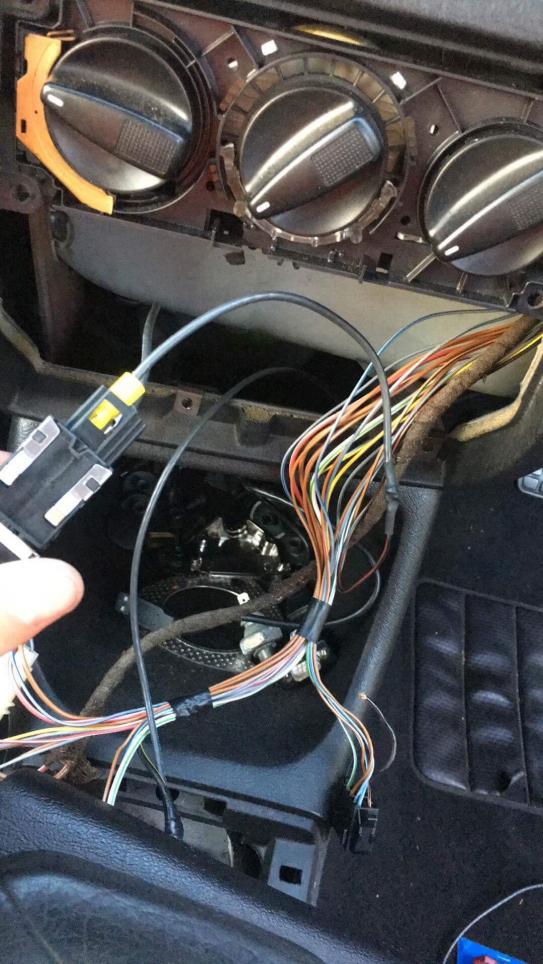

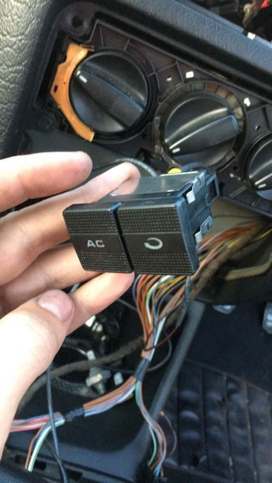

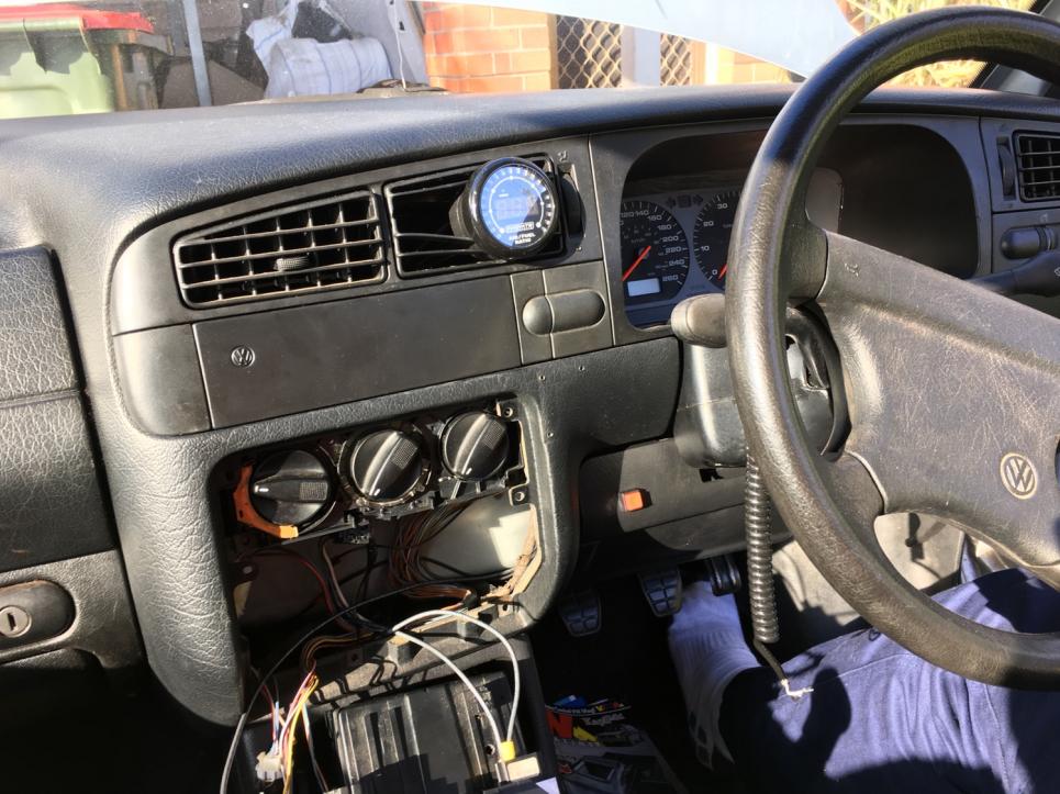

Finished up the bottle heater wiring and the nitrous button. Cable tied so I can remove it when not in use
I used the oem A/C button as the master switch for the system.
Made a new positive cable to remove battery under the passenger seat. Yet to make a mount but will be ok for now.

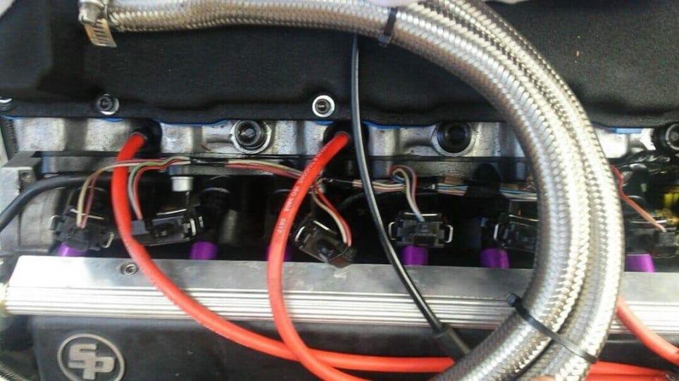

Opted for the fresh ID1000’s, should be better than dirty oem one’s even just on 98.

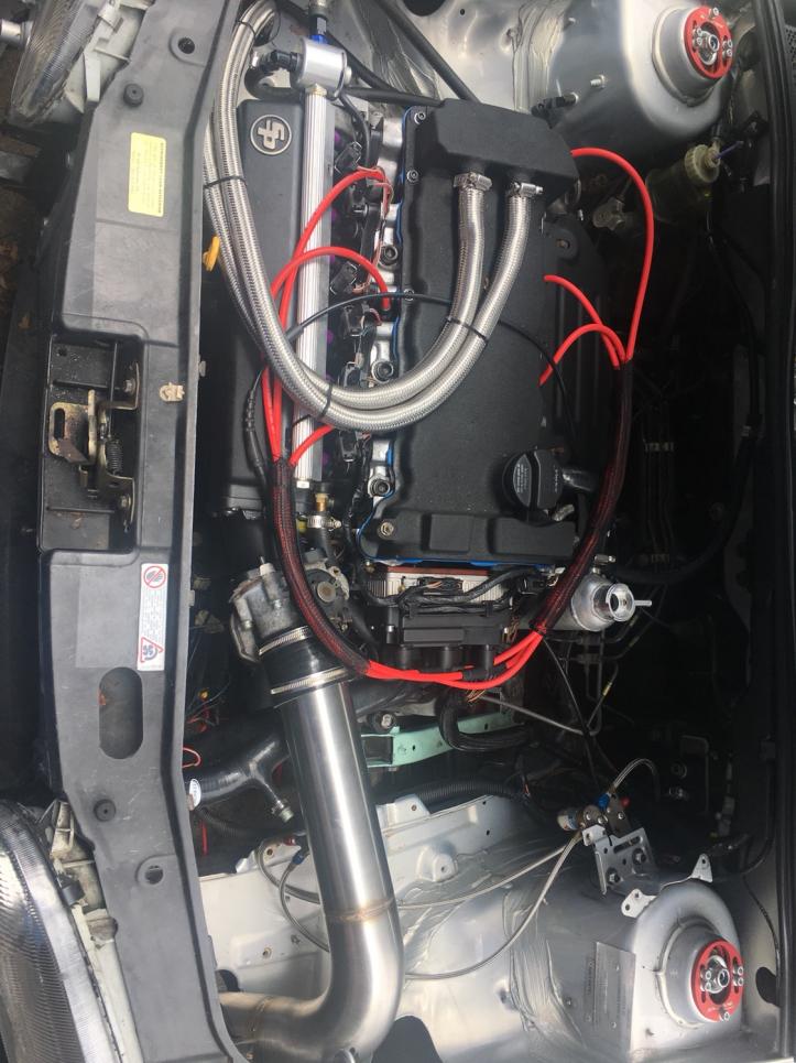

And almost finally, A finished engine bay!
All it needs is a clean and a purge solenoid hidden behind the strut tower when it arrives this week hopefully.

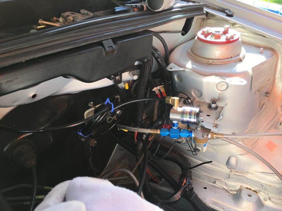

My purge kit finally arrived which signifies the last purchase to arrive/be installed.
So quickly installed that this arvo and finished up the activation switch wiring.
I have now successfully made a F&F MK3....
Coloured buttons everywhere!
Purge solenoid mounted off the nitrous solenoid.
I’m using the washer jet as the purge exit for that OEM touch.
So now if I’m not mistaken it is, cable tie front bumper on, lower rear of car a bit more, buy a radiator cap and fill it up with water.
I do still have to make the fuel feed hose for the fuel solenoid, but I will do that one arvo this week.
