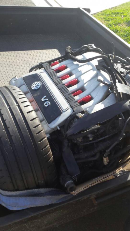

    It all started a few months back when i was fed up with vag cars and couldn't wait to leave it all behind. Then a cheap R32 motor came up for sale and thought F@!k IT. Let's do it again properly this time.
    So picked up the motor one day after an all nighter at work.

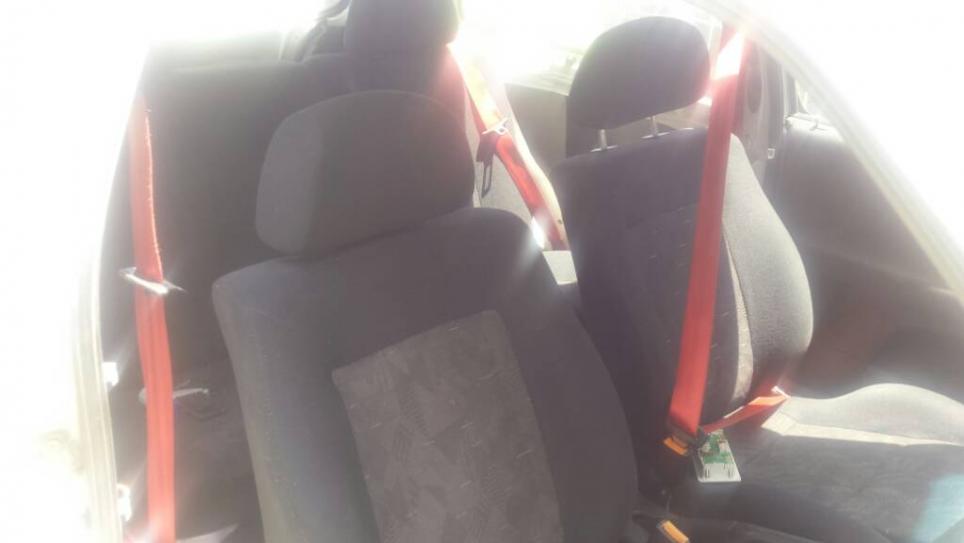

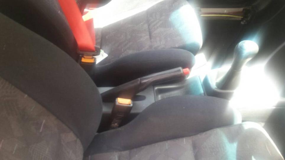

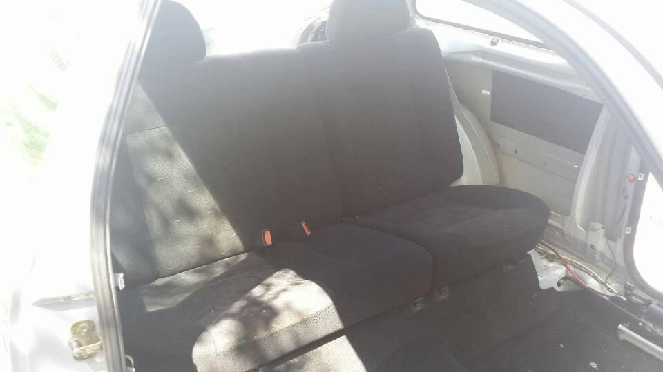

    Stripped interior, removed most of the sound deadening, sanded and rust converted the floor, carpets back in and vr6 seats in.
    I've always wanted these jahre belts and i could never justify the cost but a set came up cheap ish so jumped on them. Along with the Handbrake too.

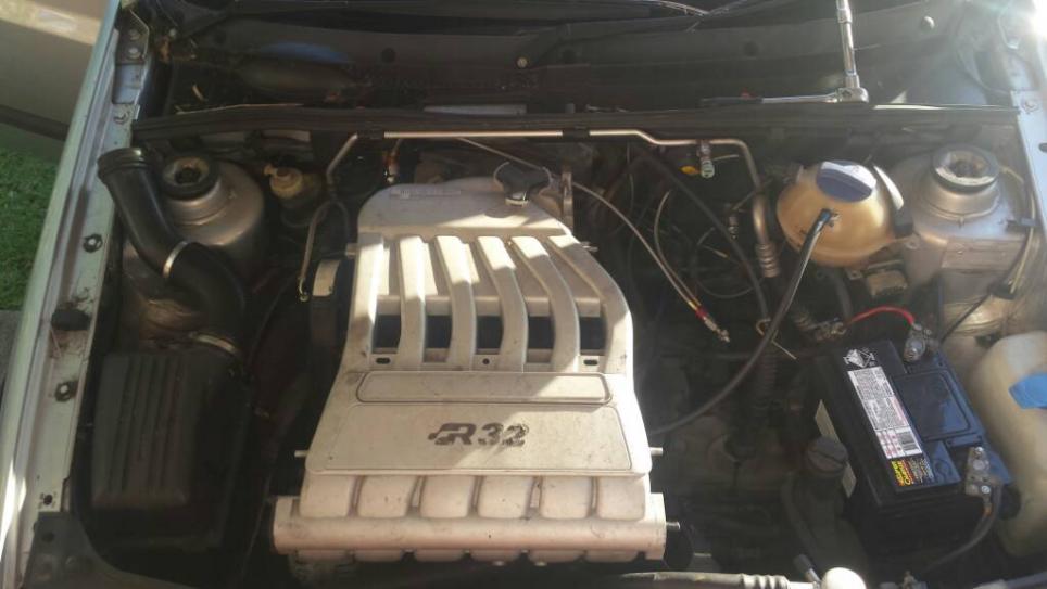

    Armed with a box full of goodies from ecs plus some other things i started messing around pulling down the 12v for the necessary parts to make the 24v work in the mk3 bay.
    The motor is getting new chains and guides, 550cc injectors, the camshafts, 90A alternator from the 1.8cl, 12v cooling system(crack pipe, thermo housing with low temp thermo, all coolant lines) IE egr delete and whatever else i have forgot to mention.

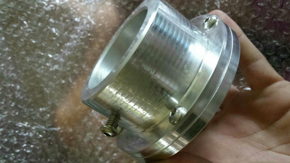

        Will be using an adapter.
        It can be mounted without one, however due to the r32 intake manifold design it won't have the best seal in the world. Plus with the adapter I can bore out the manifold to have a smooth taper.

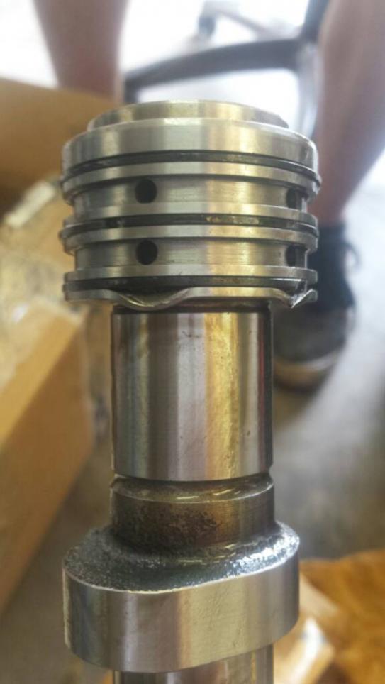

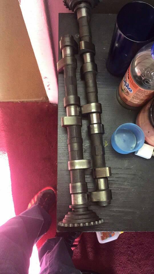

              Went to spin by hand before putting covers on. Got 1" then locked up.
              Figured something had slipped with timing. So started pulling back down to reset bottom end.
              No frigging clue how this happened. Apparently the vvt gears don't really need the 3.
              Options are machine off run vvt, hope for best. Or to get vvt delete cam gears so oil pressure is not an issue.
                Currently having the cams machined true again.

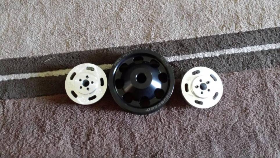

                Also got a Neuspeed power pulley for pennies.

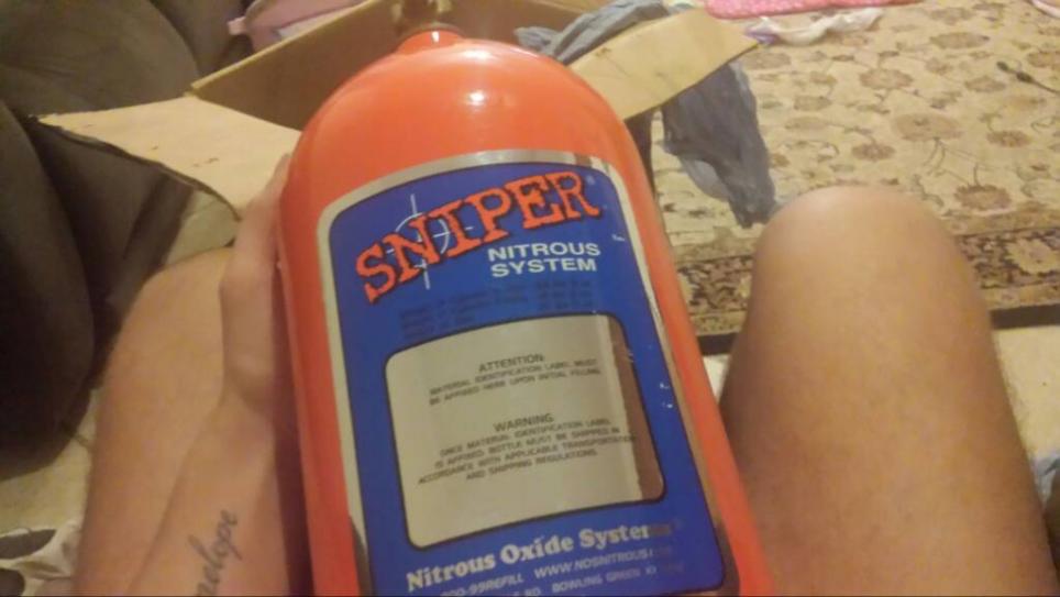

                Set up the mechanical side of the Nitrous system for now. Bit all over the place but best i can do without getting more braided line made. Will be pretty unseen once there is a 3.5" intake pipe.
                  Sweeeeet. Was there any more ideas on what caused the cam damage
                    Likely user incompetence..?

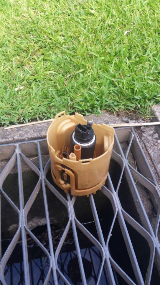

                      Walbro 255lph in tank. Snug and secure. Got it mounted low enough it should have no issues with low fuel pickup.
                      Just need to get a pump filter as i gave mine to a mate.

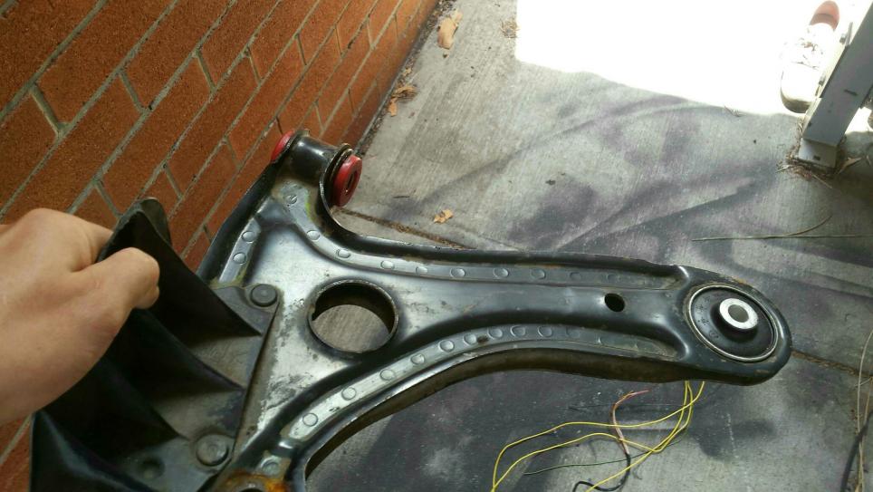

                              Poly front/R32 rear control arm bushings and new ball joints
                              Powerflex 'black' steering rack bushing

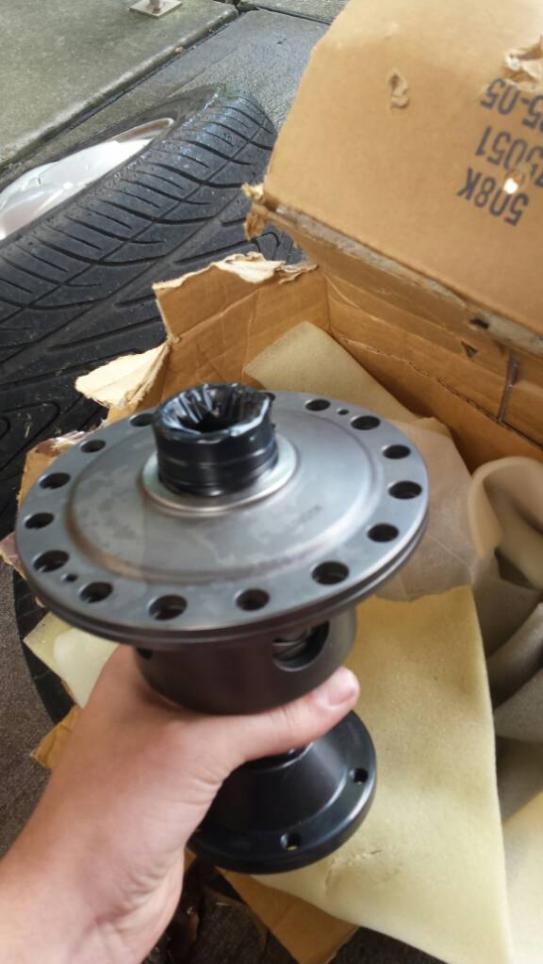

                              VWMS/Gemini LSD with titanium drive flanges, put in a .71 5th gear so i can do some long highway if need be too.

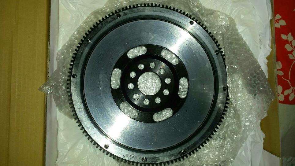

                              Competition clutch flywheel 9.75lb

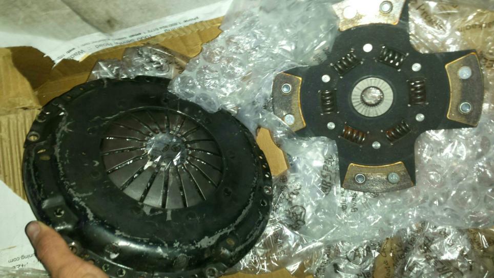

                              Competition clutch kit (way overkill but cheap)

                              Schimmel bosch 040 pump adapter to sit intank. I couldn't get the walbro to sit low enough for my liking, plus this will have the headroom for anything in the future.

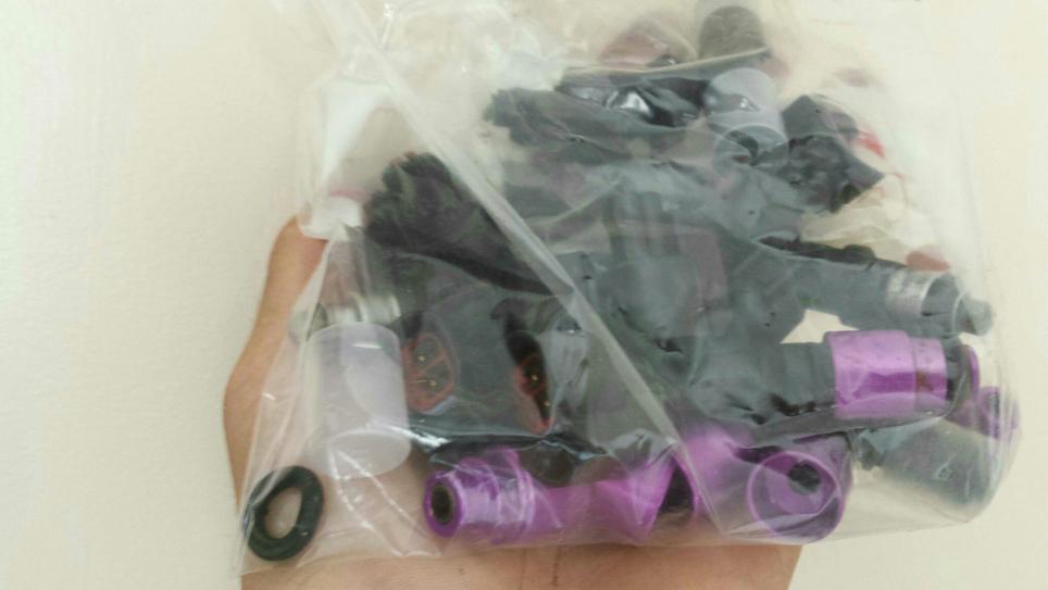

                              The 040 will be feeding ethanol to these bad boys. ID1000's
