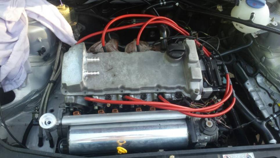

        Valve cover with 2 3/4" breather ports

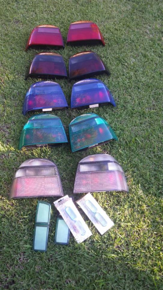

          Nothing else has taken place. Been injured and unable to do anything.
          Picked up some stratos tails off Ray. Few more to go on the collection yet.

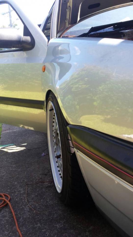

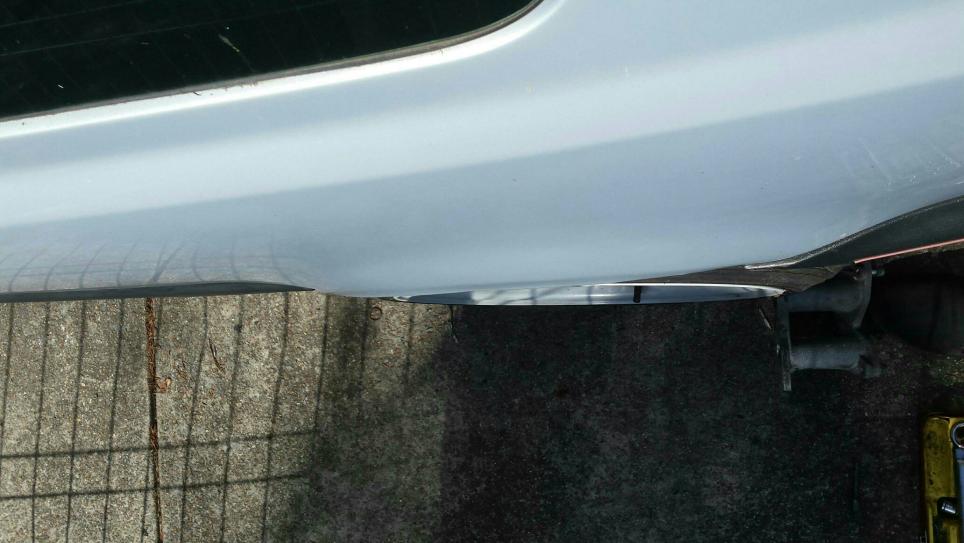

          Swapped the rear bumper to the textured one i had from the other vr6. Removed the dead weight reo at the same time.
          Watered off some dirt and put my optikwerks side skirts on too.
          Mid may is when there is enough free time to tow it to the shop to do the remaining fab stuff.
          So so keen to cruise in this thing.

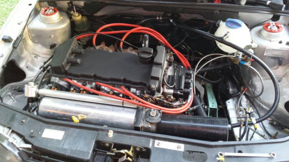

                Wrinkle black painted the valve cover.
                Mounted the nitrous solenoids aswell.
                Going to make a sheet metal cover for the battery area to hide the wiring and mount the battery onto that too.

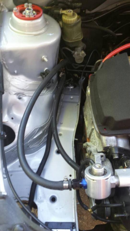

                Need some fuel hose and breather hoses for the catch can.

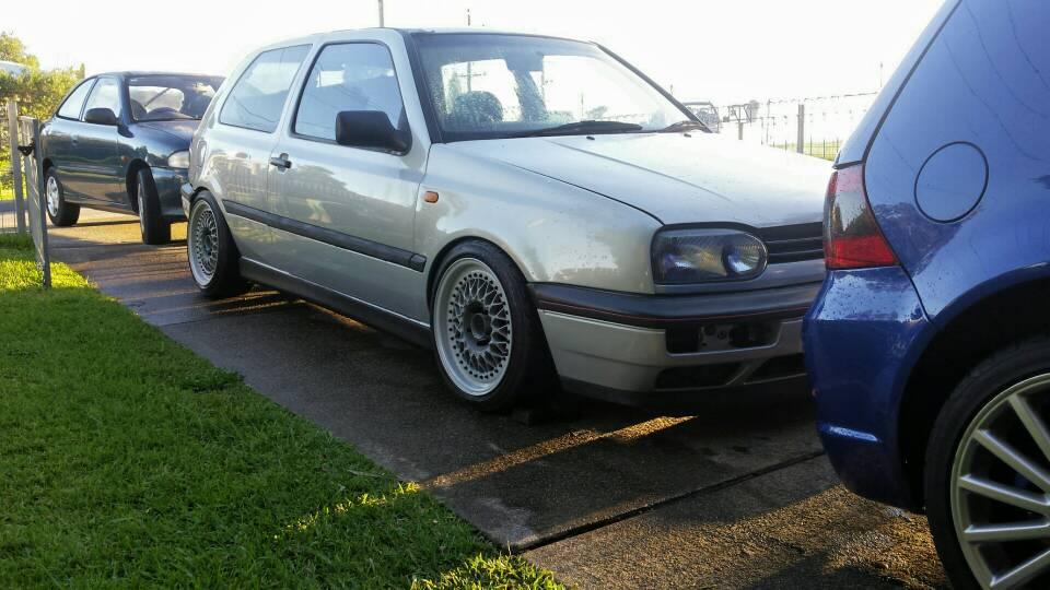

                        So!

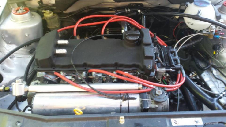

                        Finally the car runs. Still needs some exhaust and intake work but it is 98% complete.
                        After 5 odd years of always pipe dreaming about cool SRI manifolds. One finally came up cheap enough for me to justify purchasing. Insert SCHIMMEL!
                        Now, it isn't ideally what i wanted in a SRI, really short runners, no runner compensation etc. But for the purpose of peak RPM power, they seem to do the job, plus it was complete in black, with the elbow, fuel rail and cable mount. No more dodgy cable ties[emoji20]
                        Rolled the guards and lowered it. 16x8 +12 sitting flush in front.
                        16x8 +5 swallowed up in the rear, thanks to a couple of washers behind the stub axles.

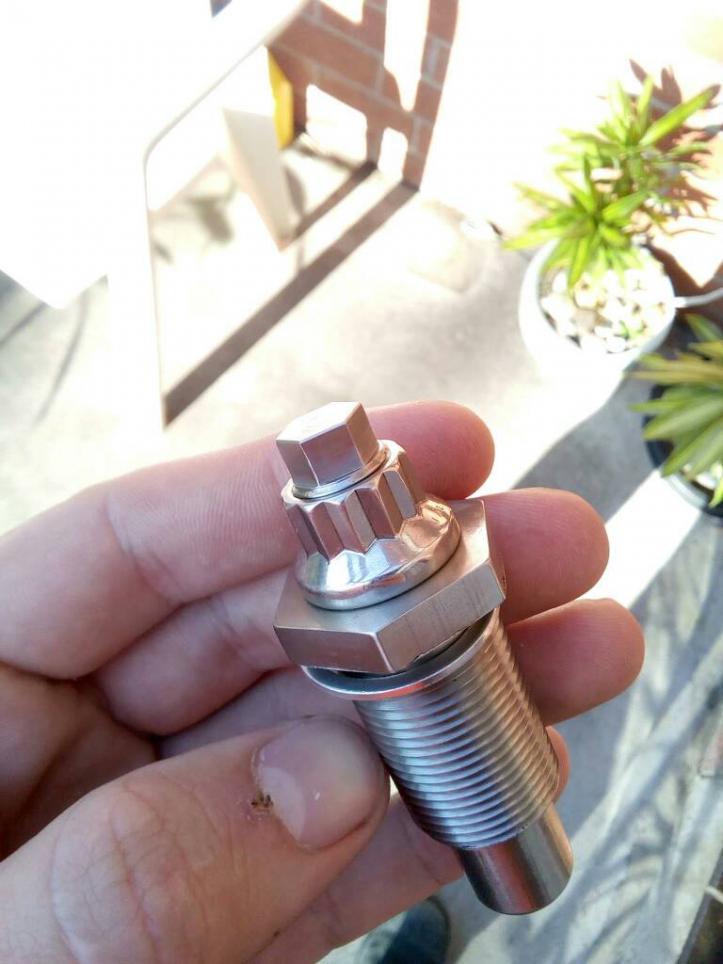

                          I also forgot!
                          After bleeding the chain tensioner 40 times it would still lose pressure and slacken the chain. Eventually skipping a tooth.
                          So i bought a new oem one. After 1.5 months, I still hadn't received it. So jumped onto the manual tensioner. Hopefully 'set and forget' works!
                          Once again another bling piece from Schimmel.
                          So far this thing has been good to me!
