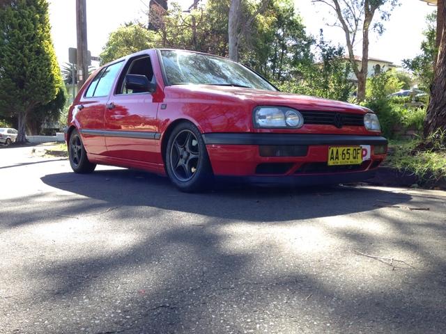

                    That brings us to this morning. So im about 2 weeks from the HSC and i didn't really want to waste another day on this but i couldn't leave it with one last corner to do. So i woke up early, about 830 and got into cutting off this bitch of a bolt. Pretty much tried every power tool, drill, multi tool, dremel. None really did much, so i whacked out the hack saw. Cut the old bolt off after about an hour or two.

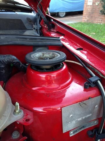

                    After installing and making sure both sides were equal, i lowered it off the jack stands and she was standing by herself, i was so relieved! Untilllll... i found that the upper strut tops were popped out and up from the strut towers? I do not know what i have done wrong here, but can someone help me? I believe i installed everything the right way, but obviously not...
                    Anyway heres how she sits now... going to raise the front and lower the back, just so theres not rake. AND I NEED WHEELS ASAP

                      Did you replace the Strut top mounts as well or are they the originals? If they're the originals chances are they're worn out and that looks normal for a worn out rubber mount. Invest $50 in some HD mounts from euro revolution.

                          Looks better with a touch of rake then being level.
                          And thats normal with the top of the struts.
                          Only thing that got me concerned was it took you 2hrs to hacksaw a bolt...
                          • #43

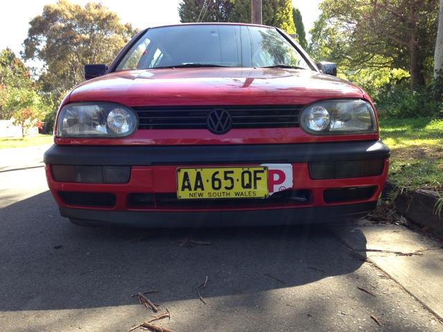

                            Just don't forget to get a wheel alignment now. From the pictures it looks like your running way too much negative camber in the front!
                            Other than that looks fresh
                              Yeah no, they are the originals because im cheap and lazy... I just thought because my car hadn't done alot of kms they would be fine? maybe not. They also make a weird knocking noise when i go over slight bumps

                                Hahahha, wasn't thinking that far... but just so it was a bit more level.
                                Yeah, looking into it, i definitely want a bit of rake, but the front is just a bit too low for my area... speedhumps on every back road Are you sure thats normal? i've been looking around and others don't pop out, they also make a knocking noise, which i cannot deal with at all
