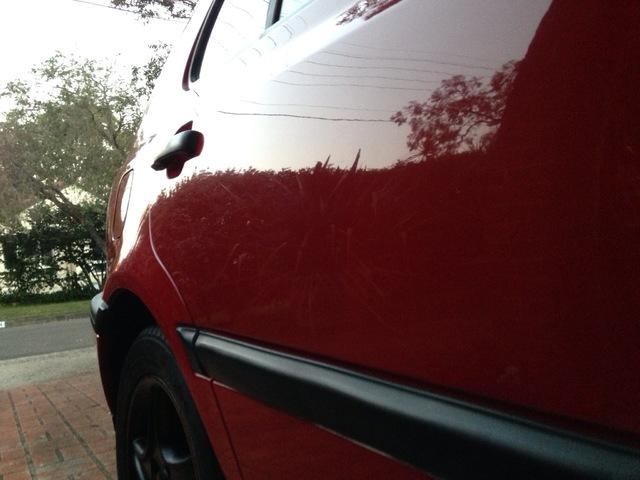

          Sooo this afternoon when i got home from school i decided to attempt to restore the paint on the rear drivers side door... Im pretty sure there is no clear coat and it has just faded over its 16 year life time.
          Not too bad for my first attempt, just some paint cut/cleaner then polish, then topped it off with some spray wax that my dad has...
          When i get the time ill be doing the whole car, but before that i need to find where to get some clay bar, anyone know who stocks some?????

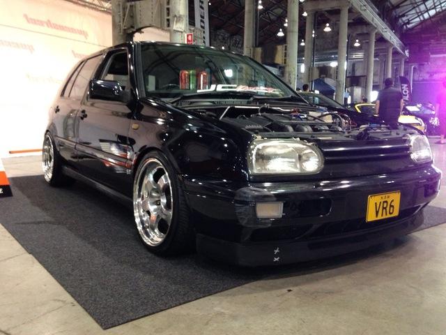

                        Not an update on the car, but an update non the less. Went to the lowdown meet today in sydney, anyone else go? Anyway, awesome day so much want!!! One day, one day. Saw a mkIII Golf VR6 with the plates "VR6" in the actually show, not sure who owns it but it looks immaculate rolling on work meisters

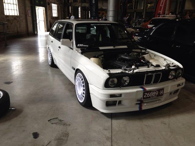

                        Also this wagon is the sex

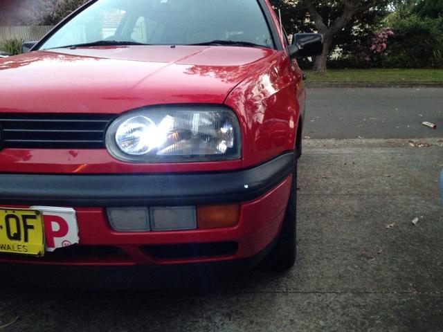

                        Aaaand this is the most recent picture of the golf, i can't get any really professional pics of it as i cant drive it around to find a dank spot to photograph it, october 9th come sooner pls

                          That VR6 looks mint, lol is that mike's touring?

                              The VR6 is literally the ambition for my car... so well presented, perfect amount of lows, amazing

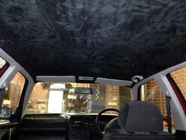

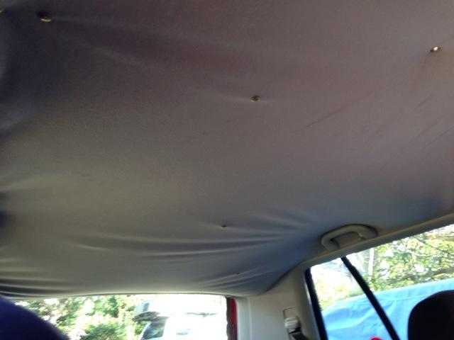

                                In the mean time, i have kept my self occupied by redoing the headliner in my car... Before it was like this; saggy and held up by dodgy thumb tacs... ahah
                                Sooo i headed down to the the local spotlight and bought some fake suede for like $25 a metre. Took out the headliner and spent about 3 hours straight trying to get the old sticky **** off with a hard bristle brush, untill i found that carefully scraping all of it off with a razor blade is ALOT quicker. Put a whole can of spray adhesive down and bobs your uncle, i have a new black suede headliner!
