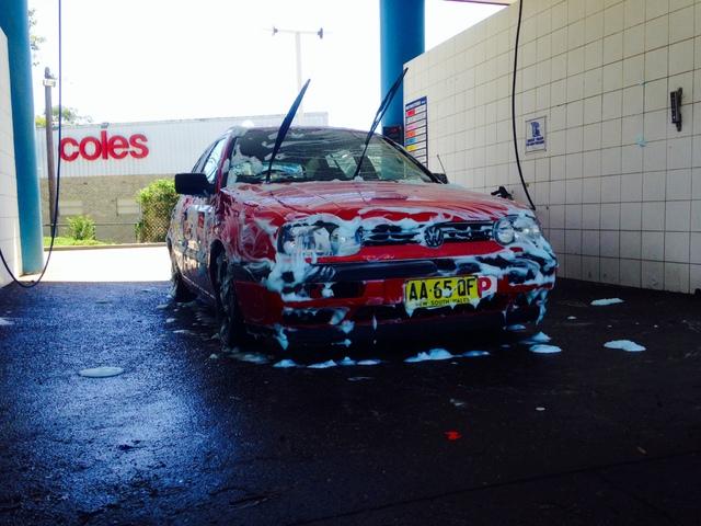

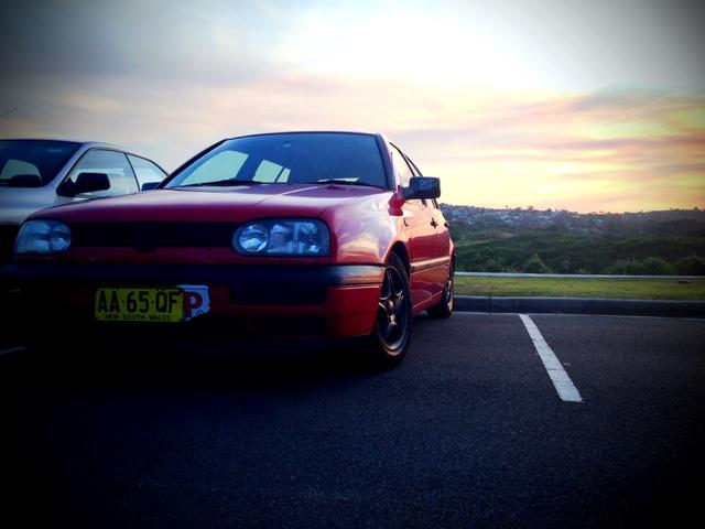

          Any way heres some pics:
          Need some new rims ASAP
          Not sure if tripping or is that Turramurra?
            Hahaha, you're not tripping that is Turramurra, you live around here?

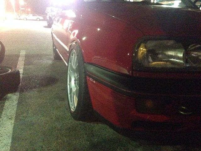

              UPDATE!!
              Fitted my new wheels on Tuesday night and they looked amazing! The first picture is without the coils raised, others are with all four corners raised 5cm in the back and 4cm in the front. Scrubbing is a MAJOR ISSUE for the rear because the rims are 17" by 7.5" with an offset of ET15...
              Dat credit card gap :O ahhaha

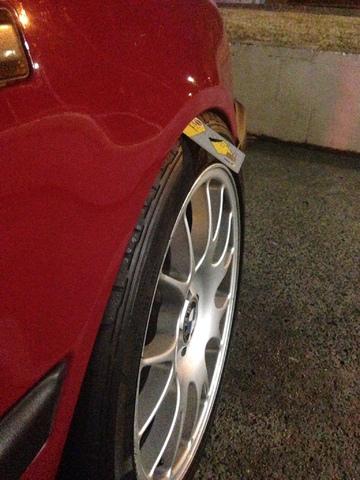

              First drive scrubbed both rear tyres horribly, they just scrubbed all the time not only over bumps. So the next day went out and bought a thick round piece of wood and got to work rolling the guards. Took about 45 minutes on each side but did the trick. Only problem is that now the suspension is so high, i look like a monster truck, and all stiffness is just about gone out of the coils.

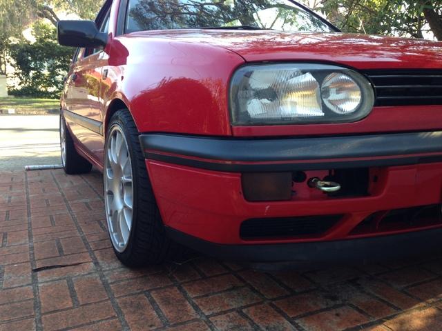

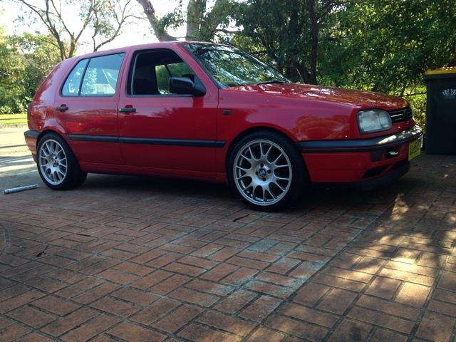

              And heres what she looks like now, can still go lower in the front, and will do when my next exam is over, but untill then it doesnt look too bad..
              • #67
                FCK YEAH! NAICE, thought 17s would just be too big but they sit nice, im sure lowering the front would look even nicer
                • #68
                  Looks awesome bud! Good fitment on those reps too!

                      With the 'right' tyres you should be able to eliminate most or all of the scrubbing. 45 is way too big on a mk3 but looks cool.
                        Yeah the front rims have 40's on them and they dont scrub at all, and look MUCH better. You're right waaaay too big i reckon, but these did come off an e30, can't complain for $450

                          Should be able to sort your scrub issues out with some rolling/pulling. I ran a 7" -3 with 195/45 and was pretty close to tyre and hardly scrubbed.

                              Yeah, rolled them yesterday as much as i could untill the rubber/glue like substance inside stopped it from rolling flatter... Only scrubs over bumps and when i have someone in the back seat, so its not too bad, but its just killed my rear tyres...
                              Im organising a bloke to come and properly roll, possibly flare my guards with his machine sometime in the next week hopefully
