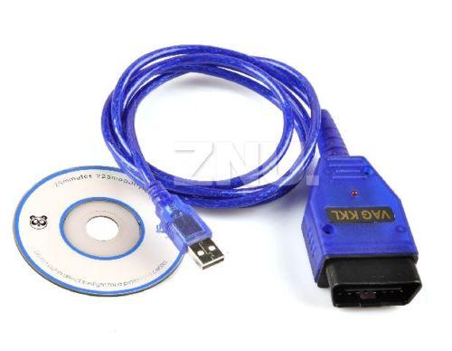

                              • Originally posted by feenix74 View Post
                                So it should work for all my cars other than the 96 Vento (which has a compliance date of 08/96 but a build date of 08/95), which is the vehicle I really need the Vagcom for. Back to square one and doing some more research for then. Thanks for the info.
                                My car is in the same boat, compliance date is 96, build date is 95.
                                I bought a cable that looks like this and it worked for me.
                                Past - '95 VW Golf MK3 VR6
