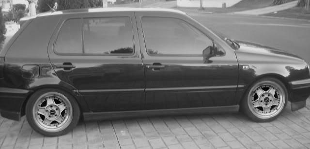

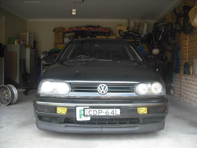

    Test fitted rears for the simmons and they bolted straight on! Caliper clearance, centre bore and pcd no problem.
    Hopefully look at some wider lips for the rears.
    I think I need about 20-30mm spacer to clear front calipers.
    2 minute dodgy photoshop to see what they'll look like
    yellow fogs

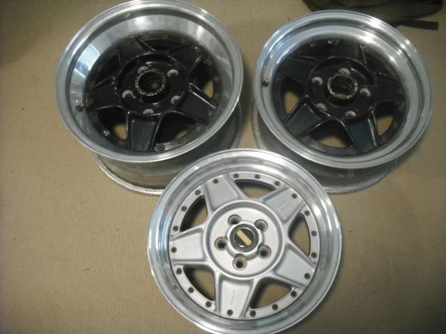

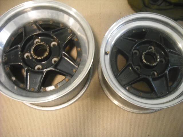

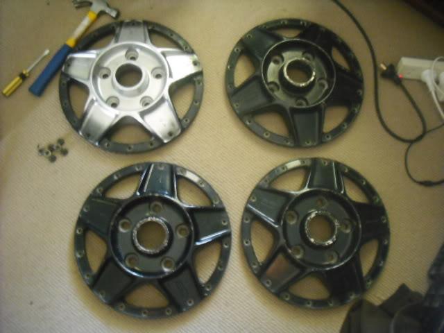

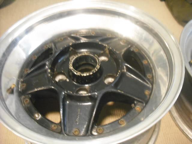

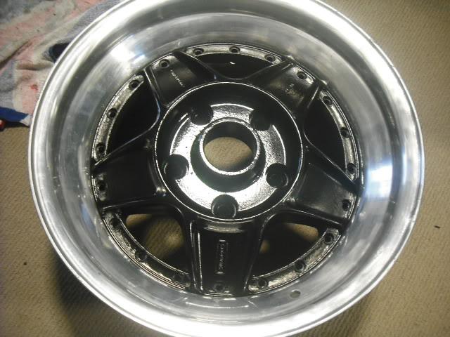

                  Here's some pics of the simmons I've been working on.
                  16x9 and 16x7 5x130 when I got them
                  My three different sizes and two different centres
                  When I finally managed to get the centres out. Previous owner rocking 3 blue and 1 silver/blue

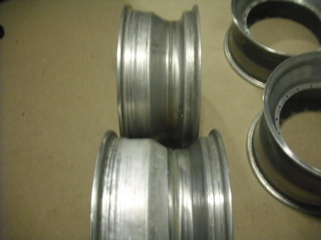

                  working on polishing the lips
                  staggered?
                  Painted 5x130 centres gloss black and threw one in to see what they'd look like

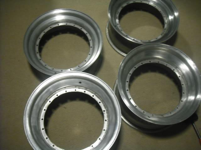

                        Got some mothers mag and aluminium polish onto the lips and that stuff is amazing! They're so much nicer. Also bought a guard roller after being quoted $75 per corner and a torque wrench to get cracking on reassembly. Going to pull the trigger on spacers soon just want to do a few more measure ups. Not sure if I want to paint my centres before they go in though... Like the idea of keeping them silver because I think the finish won't chip as easily as painted but think maybe white could be cool. If anyone has any advice on cleaning up the bolts I'd appreciate it. Tried coke, brake cleaner, vinegar etc. Been hand sanding them but that's annoying and not getting great results.

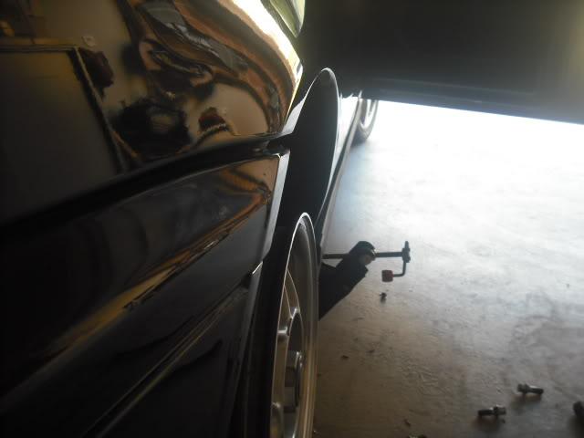

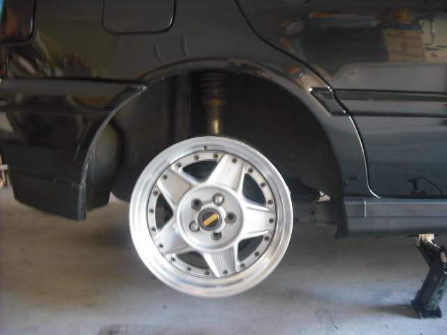

                              3 out of 4 wheels reassembled. 25mm spacers for the front ordered to bring fronts 16x7 et0 and rears 16x9 et23. Thinking I'm going to need to shave a little off the front calipers for clearance still so will get my hand on an angle grinder soon.
                              Rolled right rear fender, not happy with the amount of paint cracking although I'll take the blame for working fast on a cold day and only using a hairdryer instead of a heatgun. Lesson learnt won't do the others until I have a heat gun.
