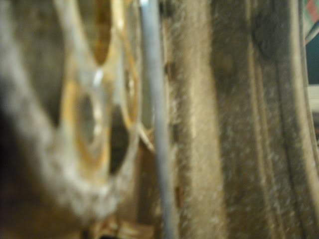

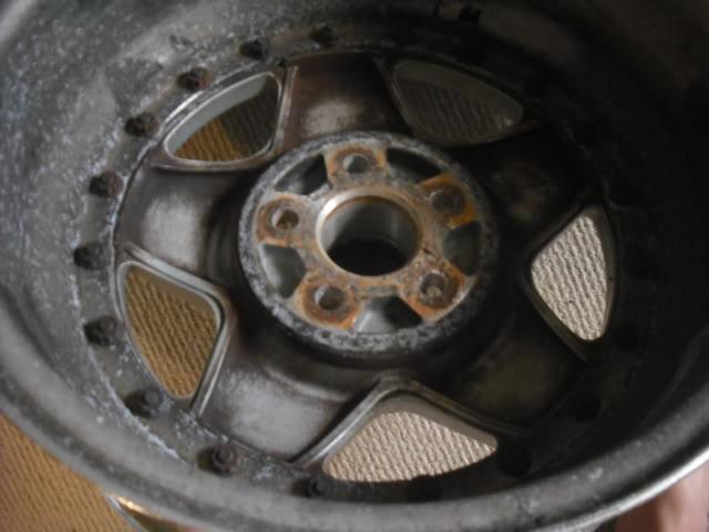

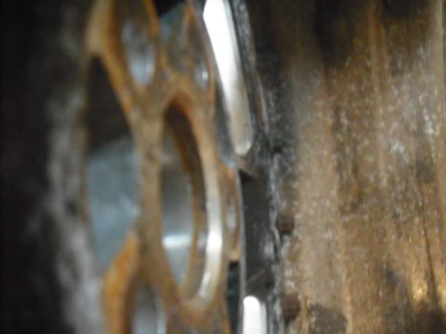

              Tried fitting the wheels today just to see what happened. Due to the design not the spoke but the nuts around the outside hit the caliper and I couldn't even try getting the wheel face onto the hub to see the difference in centre bore so definitely going to need spacers. The mounting face is pretty much in line with the bolts and on the car the caliper pokes more than the hub so that's the issue. Also slightly worried they're the Alfa 5x98 pcd instead of 5x100. I guess we'll see what happens. Pics to help try explain what I mean.
              If I'd known all this I probably would've bought something else and ran adapters but oh well. I have these now so hopefully I can make them fit!

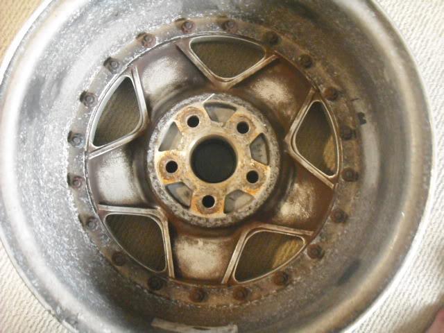

                    I measured them and I think they're 5x100 but I did see a set that 5x98 so it makes me wonder. Pretty sure they're 5x100 though. Yeah I was thinking maybe 20mm but after more measuring I'm not sure 20mm will be enough :/

                          The problem here is that i can't get them on the car the spacers aren't for width they'd be for clearing the nuts from the caliper and getting the wheels on the car. I can't try see if the centre bore is right cause the caliper stops the wheel face getting near the centre bore. Hope that made more sense so you understand the problem.
                          Tomorrow I'll try the rears and hopefully they'll go on and the caliper won't interfere

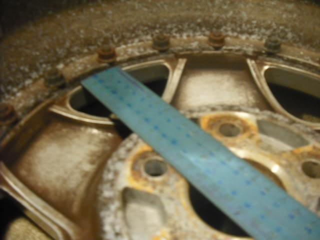

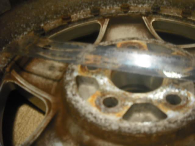

                                Just did some more measuring up on them and decided to double check the width turns out they're only 6.5" I guess the guy who owned them had no idea and didn't measure bead to bead. Barrel 5", Lip 2.5" overall width 192 so centre line 96, face to inside lip 132, 132-96=36
                                So I guess they're technically 15x6.5 et36
