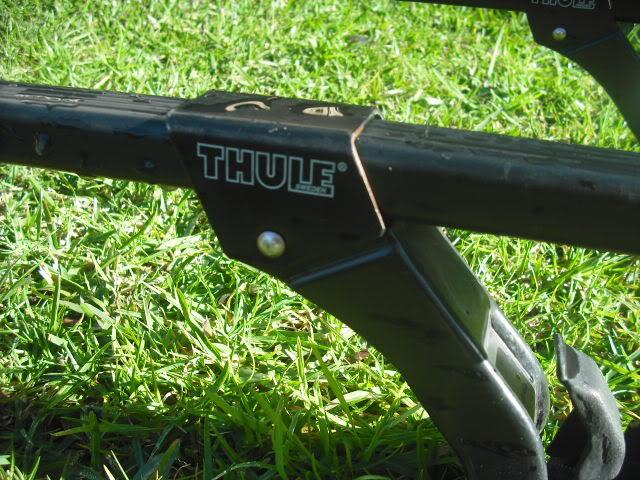

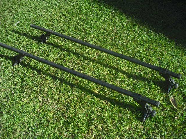

                      Was talking about roof racks and my step dad said there's a set stored in the roof of the garage from his old hilux. Got the ladder out and up into the man hole pulled these babys out
                      Sweet! Free THULE racks!I believe they're thule 300 or something. Not that keen on fitting them permanently until I can figure out a way to lock them down so no one pinches them.

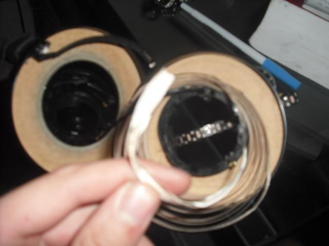

                          Thanks mate, I have actually tinted the indicators a little darker and tinted the fogs yellow. Not 100% sure I like the yellow yet. I'll take some pics and put them up soon.

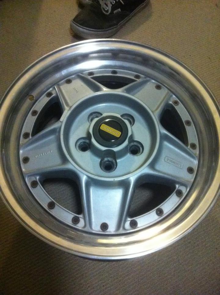

                            Really wanted Jarreds modern lines but unexpectedly had some costs that took priority and so couldn't get the money together for them. After regrettably telling him this I found a set of 5x100 15x7 simmons 3 piece wheels on eBay about an hour north of me. Messaged the seller and managed to grab them for a good price so I went and picked them up this arvo/tonight.
                            After doing some maths I think they're et36 which isn't great but I might fix that with new lips or spacers or something.
                            The centre bore is 55mm so will need that machined out to 57.1
                            Haven't tried putting them on the car yet and they probably won't because of the centre bore, fingers crossed they'll clear calipers.
                            I know there's a lot of hate for 15's on a mk3 but I couldn't be fussy with my budget and the centres fit the 16" barrels if I can find some later on.

                            • #59
                              I saw these and thought. "could these work on a mk3?" glad a mk3er got them.
                              • #60
                                Hopefully I can make them work I can't seem to find any info about other people running them but once the centre bore is right I can always just use adapters to make it work. They would've been close for you, picked them up from East Maitland
