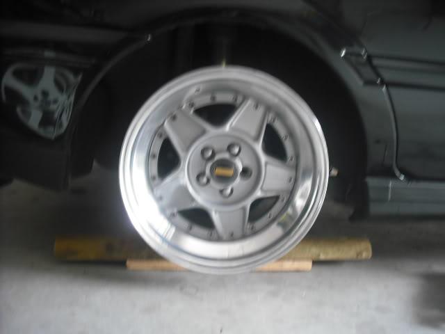

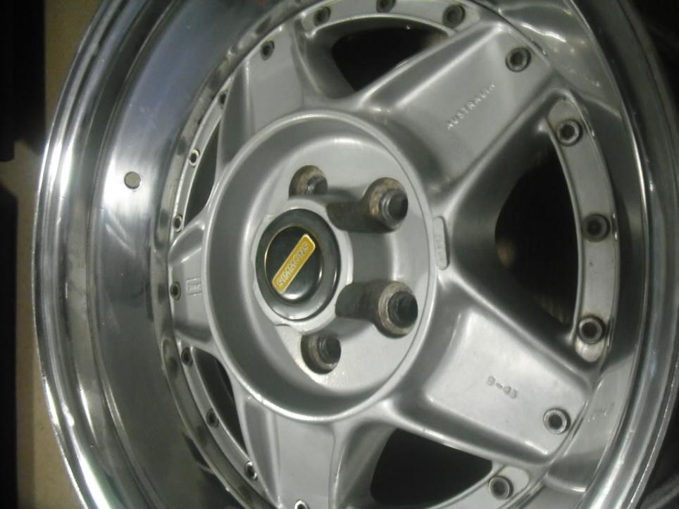

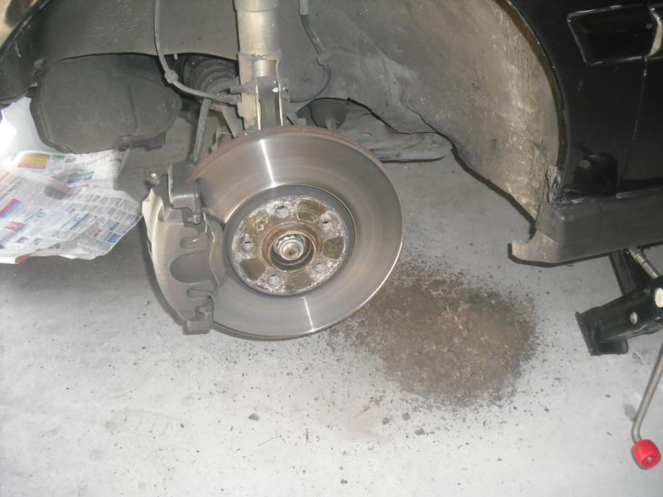

Fitted spacers. 3 piece bolts still foul the caliper starting to realise why I haven't seen this done before. Some caliper 'modifying' will be necessary I guess.
The lug bolts can now go in so that's a plus but the wheel won't rotate because the outiside bolts get stuck on the caliper. Damn 3 piece good for nothing haha. It's because the simmons centers are universal in the 15" and 16" so the bolts on the inside are less than 15" in the diameter of the wheel and so collide with front brakes. So annoying.

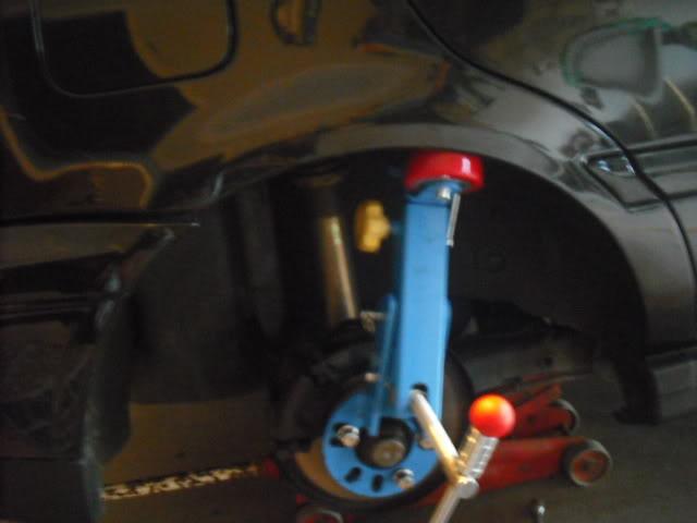

Just wondering since your making the trip down to see hawky, want to drop by and let me borrow your guard roller ? Serious. haha. Looking good so far man !
Hey mate, not sure when / what's happening with that. Hayden has already got first dibs on the roller though. If your not in a rush I'm more than happy to help you out a little later?
Also general warning guard roller won't work if your slammed. Took it over to do a friends mx5 but the coils were wound down so low I couldn't get the roller in. You can always wind them up but just thought I'd throw the info out there.
