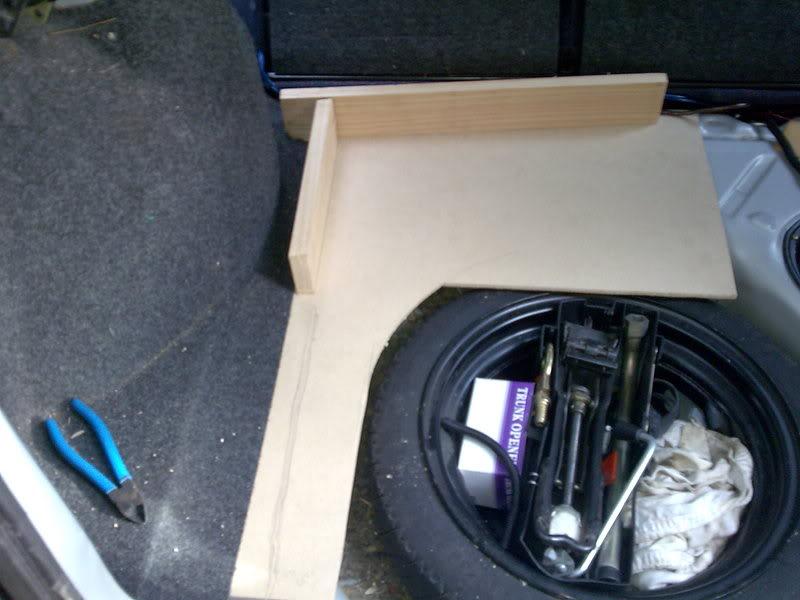

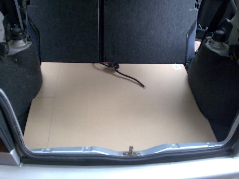

                      • Well I got bored this morning so decided to get started on the flase floor. I had a load of MDF left over from making a new parcel shelf for my R31.
                        I used the boot carpet as a guide/template for the shape of the boot floor. I decided I needed somewhere to stick the amps to initially, instead of bolting them straight to the car floor. It also provides me with a base for the sides to make up the raised floor after.
                        First I made a rough base shape from the carpet. I had made it all one piece, but it wouldnt fit and I couldnt get it into the boot in the first place, so chopped it in half with my trusty $20 jigsaw!
                        As you can see, it still too big and overlapped and there is a slight bump on the right hand side of the boot floor, so needed to chop a few cm off the middle join and remove a section of wood from where the lump was to allow it to sit nice and flat. I also needed to cut out a section of the floor to allow removal of the spare wheel and tools if need be.
                        This is a far as I got. Will hopefully get it all done this weekend, just need more money and wood! Not bad though for less than an hours work

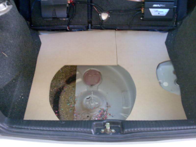

                              • Got stuck into the rest of the boot false floor on Saturday. Got most of it done so pretty happy now!
                                Heres some progress pics throughout the day incase anyone wants some ideas etc etc

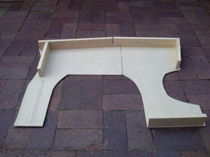

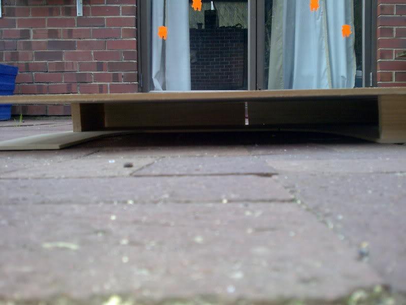

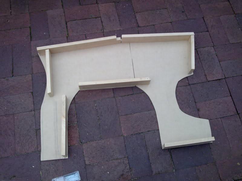

                                Made the top section first out of some 9mm MDF. Spent a while measuring up the exact sizes of eveything and getting it to fit with the back seats upright. Took a while but worth it!
                                Then set about making the raised sections on the bottom base. I used 70mm heigh wood (cant remember what it was exactly, but nothing too heavy or expensive!)
                                Checking now and again it all fitted ok in the boot, cutting and modifying parts of the carpet so it sat nice and snug!
