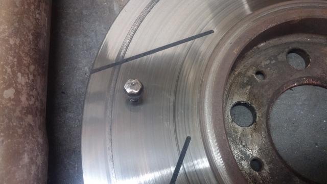

I've had a slight metallic rattle coming from the front of the car, I assumed the heat shield but no luck on tightening that.
but narrowed it down the other day when I had a huge scratching noise from the front left wheel.
turns out the brake rotor dust shield had all 3 bolts loose, one had actually backed right out and been rubbing on the rotor (I assume the louder of the noises).
tightened all 3 and all sorted
