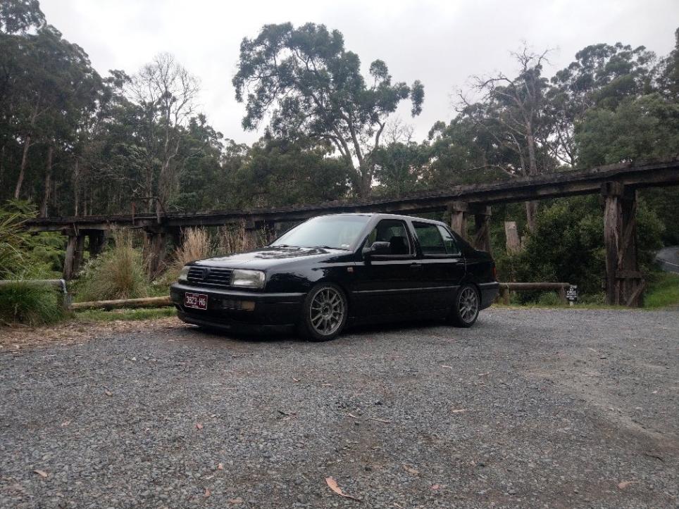

    16x7et30 superleggera with a 205/45 re003

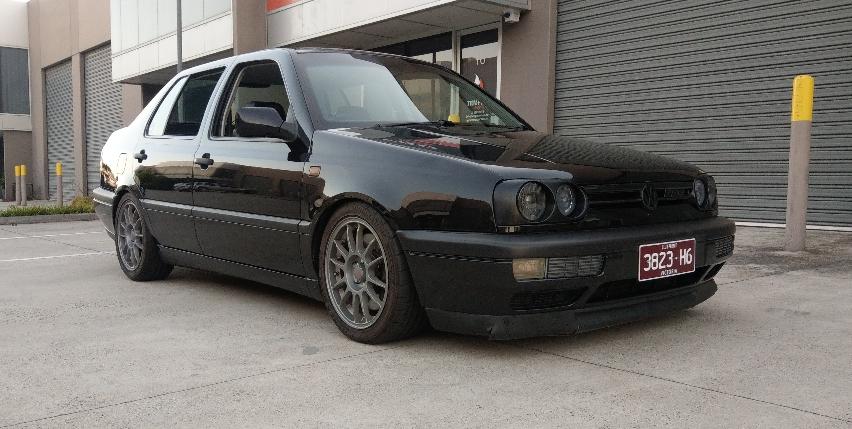

        Was getting dark but grabbed some slightly better pics.
        Desperately needs a wheel alignment but steering feels better already

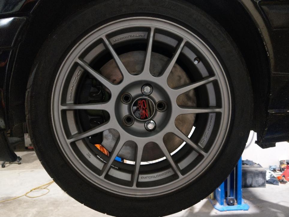

                Finally slapped the 312mm on the front.
                Currently running green stuff pads with generic rotors but hoping to find some lighter rotors (prob 2 piece) to try and match the weight of the 288s I had on previously.

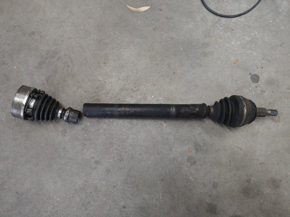

                  A covid19 lock down or two ago waterboy and madglf3 came to help push the brake pedal and turn the brake bleeder nipples.
                  Rear bias backed off and supports under the beam
                  Brake pedal feel was the best I think it's been since I have had the car. Rolled it out ready for a shake down and pad bed in session, casual first to second gear change and no power...
                  Pushed the car back and couldn't spot or hear any problem, freaking out clutch or gearbox input I wanted to cry.
                  Went over some stuff, not much luck, about to give up and then noticed a tiny bit of day light showing through the drivers shaft.
                  This was the result...
                  No idea why there was no rattling or banging or horrible sounds. Made me completely overlook driveshafts.
                  So much abuse, pot holes, hooning and driving at speed and then it lets go just rolling at walking pace.
                  Sourced a used oem shaft, going to give it a refresh and fingers crossed can hit the road.

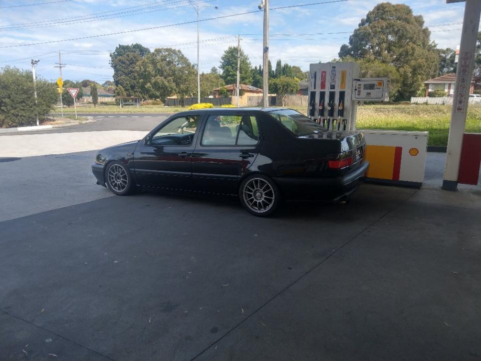

                              • New temporary wheels
                                OZ racing futura monoblocks, I feel they have another name but can't recall
                                17x8 205/40 17x9 215/40
                                Need to lower the front a smidge.
