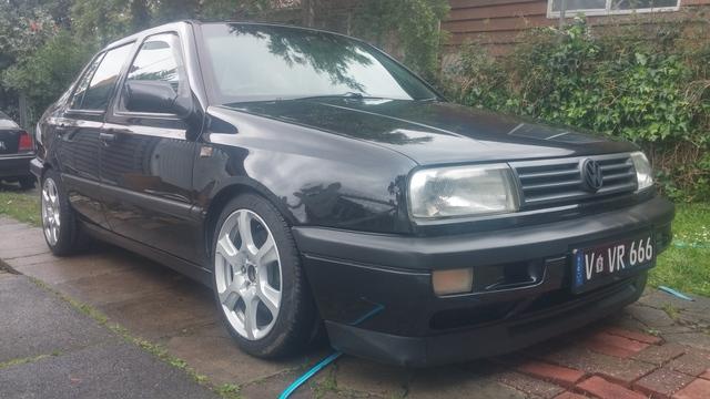

thought id throw the audi wheels on, only to find they rubbed on the rear bumper under load and turning.
some quick adjustments were made and the rubbing was reduced to hard cornering, big bumps, and hard acceleration.
next wheels should be 5mm less aggressive in the back so should be enough to clear.
fronts are up next and to space the audi wheels out 5mm more, will end up with
16x7.5et25 205/45
16x7.5et20 205/45
