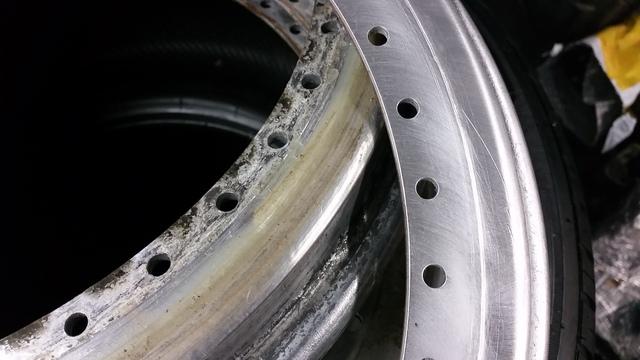

started working on one of the first sets of wheels for the vento too.

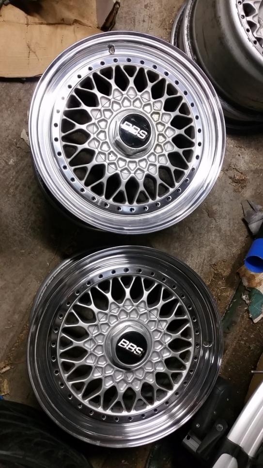

bit of a teaser of another set on the way
