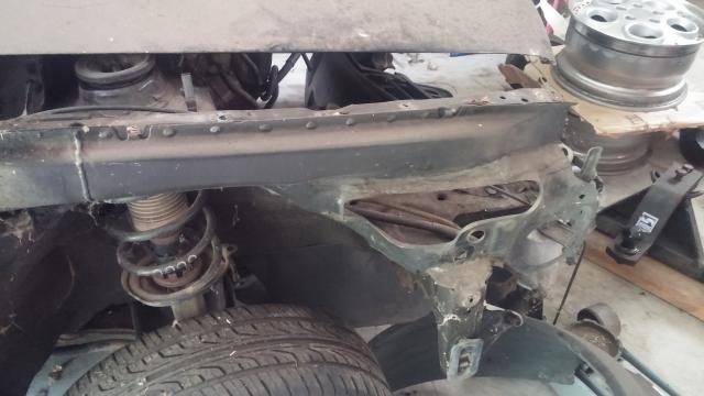

              • Golf has been 95% stripped. Just waiting to organise scrap pickup when I'm home next.
                Here's a reason I didn't feel bad about wrecking it
