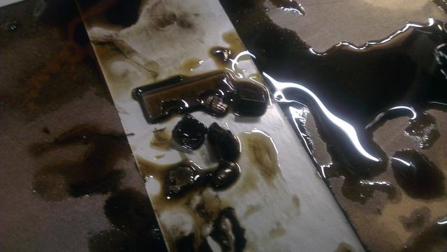

                            • R32 sump back off.
                              found out I needed to drill the baffles also to clear the dipstick.
                              gasket off
                              resealed, seems to be holding oil 1 week on. will see once it gets some heat into it
