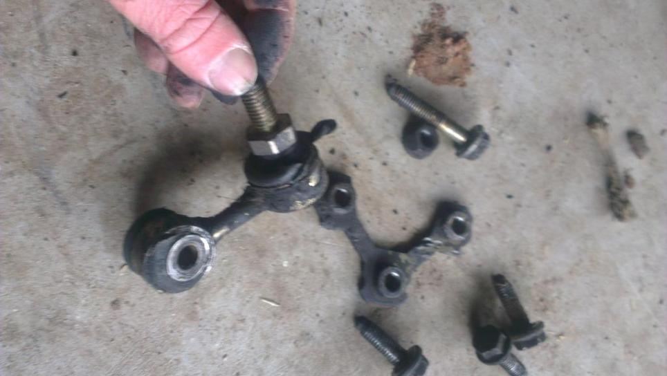

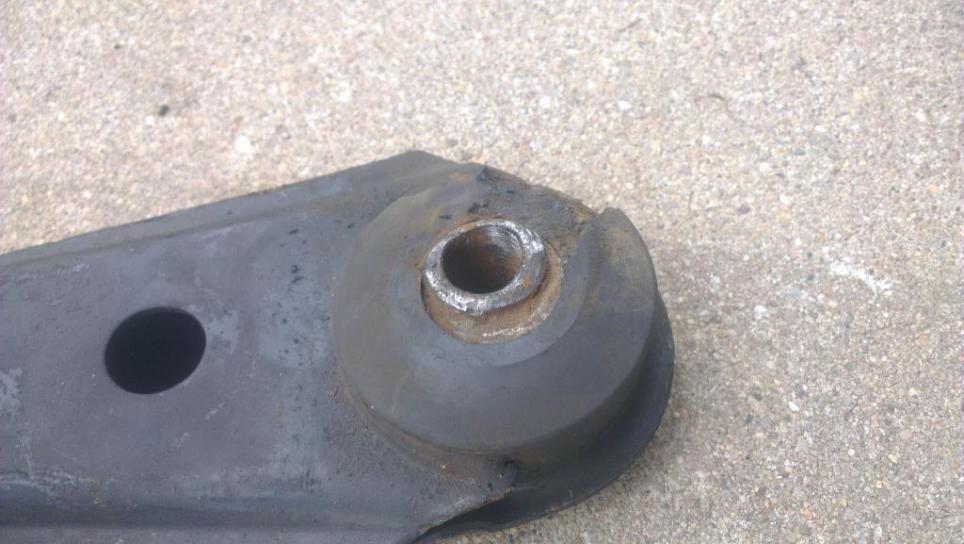

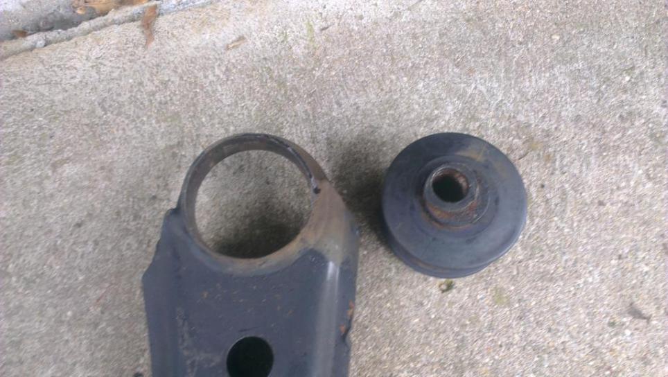

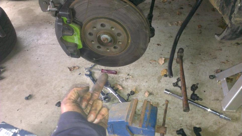

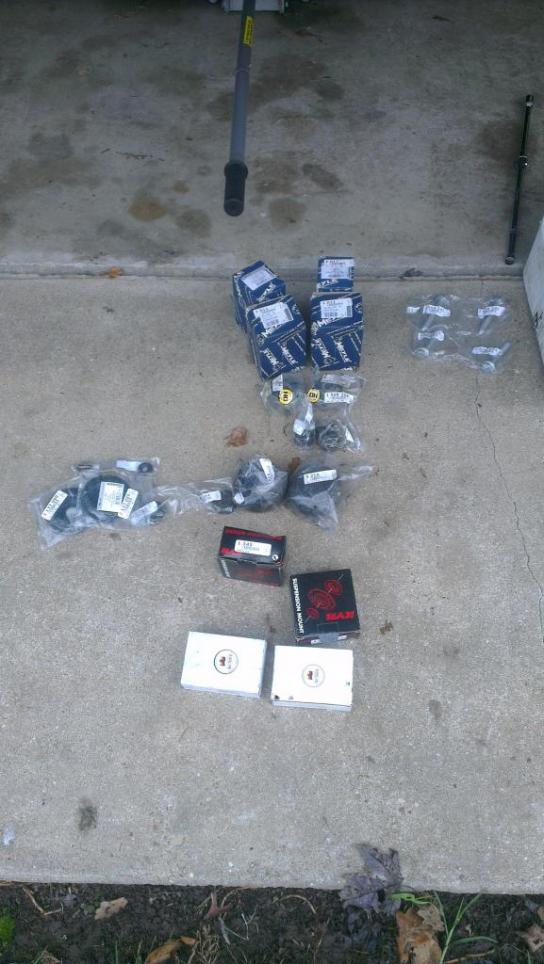

          • So r32 bushes in the control arms. Found out there was already some poly ones fitted, fronts were ok. Rears even had off centre holes, but passenger side was dead.

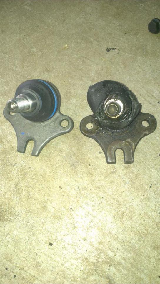

            Replaced the sway bar links and ball joints too. Wow ball joints are a nightmare to remove without the proper tool or removing the spindle from the car.
            Found the passenger side link was loose so hoping between that and the new control arm bush it stops the random clunk.
            Tie rod ends look ok so left them, saving the strut tops and bearings til I get coilovers so hoping they will pass roady as is

            • What did you do to remove the ball joints?
              • carefully placed swing of the hammer
                Bora gone
                Vento VR6
                MKIV GSW TDI
                7P Touareg TDI
                • Yeah haha, been there done that. Usually I thread the nut on a couple turns so if you do miss, you won't damage the thread
                  • new bits
                    dead sway bar link
                    old bush out (ok condition drivers side)
                    not so pretty passenger
                    raging trying to get the ball joint out (attempted to press it out using a vice)
                    can you spot the old one...

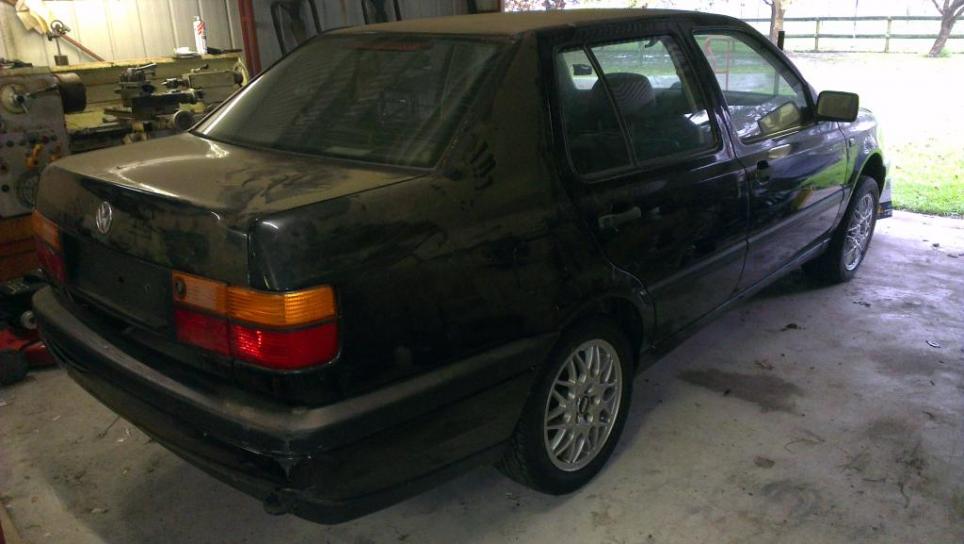

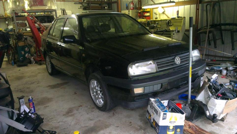

                    Heres a shot of the Golf before I started pulling it apart.
                    engine bay has come a long way

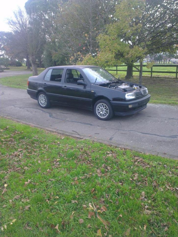

                            Not much happened today.

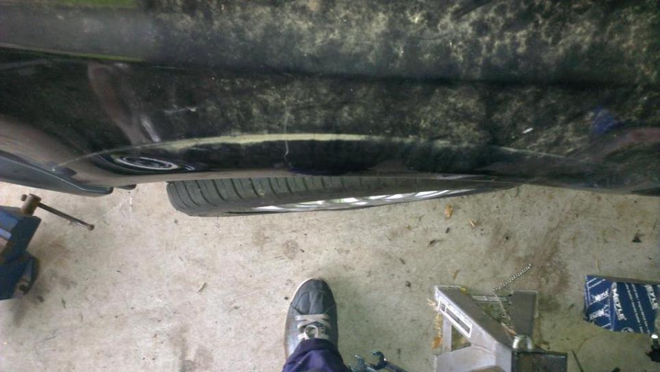

                            Tightened everything up, wheels on, played with the engine mounts as it doesn't seem to be sitting on the passenger side mount.
                            Bonnet got a wash in the 24hrs rain
                            Plenty of toe out and positive camber thanks to the new parts
                            How I left it
