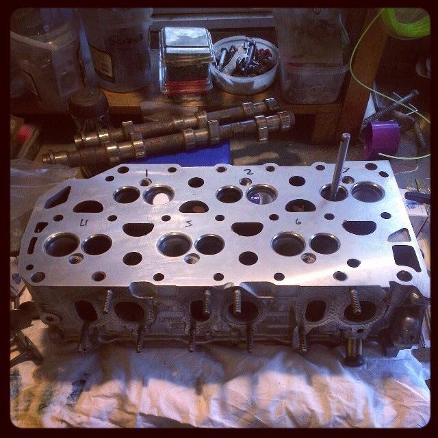

                      • One for mk3 aaa, seats cut and cleaned up, 60deg cut also done.
                        Tomorrow will do a 20deg (think that's what it was) and reassemble

                            30 deg cut done, valves lapped in. Just need to give it a clean out and reassemble now.
                            Thanks to Golfman for the help and lessons!

                              • Mmmmmmm that's some tasty sheit dylan, home built too, extra points rite there!
                                Did u do the port work at home as well ?
                                Haha hope your machinist is having fun clearing that block.
