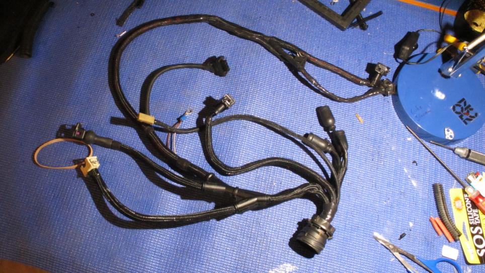

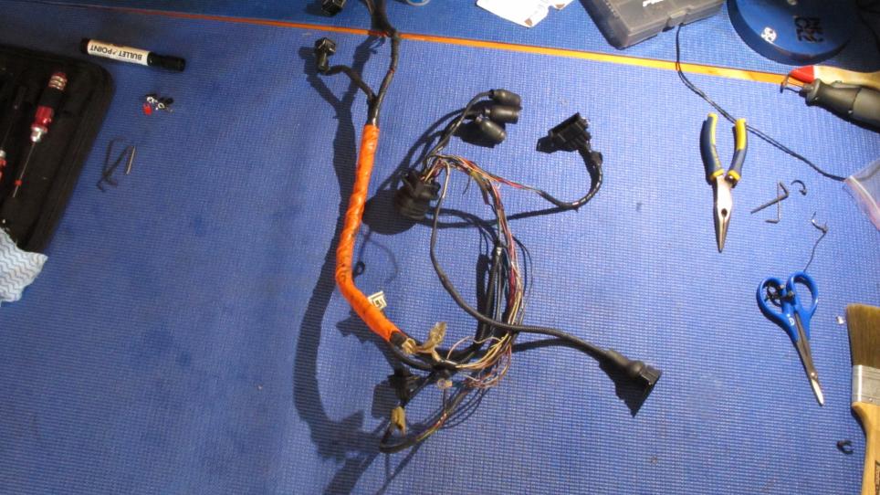

Its another CPS playing silly games with me... So I took another look at wiring and cleaned up behind the T28.
The CPS failed when up to temp again, so its one more CPS before I assume theres something wrong on the flywheel.
I'd used spiral wrap and it melted behind the head. This was a while ago and I wrapped in linen and strapped in Silicon Tape. It held up well and after a few fixes with soldering iron, it was rewrapped in Silicon tape and put back nice and tidy. Sadly, the Implausible G28 signal remains.
