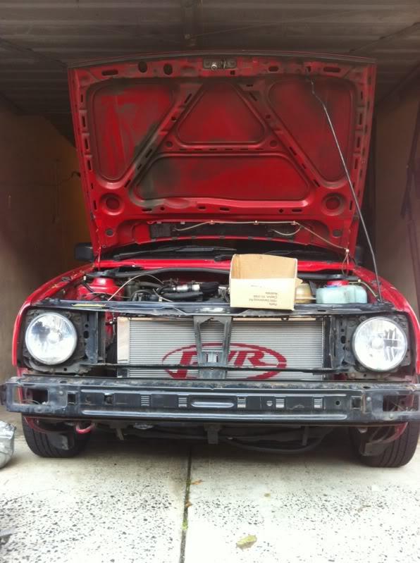

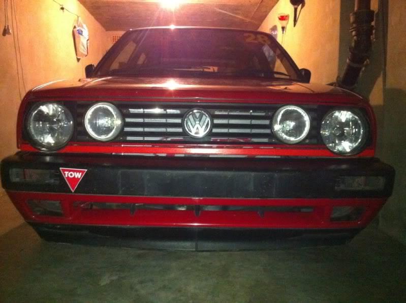

          New grille
          • #65

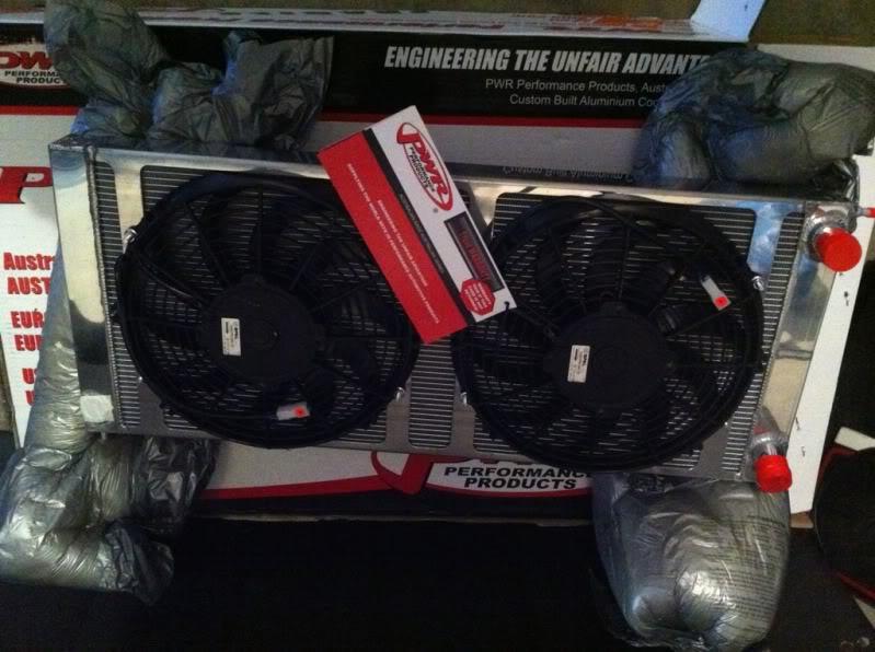

            New rad...
            If anyone is interested in PWR radiators, they now have radiators for mk2 golfs in their system thanks to me... had to be drawn up from a sample I sent them.
            Will let u know how I go with the install.
            • #66
              How much are they? Can they make them with the overflow tank on the side?
              • #67
                They can do re design it to how you want, shouldn't be an issue.
                • #68
                  Prices as pictured for your info:
                  Custom build radiator $957 (all including GST)
                  2x11" SPAL fans skew blade $429
                  Freight $77

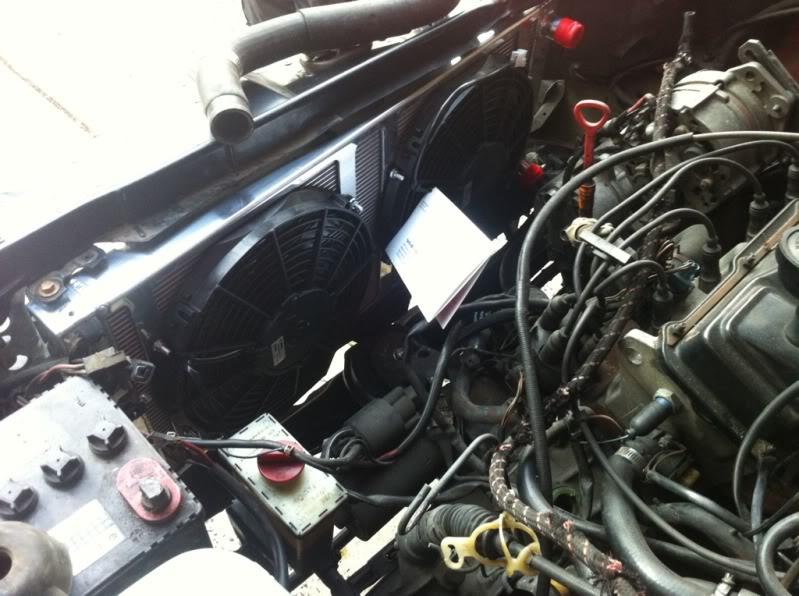

                  • #69
                    Awesome!
                    The slimline fans really tidy up the engine bay, they must free up alot of space too?
                    HAHAHA
                    • #70
                      Originally posted by ryana89 View Post
                      Awesome!
                      they do, so much room, the oil filter can be accessed quite easily.
                      Tonight's progress:
                      Before:
                      After:

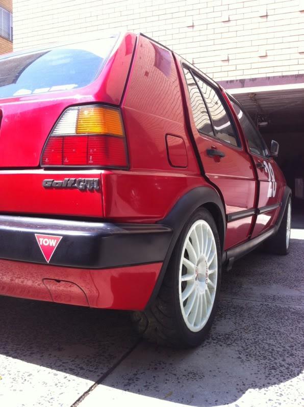

                              yay you got the wheel on!
