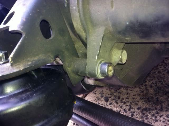

      Thanks waterboy. Re the pulley, do I need anything else other than a new belt? Can the alternator belt run off another pulley, as it looks like that pulley comes out when the compressor comes out.
      • #33
        Question for you guys, according to a printout from VW, these allen key screws should be screws, can anyone confirm?
        Cheers
        • #34
          no allen key on mine can confirm that for you.

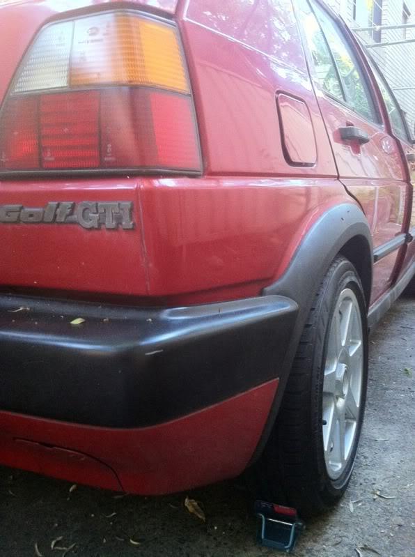

          • #35
            Don't get me started on the allen head screws, I had to grind off 2 of them from the rear brakes because they were threaded.
            Seriously, why didn't they just put in normal bolts!!!
            • #36
              Thanks guys. I have a feeling these Allen head screws are the cause of my violent shudder when taking off, not the engine mounts...

                  • #39
                    Cheers
                    They are 8mm triple square bits- (multispline) from memory.
