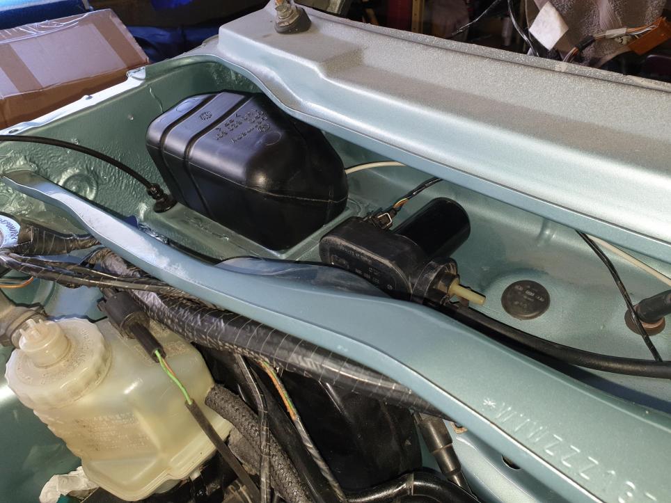

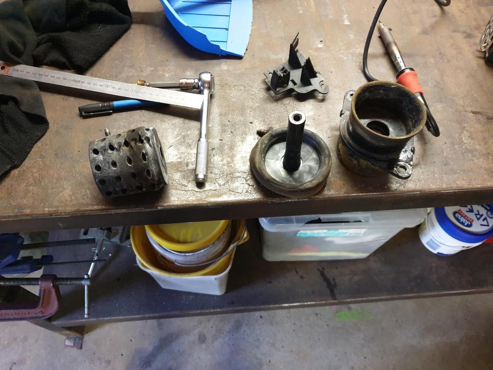

Coolant mount change over today. Forgot to weld this in before I painted the bay. Remove the mk2 mount by just cold chiselling the spot welds to break them. Treated the rust and applied some paint over the bare patch. Took the VR6 coolant mount off and tidied it up. Put some rivnuts in the strut tower and just mounted it on! Allows me to mount the radiator fan control unit too. Just gotta get me a new bottle now coz this one yuck.
