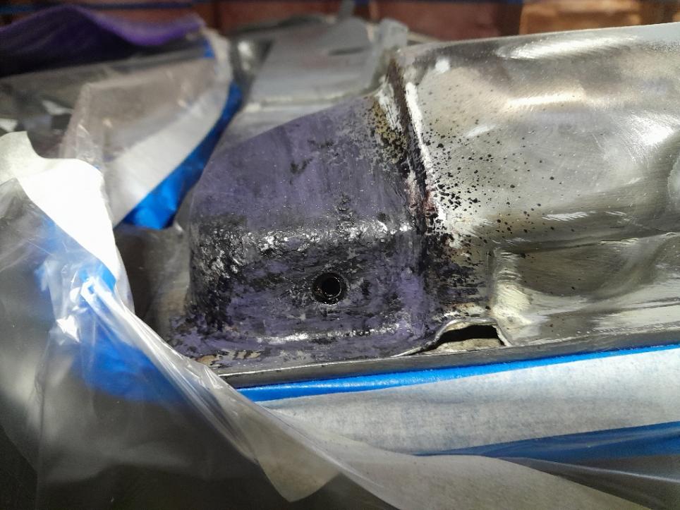

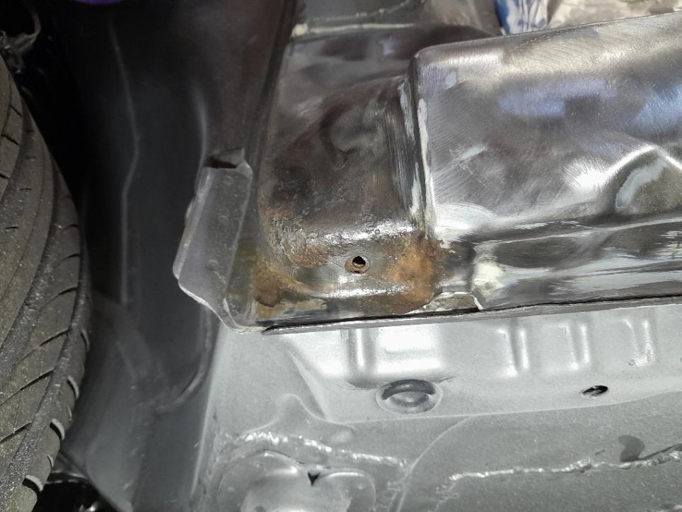

          Bit more stripping. Patches of rust on the lower sills, take it back as far as I can with wire wheel then use a rust converter that converts to a ferric tannate. Good for painting over. The area hides under a wheel arch trim so not too fussed about cutting it out. Excited for all the painting to be finished! Got a few goodies coming in the next few weeks from UK, new bumpers, grill, lights, BMC air filter and much more to give it a good finishing touch once painted

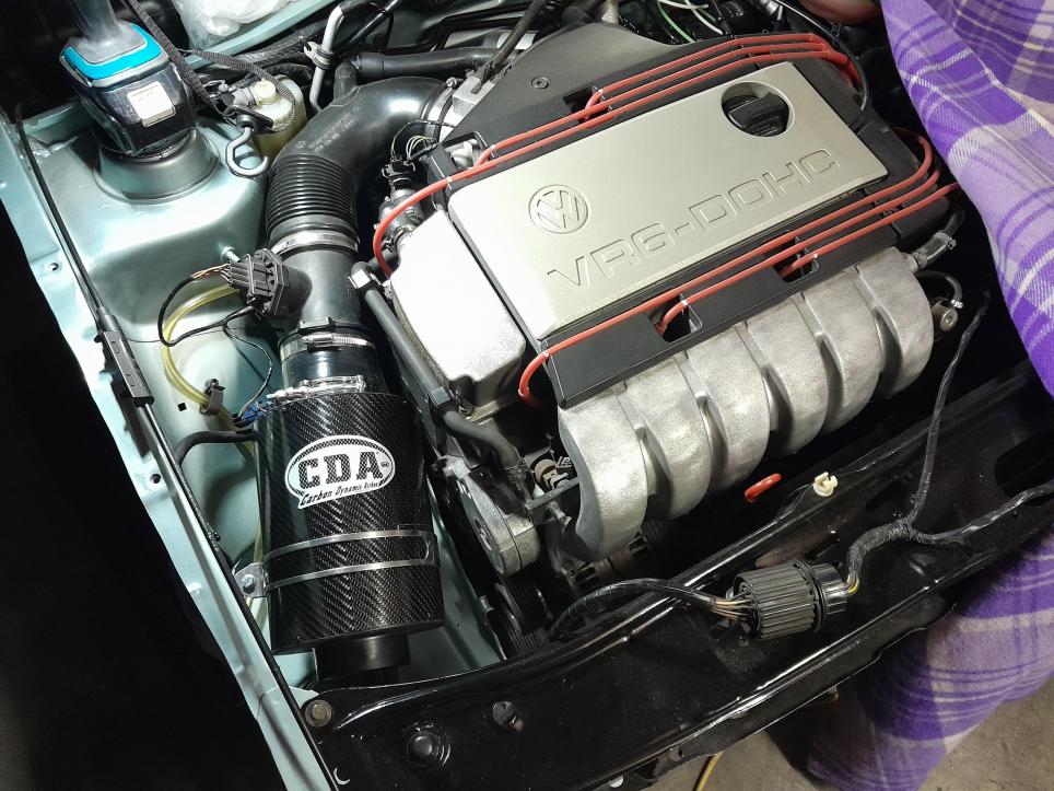

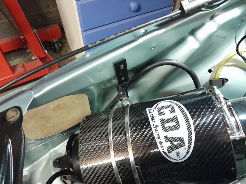

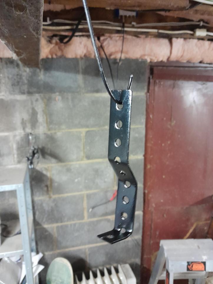

                BMC CDA filter fitted, looks awesome. Haven't started the engine yet but have heard they are one of the best sounding filters for the VR6. Stock mk2 filter box was too small to fit the maf housing, mk3 box was too big to fit the bay and trying to find a Corrado VR6 box was too rare to find, especially trying to get someone to ship one to Aus.
                Had to buy a 3.25" tube to fit it to the maf housing. Kit came with a bracket which I bent into shape and gave a lick of paint. Fits well, looks great and hopefully worth every $$ I paid!

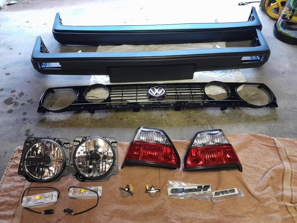

                • Update: 08/09/2022
                  New parts!
                  Sent from my SM-A135F using Tapatalk

                  • looking sweet mate, keep the photos coming...
                    • It's the little things..

                        • The BMC does sound juicy!
                            I did start it up and flatten the pedal, got some good intake noise!

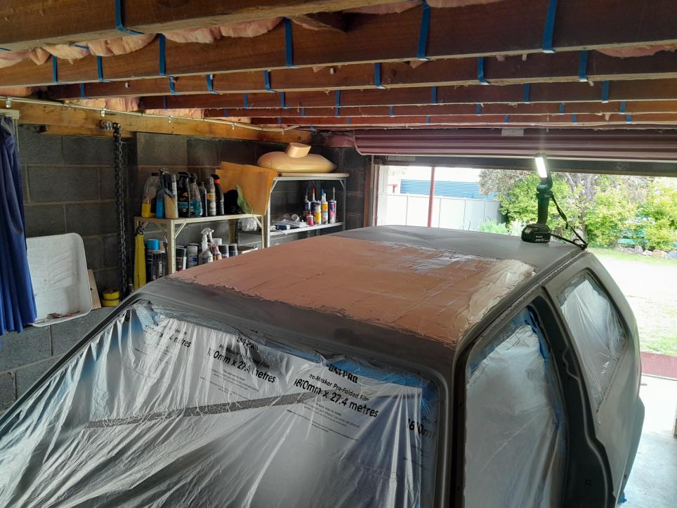

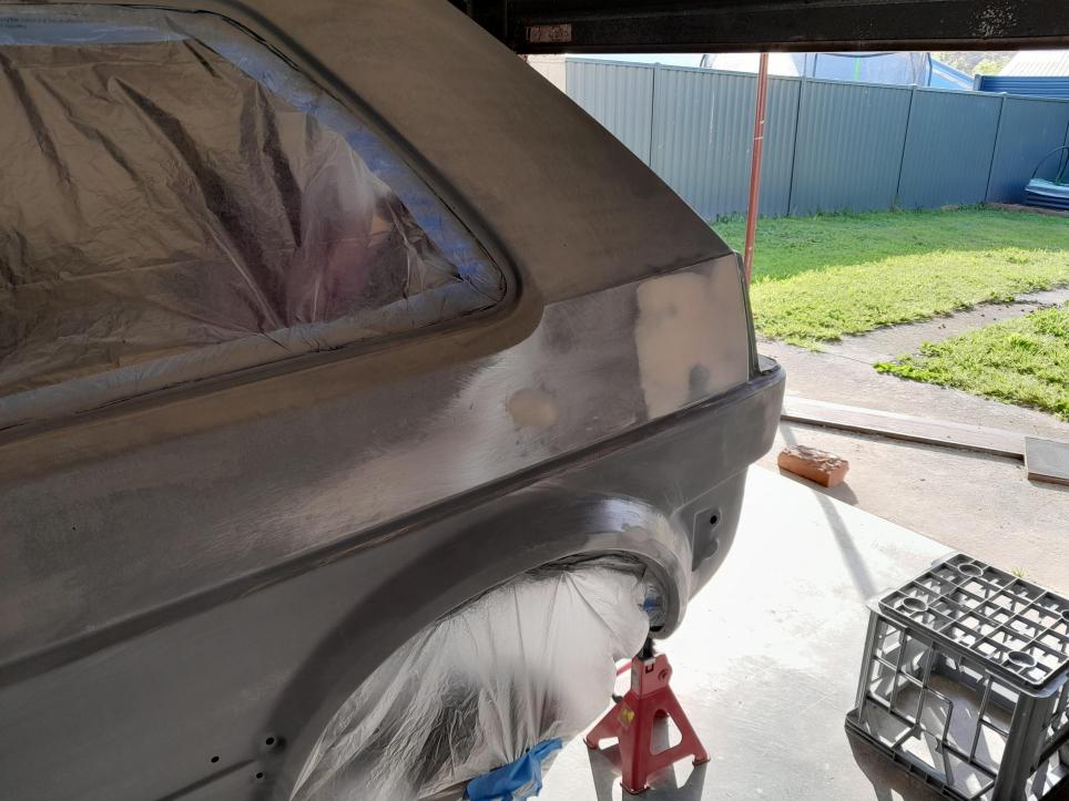

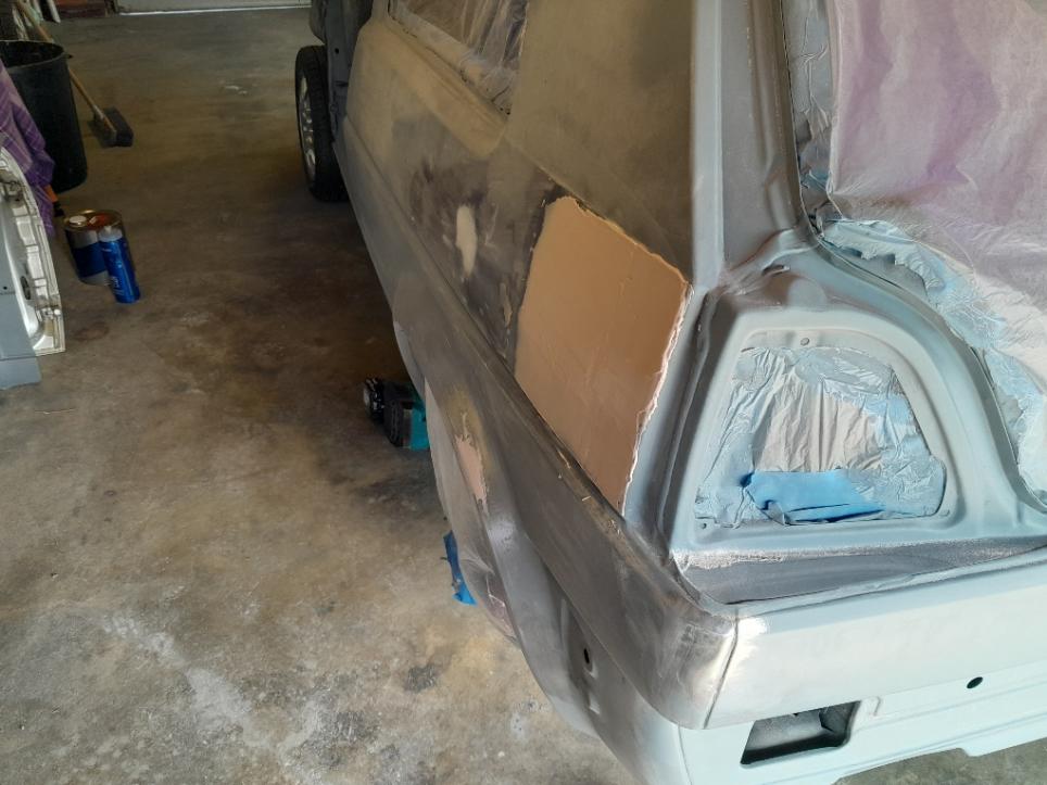

                            • Update: 02/10/2022

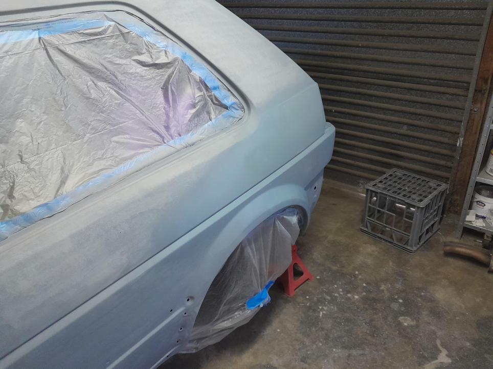

                              Strip, bog, sand, paint, repeat. Everything fixed up now but the roof, lots of bog required there. Then hopefully can get into my first layers of primer filler next weekend. Very excited

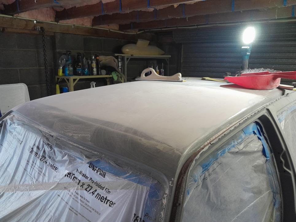

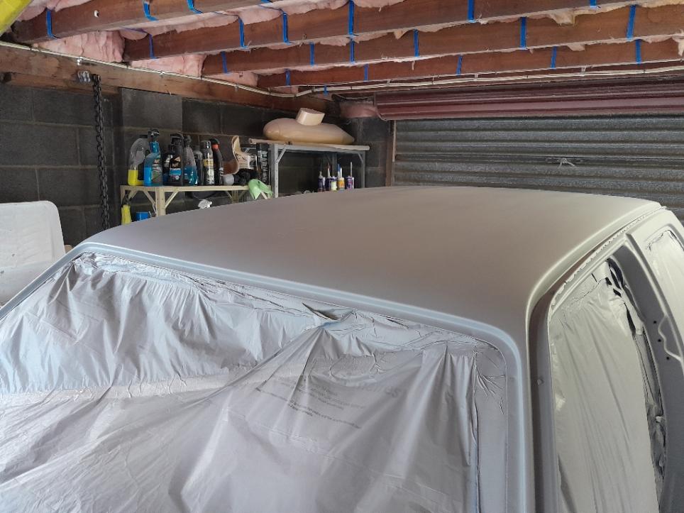

                              • Update: 07/10/2022

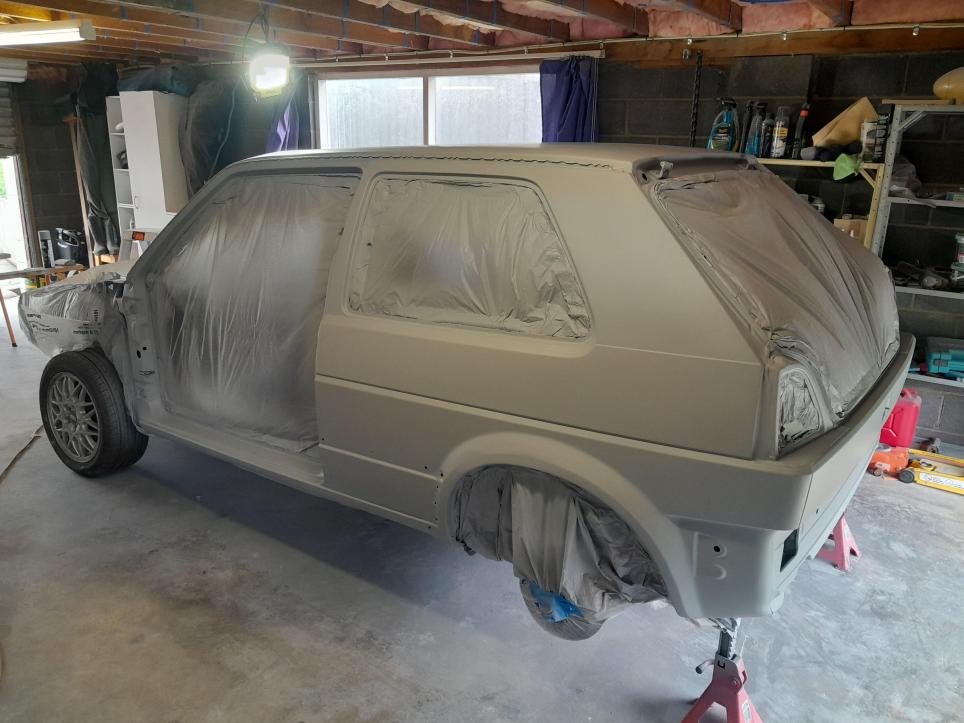

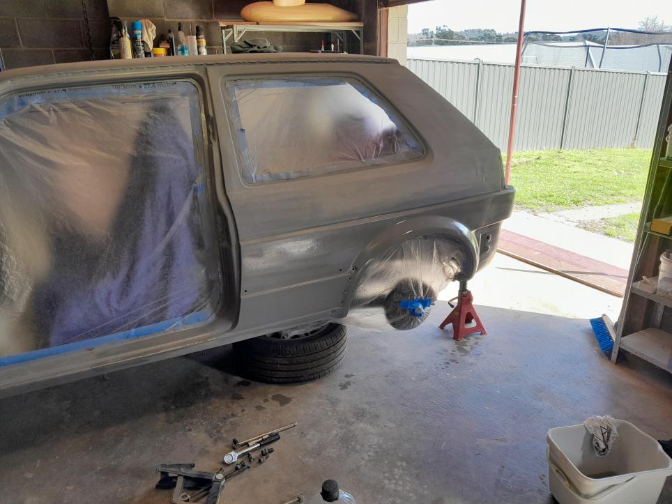

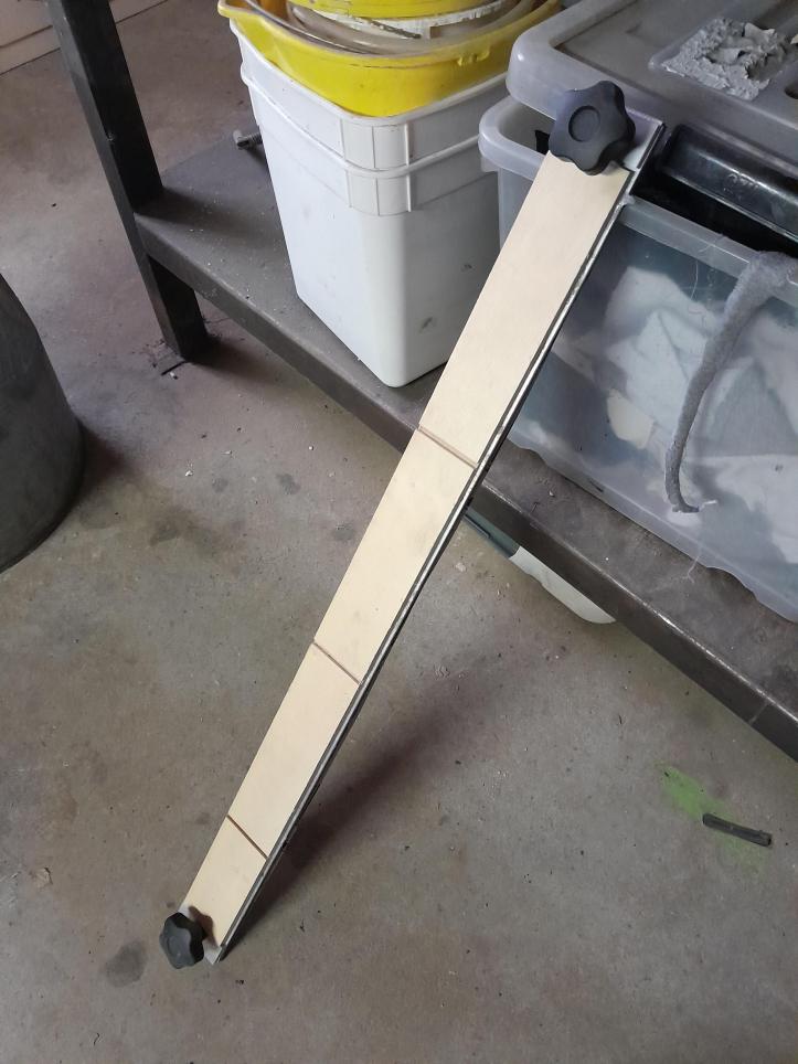

                                Wow what a week. The roof was an absolute tester for me. Used over 4kg of bog and took off probably 3kg to get it right, the lowest point was about 3mm of bog and all high points had been hit down. I made a longer speed file sander to help with sanding the large surface, worked a treat! Many hours were spent getting it straight, fair to say my arms are wrecked...
                                Followed up with a lick of 2k primer, now ready for a good sand! I am well pleased with how well it has all turned out.
