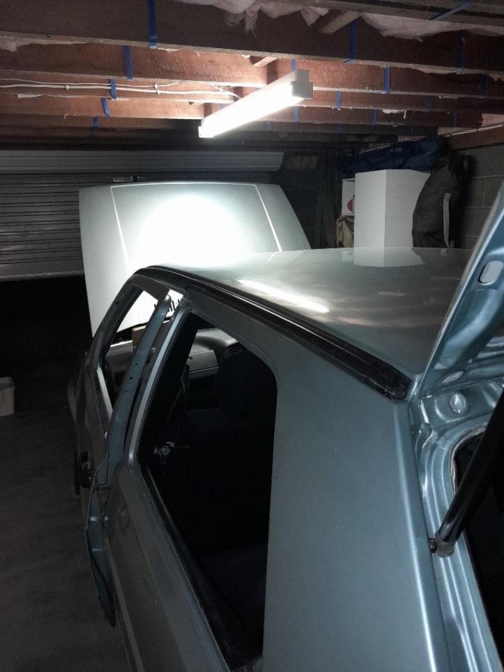

    Haven't given up but boy its hard to finish this thing off. Bonnet, roof and passenger side all sanded, cut and polished. Trying to sand the 2k clear really gets the arms pumping, especially starting at 1200 grit and working upto 2500.

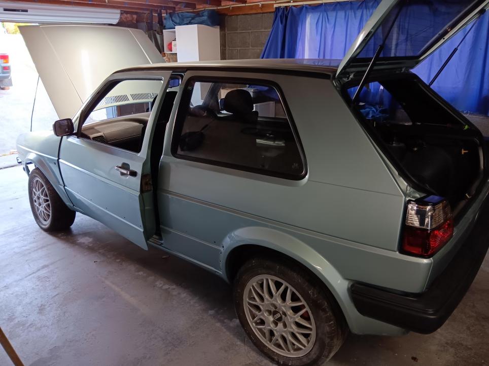

      Andddddd... the car is now done! Got some rub throughs around drivers door which was a bit of a bummer but its over. Have to stick the badges on immediately of course... [emoji2956]

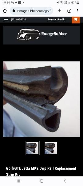

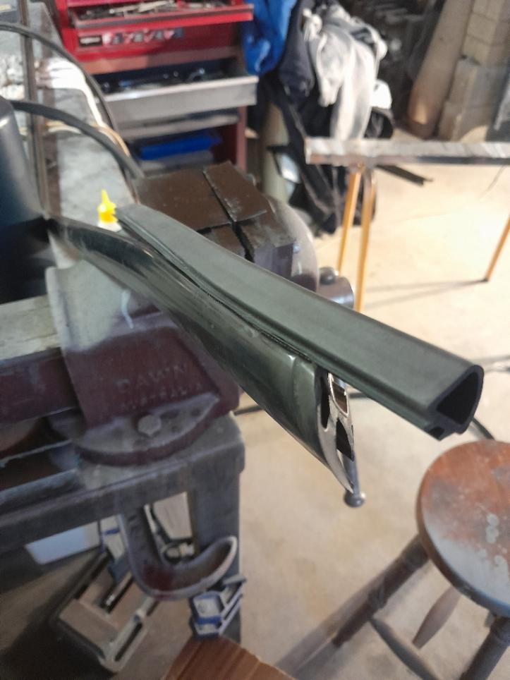

            Fixed the rain gutter trims tonight by gluing brand new soft rubber to the original hard plastic bodies. Can't say I was overly impressed with gluing the $350 worth of rubber I had to buy from the US as a repair kit as the profile didn't really seat very well to the hard rubber. Bit stupid tbh, but we all know that trying to find new or even good condition used gutter trims is next to impossible. They look ok in the end, would much rather the whole thing just be brand new.

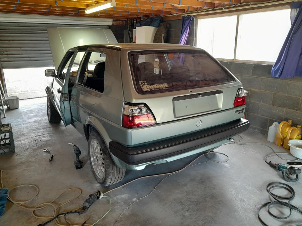

                  Rear window in, as well as a bunch of other rubbers. Still got the OzEdition sticker on the rear window! Slightly peeled but in pretty good condition, used to be a small following of VW enthusiasts in Tassie I believe? Hopefully someone knows a bit of its history!!

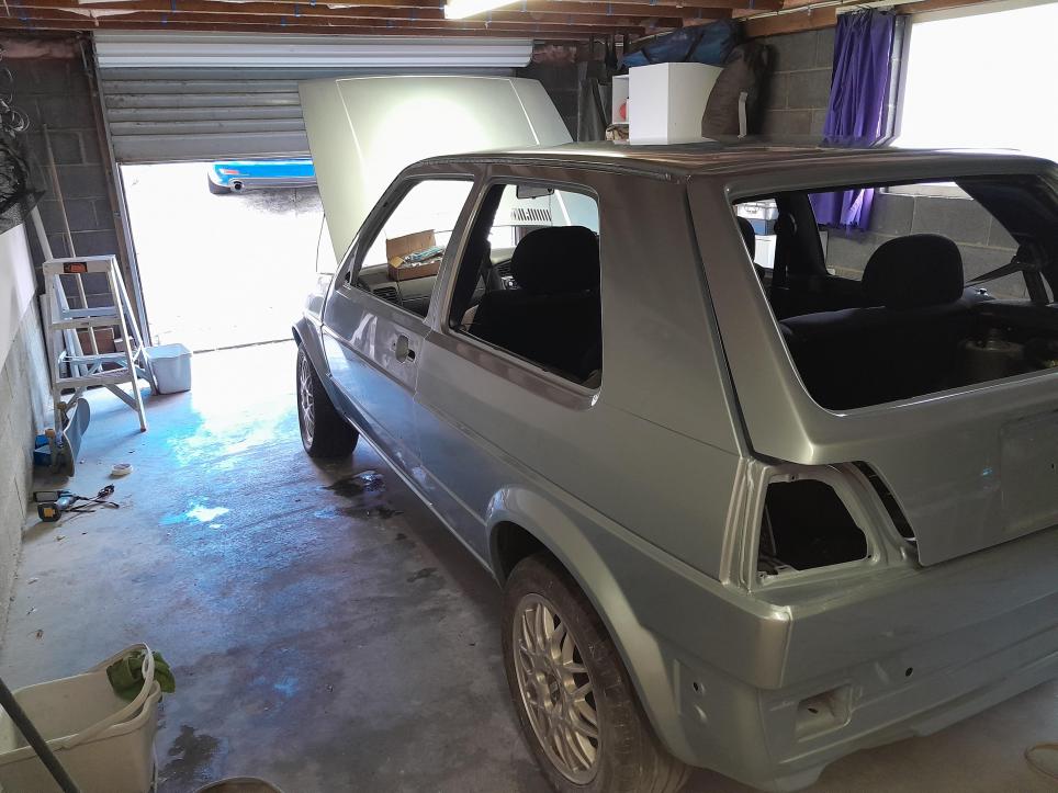

                        Long time again, no golf. Life got a bit complicated so haven't been near the golf but I'm back. Rear windows in, slowly getting closer now... hopefully a bit more work over the coming weeks
