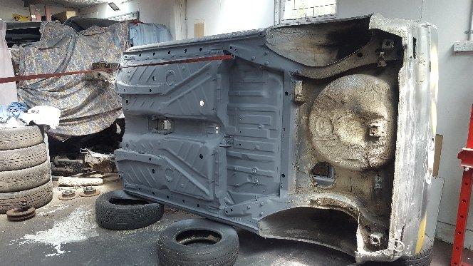

    First start was getting engine bay cleaned up. Took a lot longer than I thought, only getting areas about 300x300mm completed in like 5 hours. Started with wire brush, to sand paper, to little wire wheels, to the large wire wheels on a grinder which helped a lot. About 2 months later finally got it done. Had some rust issues under battery which seems common and so cut it out and patched it. Will neaten that up for when body goes in for spray. However, all metal has been deoxidised and converted and then primed over so no rust should continue.

    Rolled the car over onto its side as, unfortunately, I do not have a rotisserie, took off all suspension and brakes and made note of what parts need to be ordered. I bought a full poly-urethane bushing kit and pretty much new discs, pads, front calipers, tie rods, rubber boots, wheel bearings, ball joints. A lot really. Thanks to VW heritage for that, pretty cheap stuff.

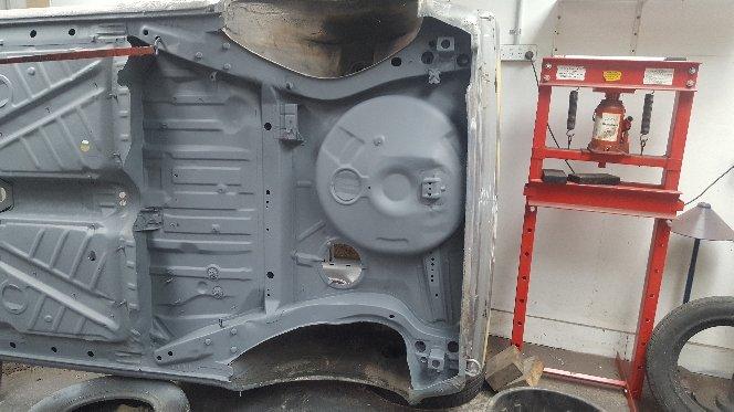

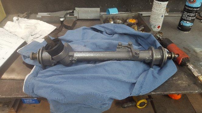

    Current stage I am at now is shaving underside. Heating up the deadener and scraping it off. Found rust on a jacking point so did some cutting and welded back in place. Not fussed how it looks, as long as it is strong. I have also been respraying control arms and front and rear subframe with some rust proof enamel to make them look like new. Have resprayed steering rack, not gonna bother with putting in a power steering one (I have one on my parts car), too many things to replace. And plus more stuff in the engine bay.

        How’d the panels hold up to being on the side?
          Its all on tyres, haven't looked at that side since its rolled over but the tyres are pretty much under the bottom edge of the door and to stop the car rolling any further its just held by ratchet straps so it hasnt really got any stress on any panels or near the roof.
          Best option as we have no hoist in the shed.

            Steering rack sprayed in hammertone, no play or wobble in it so didn't have to rebuild it. Will have pics tomorrow of the progress on the underside.

              Got a bit more undercoat on today. Only around the spare wheel area to be done before putting suspension back in

                You might want to reconsider using a power steering rack. Makes the car much nicer to drive and should be easy to find one, all the Aussie 4 door MK2's have them.
                  I do have one on the parts car, wasn't planning on going through the hassle for doing it as the car seems small enough it won't matter. But I'll reconsider now
                  Sent from my SM-G920I using Tapatalk

                    2 days to finish the area around the spare wheel. Was nothing but a headache but its done. [emoji42]
                    Wheel arches to be done next weekend
