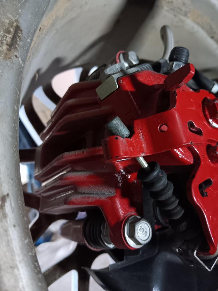

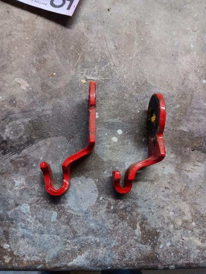

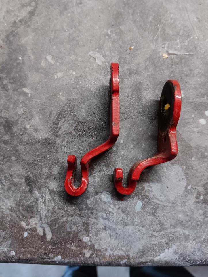

      • Update: 16/06/2023
        Finally fixed my handbrake. The mk4 rear calipers are too big for the mk3 handbrake cable end to sit in, I attached a pic of the difference. Had to unbolt the mk4 mount and bend it in so it matched the mk3 caliper mount. Nothing exciting really [emoji1787]
        Cheers

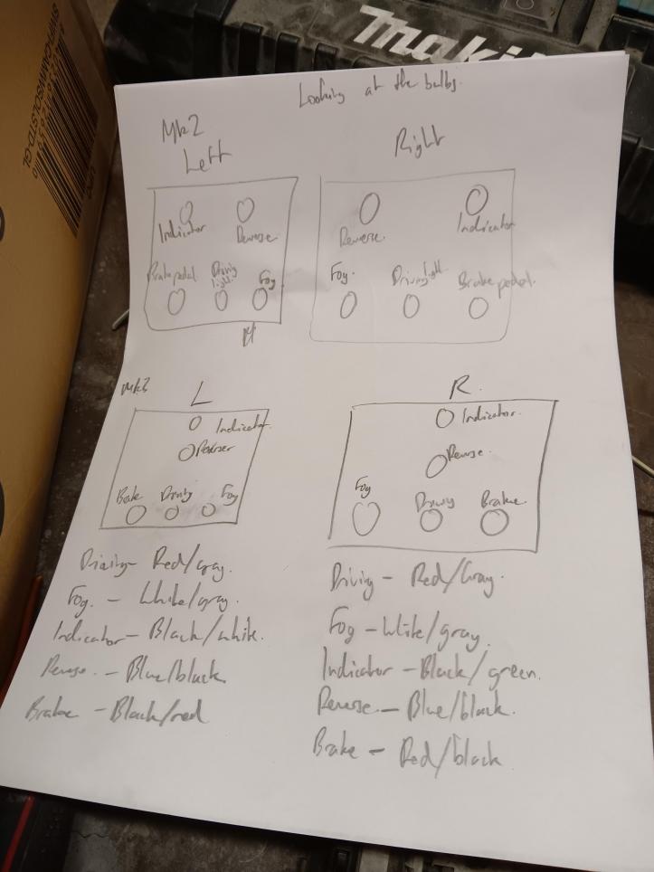

        • Update: 30/06/2023
          So begins the tail light swap over. As I have the VR6 wiring loom in the whole car, I had to figure out which wire goes to which part of the mk3 tail light, then convert that over to the mk2 tail light. Done my little drawing, now I just have to chop the plug and solder away...

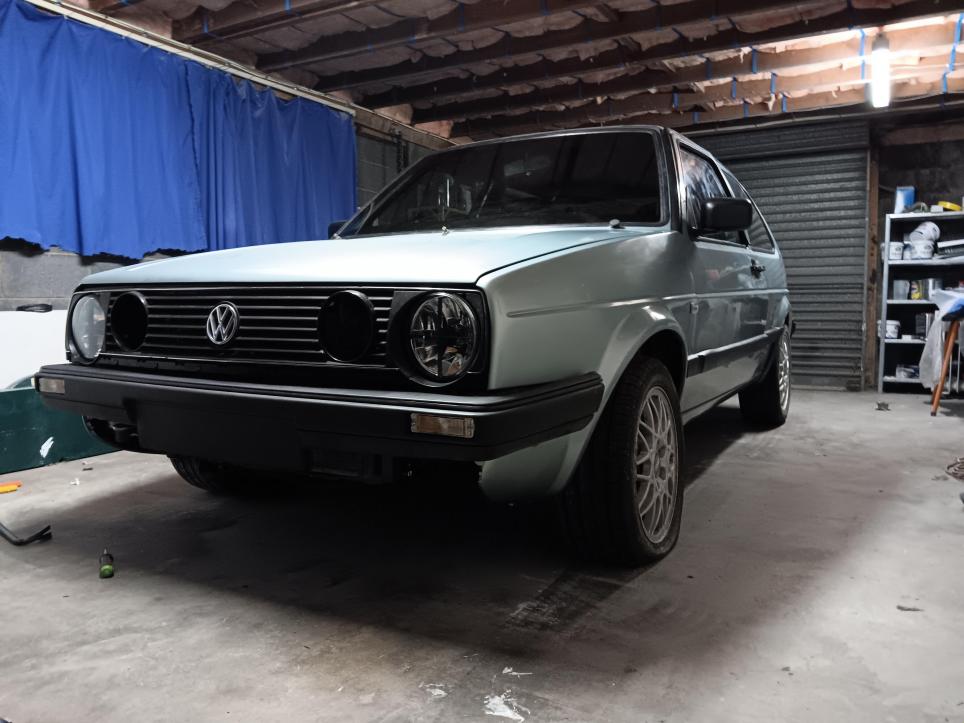

            • Its the little things... Plastics fitted on, reused old ones coz I'm broke, just gave them a dye first. Also caught a sweet shot of the car outside the other day

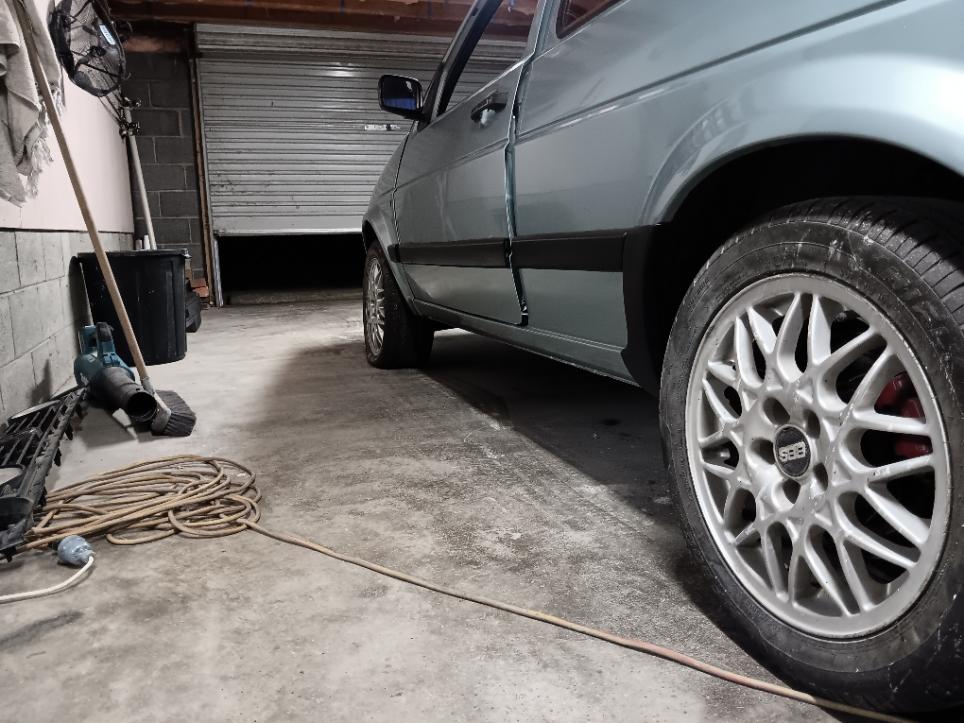

                  • Update: 24/07/2023
                    Windscreen in yiew! All the glass is now back in, got some new window regs for it as I was missing them. Just need to tidy up the front end now, tinker around and get the door cards recovered then this thing is getting seriously close to getting back on the road wow

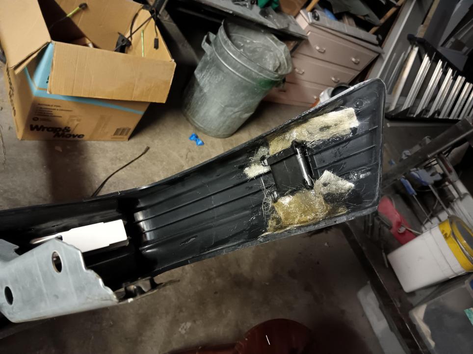

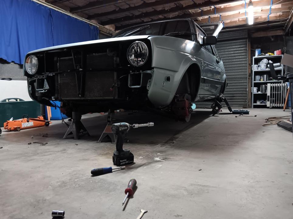

                        • Update: 31/07/2023
                          Stupid junky rubbish aftermarket bumpers. The side holders that pull the bumpers back in to the quarter panels just snap so easily, absolute junk quality. So just slapped it up with fibreglass, should do the trick now. Also snapped the welds that held the captive nuts on too so rewelded them as well. Definitely not worth the money at all.
                          In the mean time, wheels are off, getting them ready for a lick of paint...

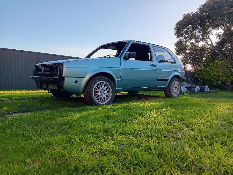

                          • One step closer to getting it back on the road. The "to do" list must be down to one page now.
                            • I think so! Extremely close, and not too much money to be spent as well which is always a relief, just tyres and a new battery.
