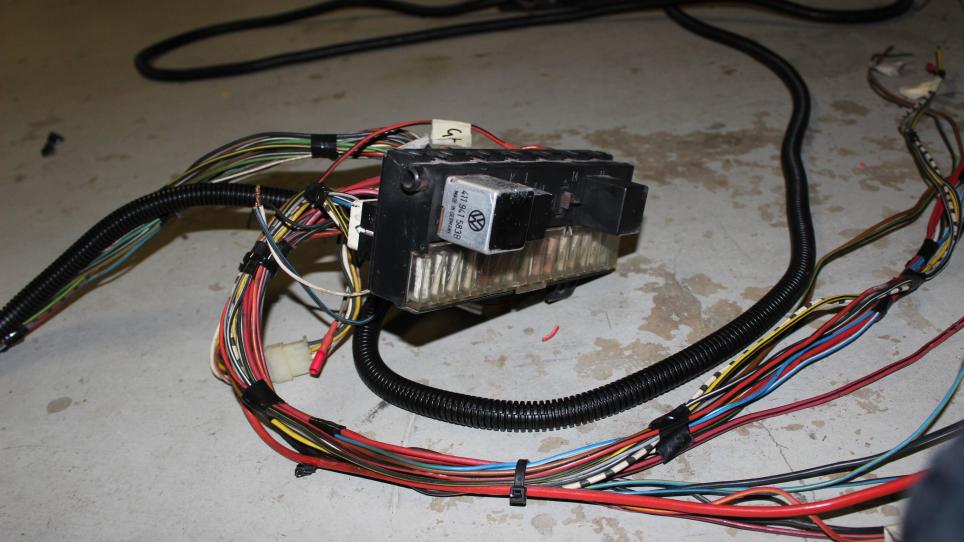

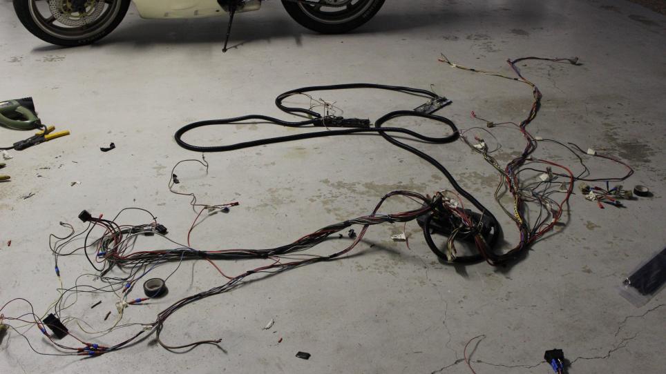

                      Little more progress, definitely only a small chunk but i thought i'd upload some pictures anyway. Started getting into the loom side of things! As simple and easy as it is, it sure takes a while to get everything in the right order and clean. Well worth the end product however. Bought 10mm split tubing for all the rear and little bits but also need to buy 20mm for the loom that will be running through the passenger guard to the engine/lights and also for the cables to the dash and cluster.

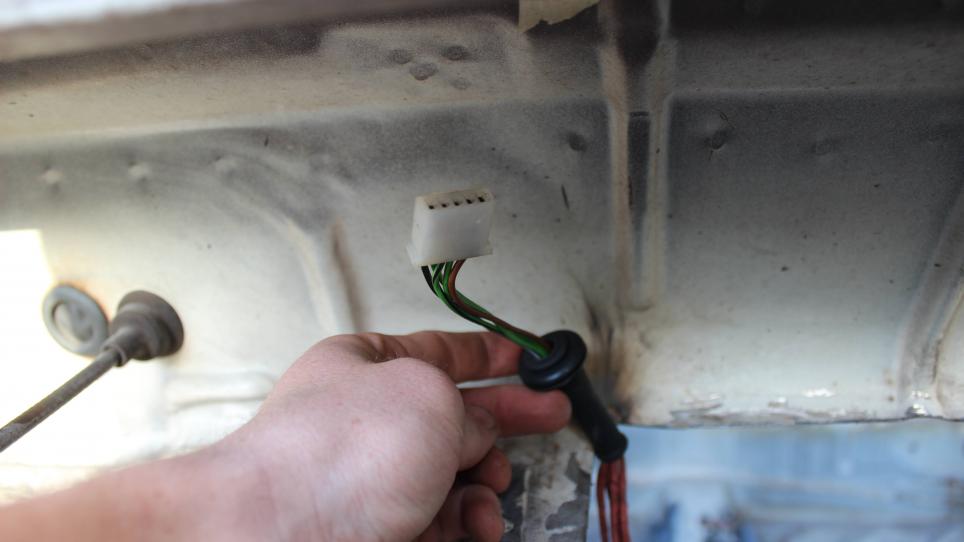

                      I diy'd up this grommet that will be taking the wiper/washer pump motor through the top firewall

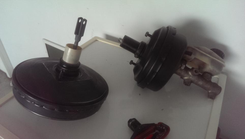

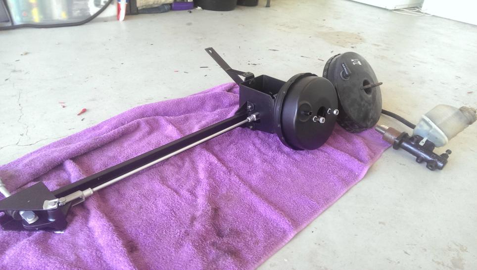

                        Scored a mk3 booster and vr6 mc yesterday off Ben J (Thanks dude!) Welding the mk1 booster rod onto the mk3 one is all that needed to be done, the actual booster bolts up perfectly with the bracket. I did mount the whole system up along with the pedal box and steering inside and it all works.
                        If anyone needs the original parts and is Brisbane, come pick em up for free !

                            You do know you can replace the bar (and gazillion pivots and linkages) that goes from the brake pedal across to the master cylinder with a single solid bar? Gives a much more solid feel to the brake pedal and less moving parts to wear out/worry about.
                            • #89
                              Whats the best way to go about it. Got any pictures? I went and had a look and mounting on the left side doesn't seem possible as its abit to large. Interested in other options though
                              Its the little things..
                              • #90
                                I too am interested in this, I'm just struggling to visualize what you mean? I picture sure would help
