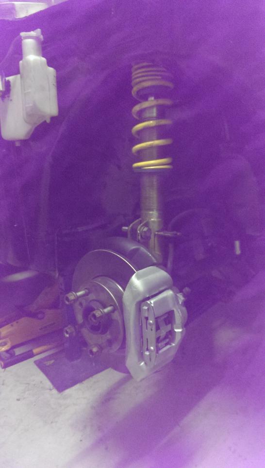

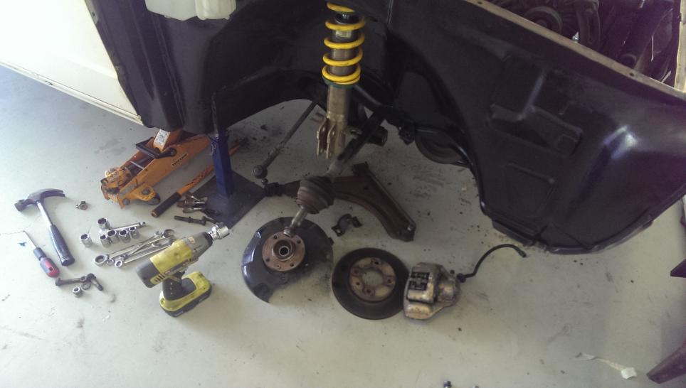

              Suspension and brake makeover. Cleaned up control arms, hubs and calipers. Everything got a good paint, these calipers were off my 4 door that had new pads and new discs. All the bushings looked pretty good and cv boots look newish. I need a new a new drivers side tie rod end or boot and both steering rack boots. Coilovers are also in and its sitting relatively nice, alot more playing around with heights once all wheels are back on the ground. For some reason these wheels have grown on me, just need smaller tires. Anyone selling or know a local place that has braided/stainless brake lines? mine are almost fallen to bits.
              Sorry about phone pics, i have no idea why it goes purple in the dark. Friend took my dslr to WTAC.

                Looks the goods! Let us know how you find the mk3 booster with standard brakes. I've just switched mine and it feels way wayyyy different. Almost like you're not pushing the peddle at all. What size are the wheel and tyre combo?

                  Why different in a good way? The the rims are 14x6 on 185/60 unsure of offset, would be pretty high though.

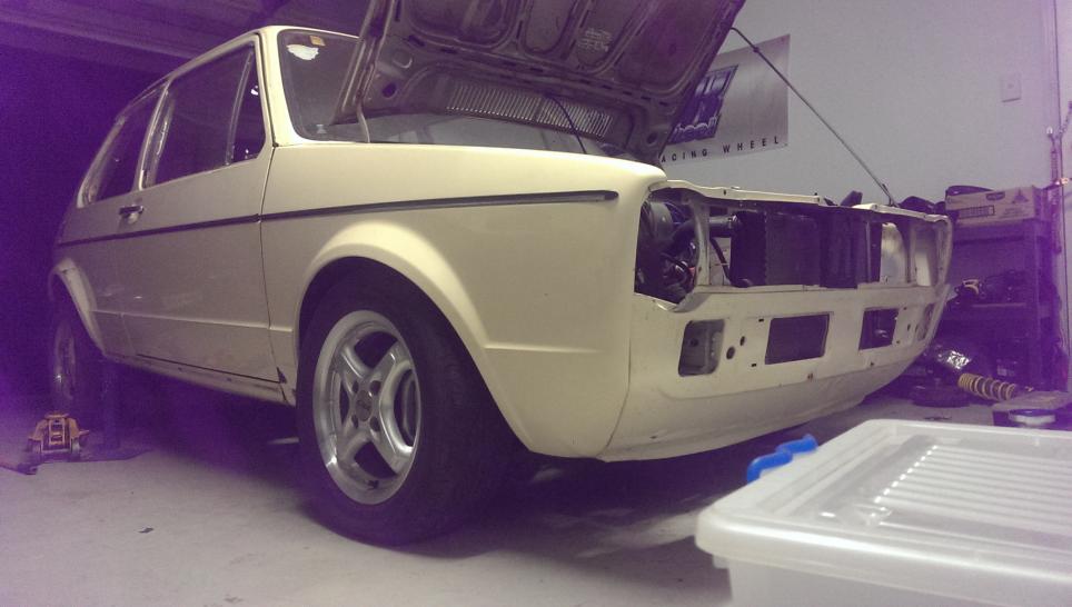

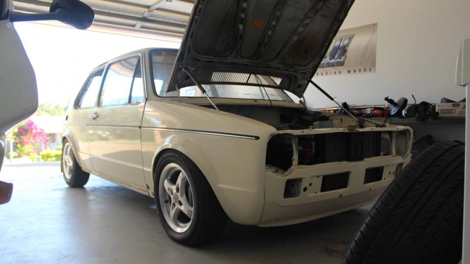

                    • Better picture of how it sits now, rear drums where replaced along with shoes and wheel cylinders/bearings. This is almost as low as the coilovers will go, another 15mm or so. New rims (smaller tires) are definitely still on the list too! Also put on bonnet struts on. It actually sits alot lower than the picture looks, bonnet is almost at knee height. Im pretty happy how it sits but new wheels will decide to more or less. Hopefully less its still way above the legal limit haha

                      • Coming along nicely!
                        77 Mk1 GLS 2 door - That sinking feeling
                        76 Mk1 Swallowtail 2 door - Replace that BMW & 76 Sweetheart
                        • Looking good
