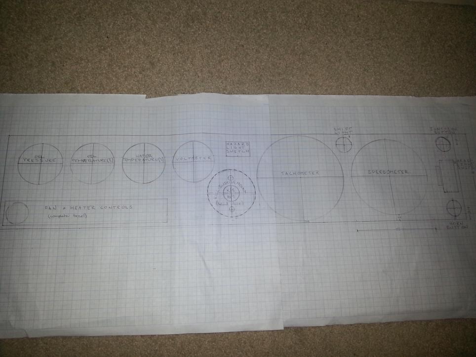

      Got this done today, it's a new template (W.I.P.) for my new dash with all new gauges, didn't finish the dimensioning but I won't until I find someone to make it up for me.
        Nice man! Ive got a similar idea cooking up for both of mine.
        Looks the goods!
        Are you making it from carbon?

          Liking the idea of that new dash!
          I'm Also contemplating of customizing my dash out of fiberglass after I get my car on the road!
          Hopefully everything works out! Good luck

            Cheers guys! I actually have a very mint mk2 dash to put into the car when my fibreglass interior rocks up - so this is just to replace the stock bezel. After talking to a mate today who is the walking bible of metalworks and whatnot - i've decided on stainless with a nice finish. should look pretty good!! I'm too much of a pussy to play with fibreglass, especially when the smallest edge is only 2.5mm (from tacho to bezel) so i'm gonna leave it to the experts and see how it turns out! hopefully will look as i've planned it out on paper
            Then.... rewiring but at least after that's done i'll be able to thrash the living daylights out of that poor 1.6 until i decide what i'm gonna do in the future haha.

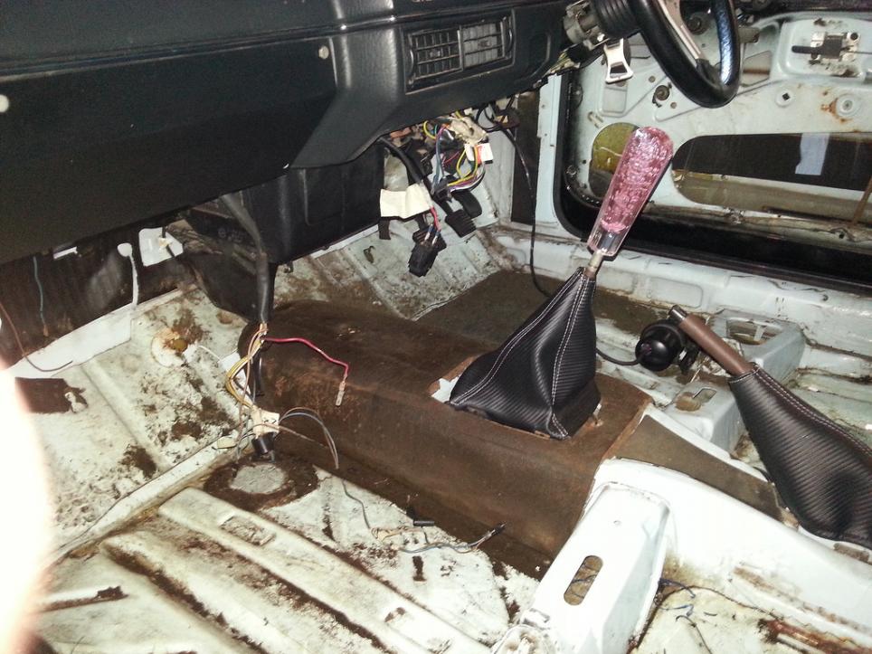

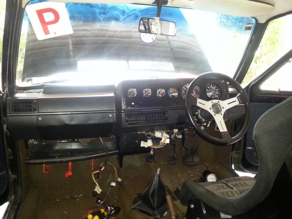

                  Test fitted my new dash - I dummied it up with the faceplate which came with it, but I'm still working on finishing up my design so I can get it made up.

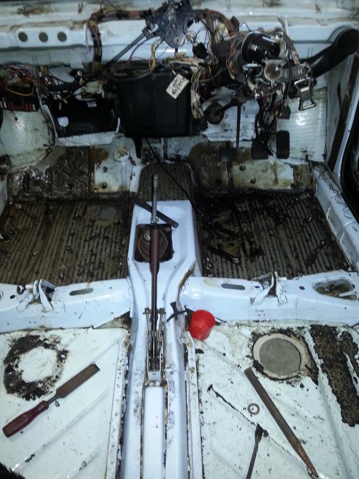

                  Then stripped out all the interior which will be staying out - planning on cleaning the stuff off the floor and painting it all black and running no carpet. Any tips on what to use to get all the crud off??
                  Excuse the dildo shifter it's all I have to suit my gear stick as somebody chopped off the thread at one point in it's life

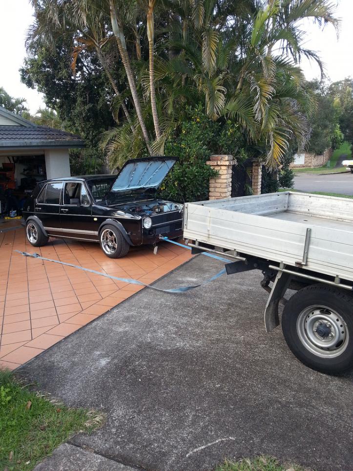

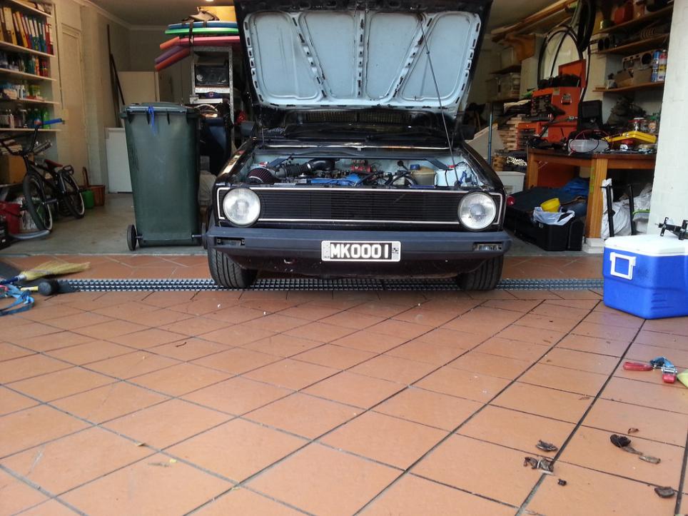

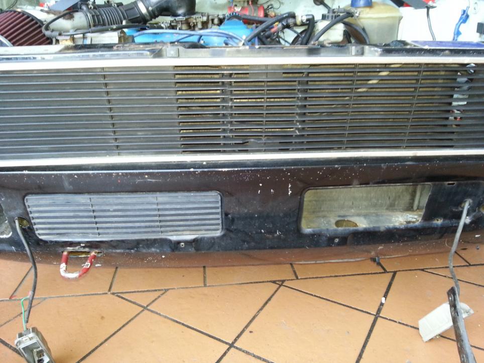

                  Then I took the front end apart to fix my bent tow point at the front, then tested it when I had to sweep the garage out as I couldn't drive the car haha
                  Chasing the other grill for the front if anyone knows of one?? I've heard they're pretty rare but you never know!
                  Annnddd all back together

                    • Dry ice or a heat gun is your friend to remove sound deadner.
                      Then use carby cleaner to remove all the glue.
                      • I'm actually thinking of putting a dildo gearknob in mine, as the shifter with standard knob seems ridiculously short (not used to working with short shifters and knobs, pun intended).

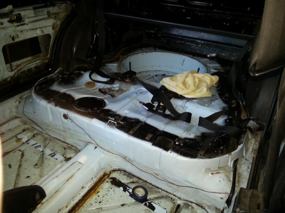

                        • Today's progress - hopefully will have the floor sorted this weekend, have to do a bit of welding as the floor plan support has been crushed and rusted out from people not knowing how to jack the car up and using the sill
                          Sound deadener is an absolute %*&#(

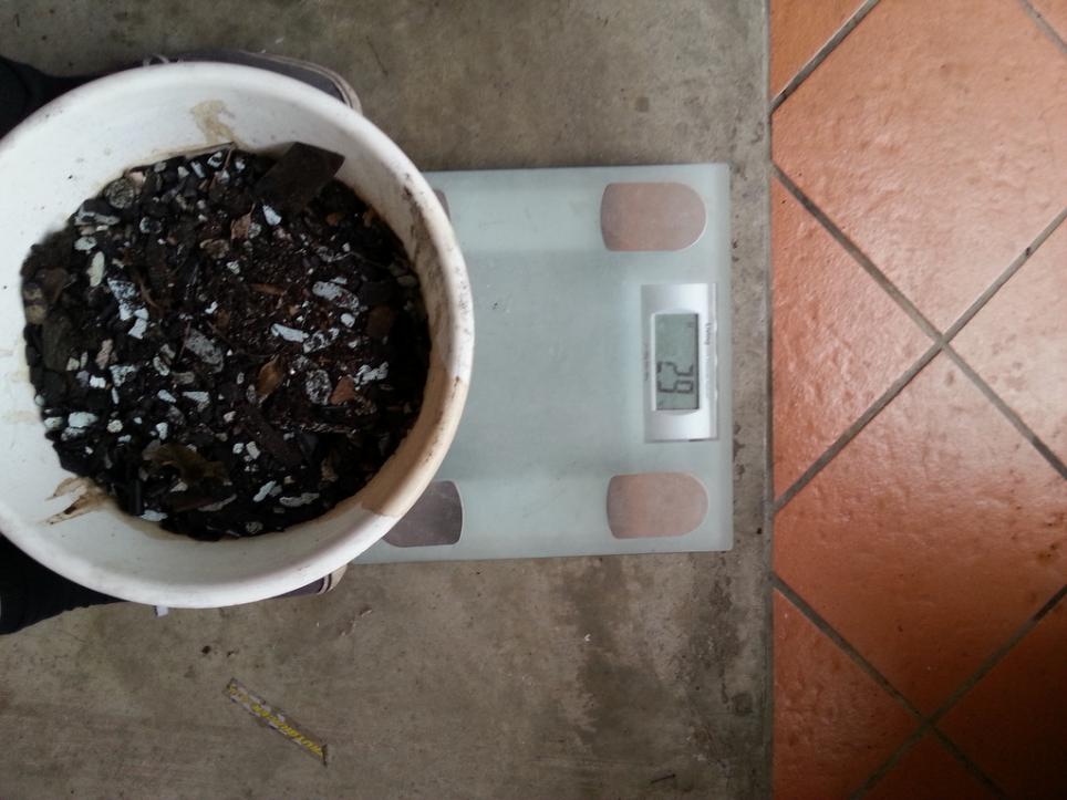

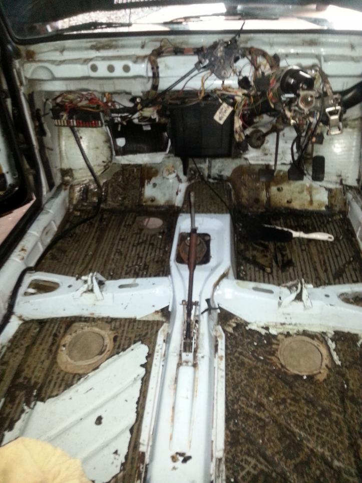

                          • Bit more progress today!

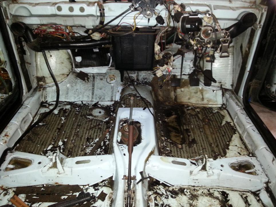

                            just under 3kg removed so far.. only about halfway through!!
                            gonna have to re-plate the big holes in the floor pan, guessing they were drain holes when the deadener was laid?? also gonna have to re-weld the seams from floor to sill, the sealant holding it together before has turned to goop over the past 33 years.
                            hopefully will get that done this weekend and paint next week!!
                            • With welding happening this weekend(!) i'm hoping to start grinding tomorrow and cleaning up all the gunk back to bare metal!!
                              • Oh so close!
                                just the last bit behind the pedals left, then it's scrub time to get all of the glue out! I think it's really bad on the drivers side under the seat because it used to fill up with water there. same as behind the pedals.
