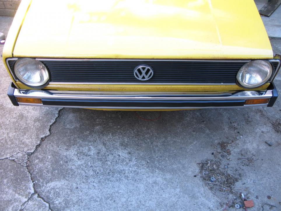

well a few things have been happening since i last posted so i thought i should update my thread, probably haven't does as much as i could have since uni finished and the going out/work took over...
but progress of late includes:
- roof lining completed
- all glass/windows in
- doors on (may need some adjustment)
- all electricals working
- and just a heap of loose ends tidying up
well we didn't meet the christmas deadline so now my new deadline is my birthday in the middle of jan, fingers crossed it's donee
