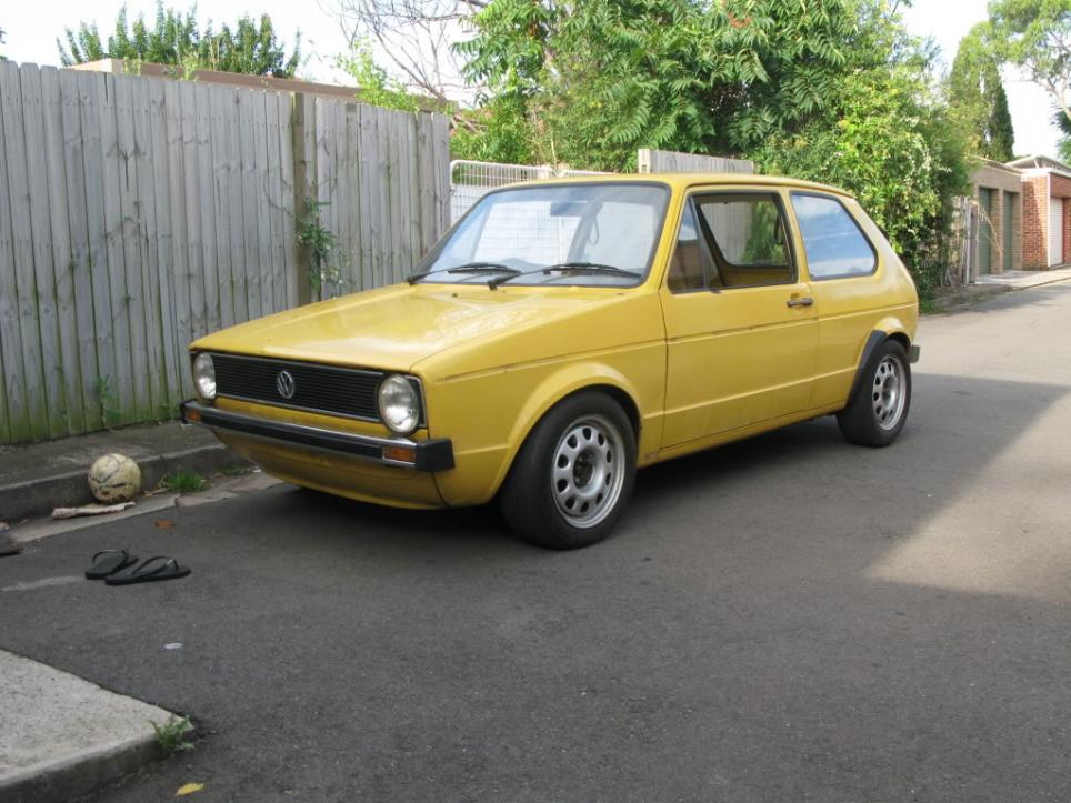

  • finally some photos of the brawler ahah

    • Going to give the paint a full buff, polish and wax?
      Good to see it all together, it's probably more 'together' than most MK1's going around.
      Get my PM?
      • With a good polish that will come up awsome!
        • Originally posted by Jace View Post
          Get my PM?
          yeah haven't touched the paint, but i did polish one door and it came up mint so going to give the whole car a once over once finished as you said...but for me personally...if it goes quick, stops fast and turns in well i'm a happy man...the paint cant wait until i have more casshh

          • can't wait to put a lip or duckbill on the front either!
            • Yeah I'm the same, my car looks like it's on the way to the scrap yard, but sounds fast and i drive it like i stole it and the thing loves it.
              I like that you've made a good all rounder.

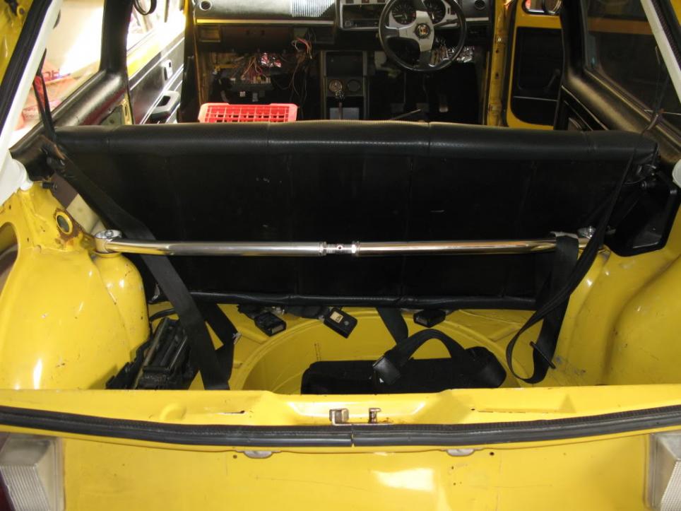

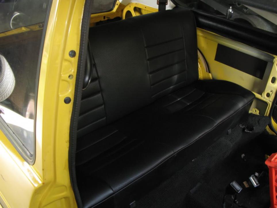

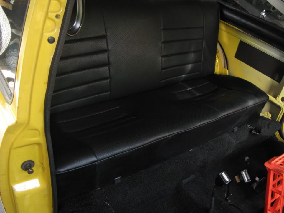

                        • finally sorted my back seat which is now 90% in the car...bought the actual seat for $10 of melbourne gumtree and then about $60 to get it here so ended up working out well...had to make some adjustments to the base as it was a 4-door seat and mine in a 2-door base which are different, but happy with the way it turned out! (if anybody as the surclips or any of the mounting hardware required for the rear seat i need it asap!, thanks)

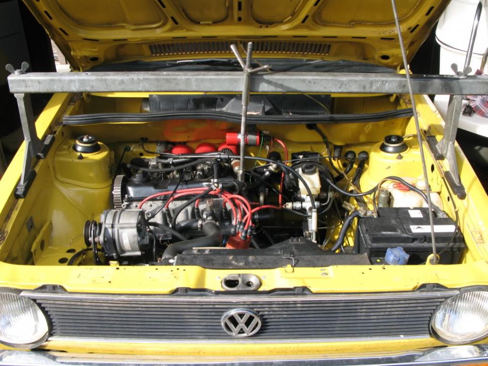

                          so this was a bit of a pain/setback, the new mounts i put in were to soft, i had to take them all out again and i changed the drivers side to a diesel mount with the german quality rubber (not the sh*t aftermarket stuff i wasted my time with) and a neuspeed poly insert mount...the front mount was also changed to a super pro poly mount and the passengers side a good quality rubber mount...so hopefully no more engine rock! and no more carby stack flying off!!! lol

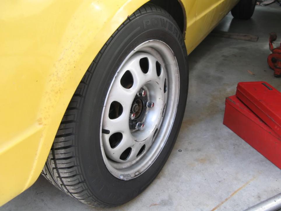

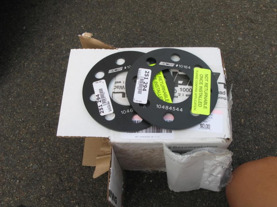

                          5mm ecs tunning spacers with lengthed wheel bolts and new tyres, keeping it all safe and secure lol
