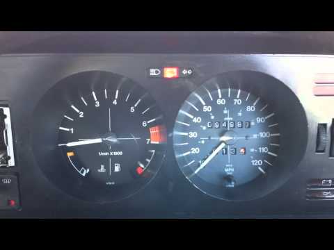

My GTI has now gone to Mick's place for some love and attention. It has a warm start issue that needs rectifying (ie. if the car is warm and has sat for 10-15 minutes it won't start for another 45 minutes or so).

Although the symptoms listed in that thread are different to what my car suffers (see video below for my car).
From the thread above: "Symptom: You turn the key and nothing happens. Nothing. Not even a click. The voltmeter does however show you sucking major current."
Video of my car's symptoms:

Liam, if your car has only run for a few minutes, switched of then attempted to be re started in 30 mins, I would think you dont have enough heat in the engine bay to cause the heat soak the hot start pulse fix is designed for. Does the fuel pump operate when you try the re start ?? I think its definately fuel related as when it catches its a bit missy.. I can see on the video In all cases when you crank the tacho gives that little bounce, I guess thats confirming there is an electrical pulse coming from the coil.
