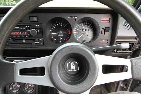

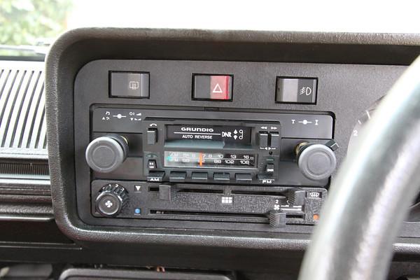

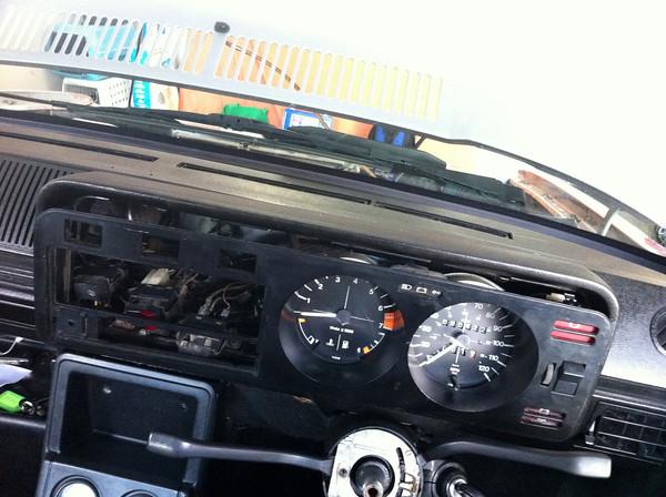

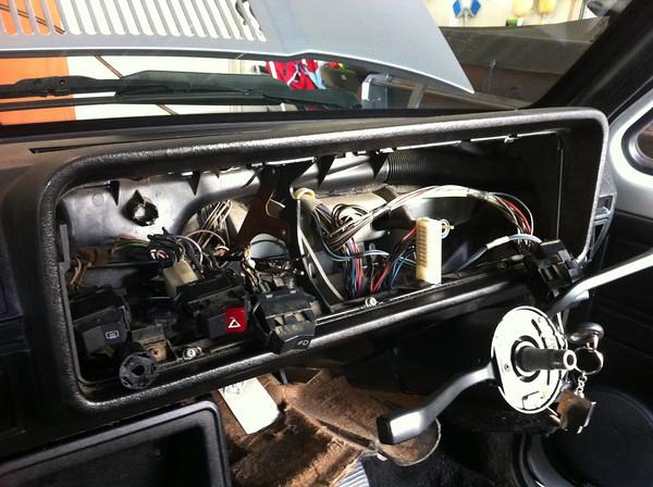

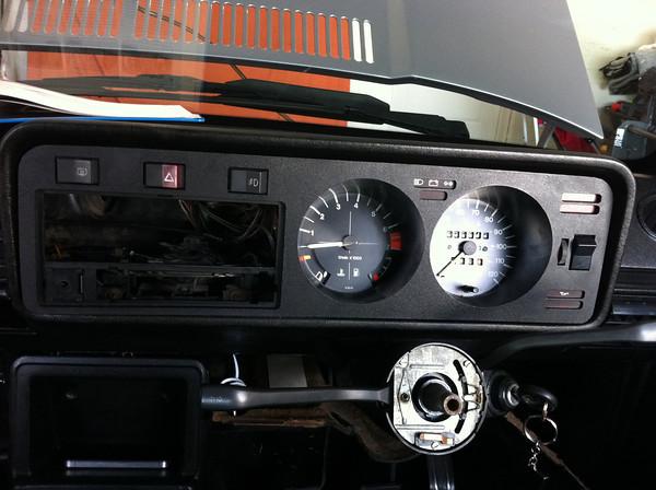

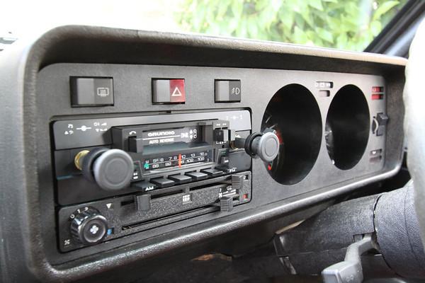

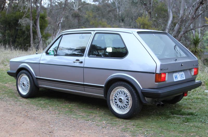

        • New instrument cluster/surround and radio are now installed...
          ...thanks to Mick for his assistance.
          MY10 S3 3dr
          • looks perfect!

                              • Originally posted by mikinoz View Post
                                Worth the small investment I think...
                                VW Rabbit Hatch Stripe Kit Black | eBay
                                Yes, good call. I've been holding off on that in case I decide to do a full body respray in the proper Diamond Silver colour.
                                MY10 S3 3dr
