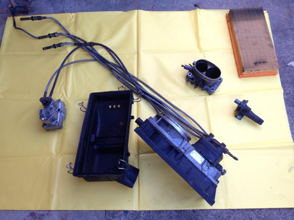

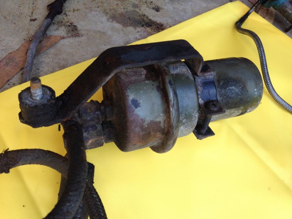

So my further research and course of action are;
- replace check valve (cheap)
- tested WUR and it's outside spec 16-22 ohm at 24.2 so that may be the source of overfuelling under hard acceleration
- will test injectors for spray pattern and leaking
That will all have to go some way to sorting things!
Taken me a bit longer than I would have liked to get this far but have an update.
Since the last post it's confirmed the system is losing pressure rapidly. Accumulator or check valve at pump. The WUR is delivering 3 BAR not the 3.5 it says it needs. Bit of water looks to have gone through system at some stage also.
I've removed the complete injection system and sending it to Peter Bower from Bower Power who will overhaul what he can and replace what's needed. Peter is a true gentleman and as I showed some interest he talked me through a lot while I was with him and really broke down how kjet works. After that conversation I really understand simplicity of this system and see why if maintained is tops.

I was wondering how you were going with this Mik, good to see your still at it.Originally posted by mikinoz View PostThe WUR is delivering 3 BAR not the 3.5 it says it needs.
K-jet is amazingly reliable as long as its maintained, to many people bag it IMO without fully understanding it.
WUR is incorrect version for a 1600 GTI spec, maybe where the issue is, Peter should be able to recalibrate it for what your needing tho.Lots of MK 1 Scirocco's...
