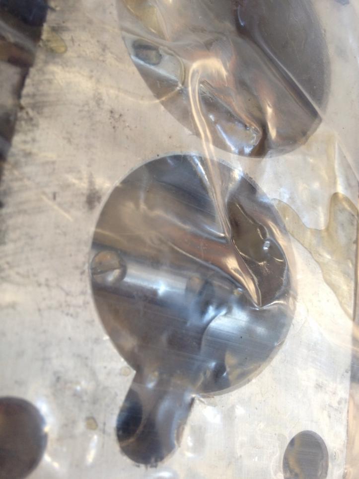

        HOT water and a scoop of clothes washing powder in a bucket... Mix it up, throw your aluminium parts in. Leave for 5mins or so.. Come back and scrub away.. They'll come up brand new.
        • Should probably do this to the intake manifold as it is in a similar condition. But that is cast? Is it cast steel or alloy? Can you see any issue? Just need to buy a new gasket if I do...

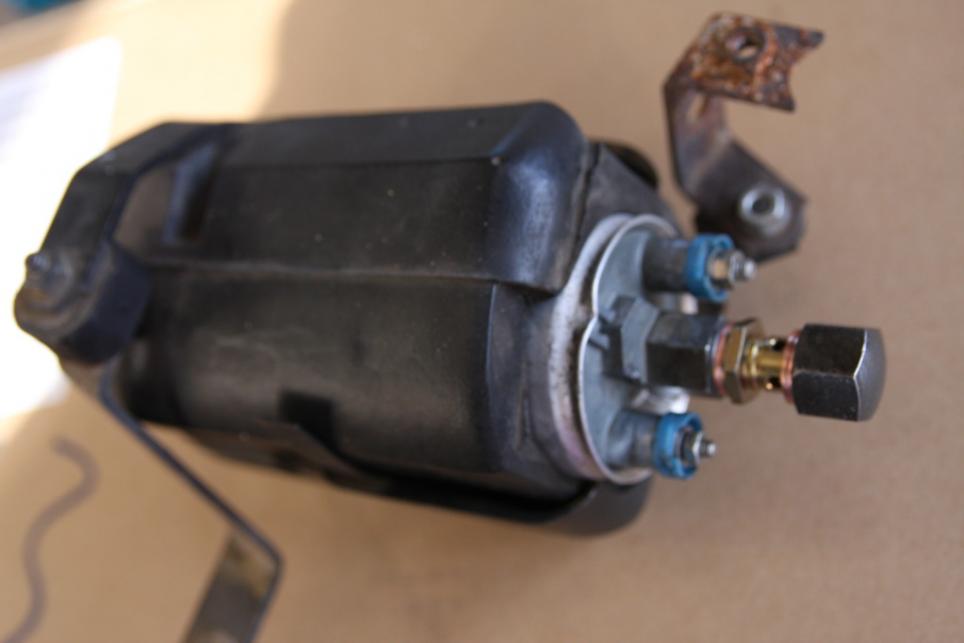

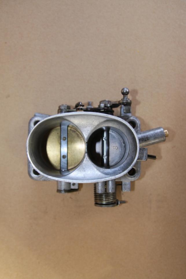

          • So the time to get some decent shots of this gear before it is bolted back on I thought was deserved.
            The fuel system must have been going fine originally, but over time looks like the corrosion has taken a firm grip on what to some suspicion looks to be an original accumulator and fuel lines.
            The replacement specified is a Porsche/Volvo unit (the barb is for venting back into the fuel system in an emissions control environment) - fits nifty in the bracket.
            The pump has been tested and is operating as new. The return check valve however was not closing and this is the most likely cause of the hard start cases that have been seen. New check valve fitted.

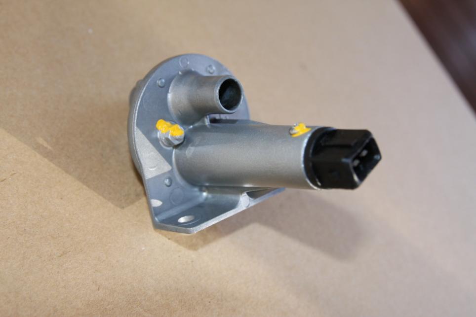

            Idle Air Bypass was not looking like this before. Cleaned and re-calibrated.

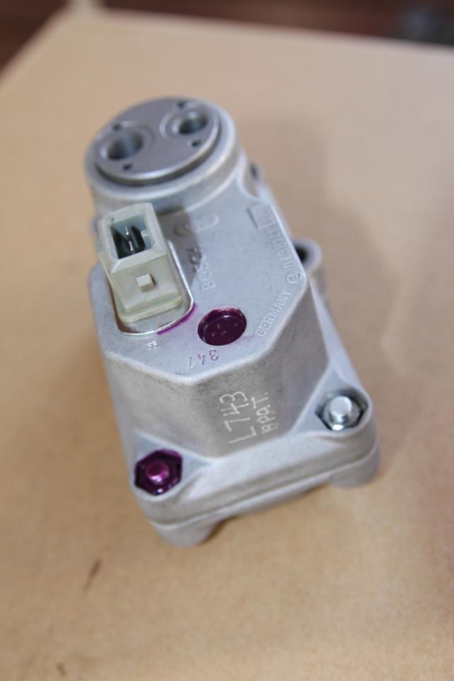

            The WUR that was fitted was not for Golf and was actually a vacuum model (from Turbo cars) and hence was not delivering the correct pressure (3 as opposed to 3.5 BAR) which in turn was not assisting in the AF ratio - this is a rebuilt unit with the correct resistor etc and hopefully this will bring the over fuelling in check.

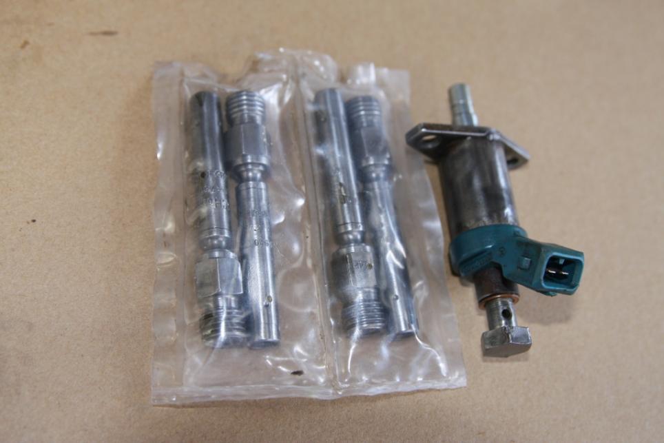

            All of the injectors were gunged up and not spraying correctly. They cleaned up alright and a lot cheaper than buying new (best is they are still steel as opposed to the new ones that are brass)

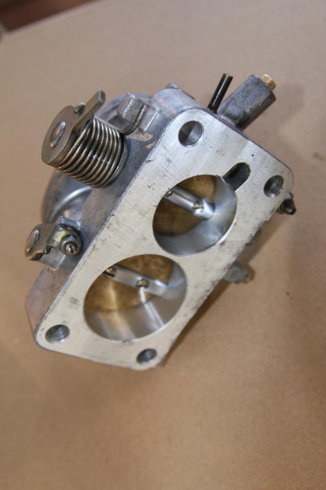

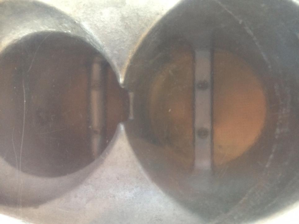

            And the throttle. It was so gooped up and poorly adjusted the butterflies were not closing correctly, which is why the idle forever was inconsistent. That should be golden now.
              Do it for sure. It's cast aluminium.. As long as you clean it thoroughly afterwards it will be fine. We clean go kart engine parts this way. (The head, cylinder, crank case and carburettor).
              Use a scrubbing brush and tooth brush.
              DON'T use dish washer powder. It'll send the surface black, as it contains too much caustic.
              Oh, and I think I have a gasket here. All yours if I do.
